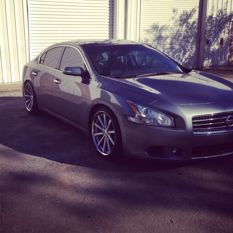

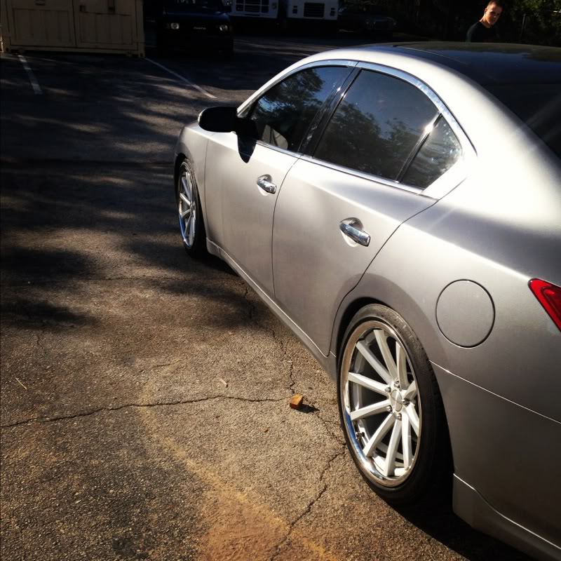

No wheels Spacers used here.

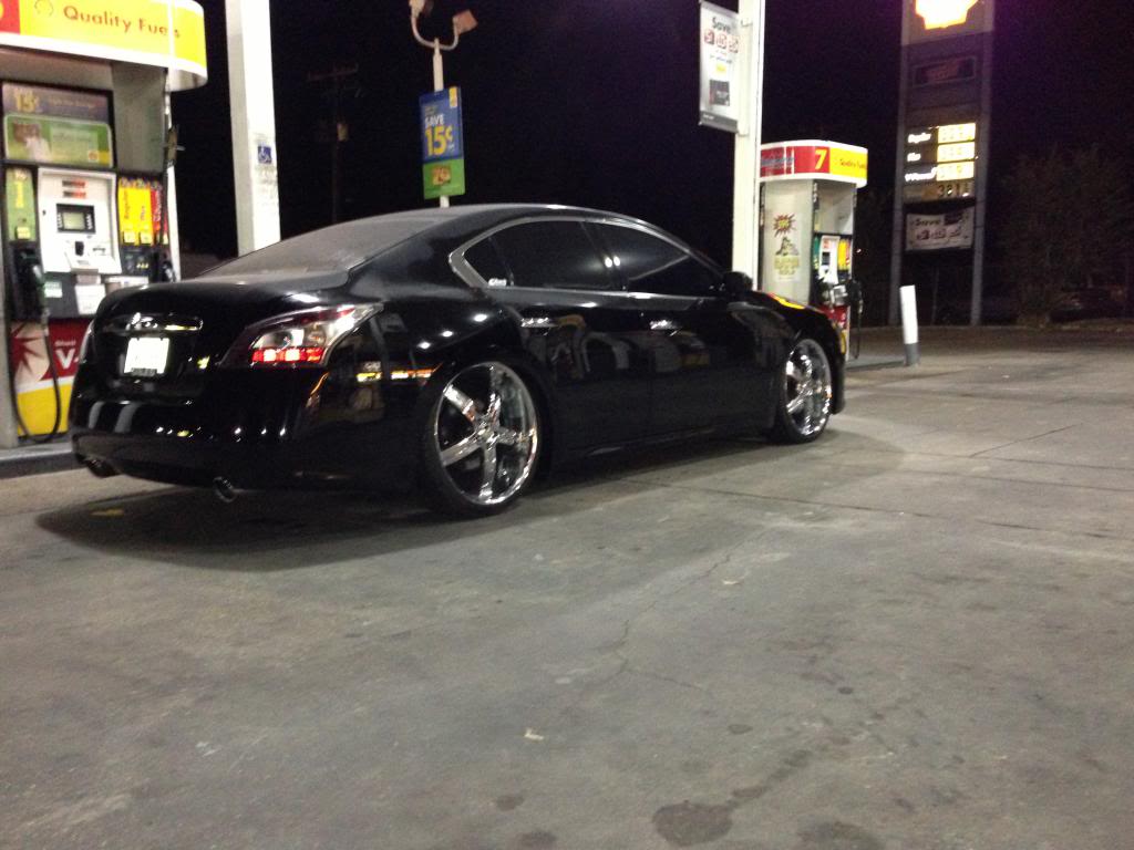

Ok to clear things up, I am currently running a staggered fitment on my car 20x8.5 ET38 Up Front and 20x10 ET45 In the Rear.
Before I even ordered my wheels I had a gut feeling that 20x10 would clear on all four corners with no problems at all. But when I started asking people, EVERYONE told me that it would not clear correctly. So I decided to just go with my current setup now.
But One day I told myself that Im gonna try my 20x10's up front just to see what happens, and sure enough they fit perfectly no rubbing, sticking out NOTHING perfectly flushed with fenders. So having that said, My advice to all you who want to run wide on all four corners, go with 20x10 ET45 to achieve that perfect concave look that would compliment the 7th Gen's Sexy curves and still be able to rotate tires.
I have no side pictures because again I was just experimenting with my own rear wheels. But alot of you out there want to know what "MAX" sizes can be used on our cars without having to sacrifice ride quality and stretching of the tires, so this is just another helpful tip for all of you.
My plan now is to sell my two Front wheels so I can get another set of 20x10 to replace them with.
Anyone interested hit me up, thanks!

Did you still have on the 275/35/20 tires?Originally Posted by SilverBullet23

thats sick silver... what size tires were on it because when i finally get rims i want 20x10s all around was doing research on em
20x10 with a high offset all around is a lot of excess weight that is not needed, u can cut about 3-4 lbs by going with a more narrow width and lowering the offset to get same results.
by going with a 10J width, your forced to raise the offset and your stuck with getting wide 275mm width tires as well, this also adds more weight. Also, a 275 35 20, 275 30 20 or even a 255 35 20 is a uncommon size and more expensive than the more popular sizes.
Excess weight or Not This Is A Sedan Not A Sports car, So Like I stated before A little sacrifice for a good looking stance and More Stability never hurt anyone.
This is more of an Idea that I passed on to THOSE who dont try and race this car against others and are more in it for the looks of the car not the performance of it.

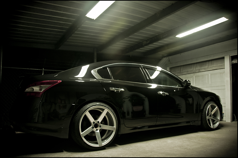

Not mine but I though I'd post since these look pretty good. Wheels are MRR HR9.

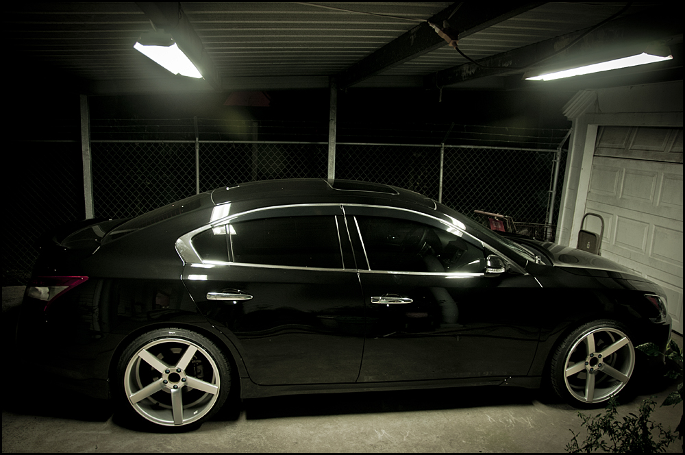

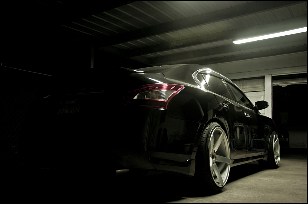

Just remembered I had some pics of the other guys on Vossens with the 10.5 up front. Of course they all said that it is not practical for a DD, but I am sure the 10 will be just fine.

Anyone know the offset he's running on those wheels?Originally Posted by WrightOne86
Quote:
so 10.5 all around with stock height wont need no fender roll?Originally Posted by 20_Maxima_10
10.5 all the way around I'm pretty sure.
Quote:
I doubt it, I don't see it having that much travel to worry about the fendersOriginally Posted by Kmoney
Quote:
thanks....Originally Posted by 20_Maxima_10

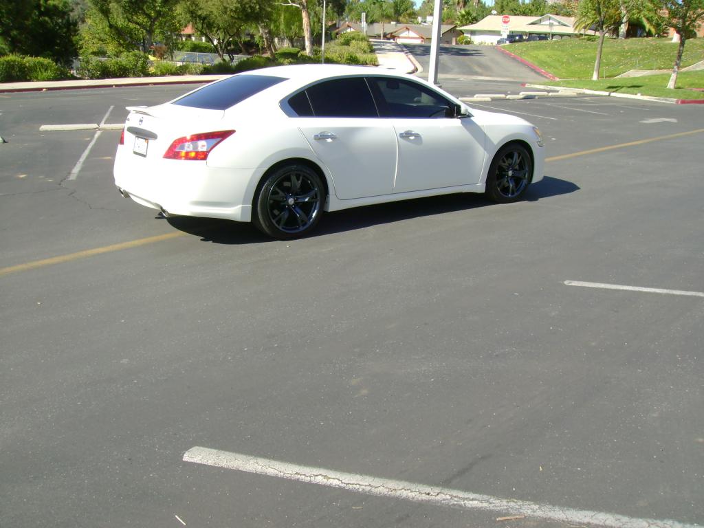

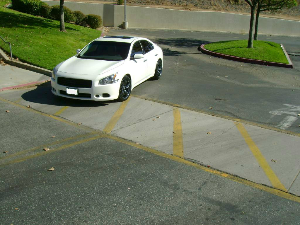

Installed eibach springs and 370z rays this weekend. Its only been a day so I am hoping the springs settle in a bit more. We shall see.
