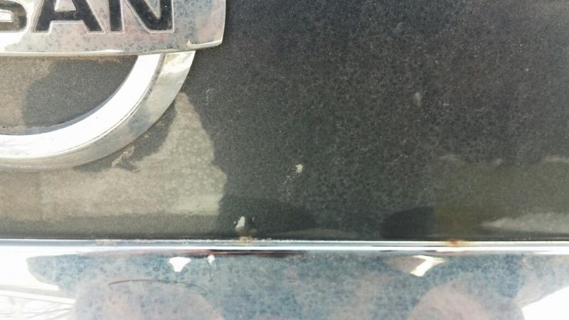

Old Feb 23, 2014 | 10:32 PM
  #58
Maxfly's Avatar
Joined: Aug 2013
So I was finally able to wash the car yesterday and found 2 spots where the paint is bubbling from underneath that plastic chrome piece on the trunk lid. Unbelievable how crappy the paint quality is on these cars. Anyone have any luck with the dealer getting this fixed? The car is only 6 months old with 7k miles.
Old Feb 24, 2014 | 12:39 AM
  #59
zoemayne's Avatar
Joined: Mar 2009
Posts: 770
From: Miami, FL
FYI someone already explained that this was happening due to that emblem expanding and contracting from the suns heat. So the emblem would need to be reinstalled with screws which are not as tight. From my understanding the screws are too tight. I have a thin line of rust a few inches long going above the emblem. The G37/5's are also experiencing tthis issue. If Nissan is not covering them they wont cover us.

I noticed this exact spot of rust on the 2013 SV that I will be picking up on March 01, 2014. FWIW, the car was built 12/2012. If the dealer doesn't fix it before I pick up it will be a sticking point !
Also, rear hatch areas are prone to rust due to the negative air pressure in these zones. The air flow causes all debris from the road to pick up and blast the back surface. The more vertical the sheet metal section at the rear, the worse it will fair in this 'sand blasting' problem.
Why Nissan doesn't modify the paint spray robot programming to apply a thicker layer of paint in this area is beyond me !!

Old Mar 5, 2014 | 11:38 AM
  #76
vball_max's Avatar
Joined: Jul 2007
Posts: 1,799
From: North Shore, MA
The area I am talking about is not the nissan emblem, but the long chrome "handle" piece on the trunk. Its been almost a year now (10-11 months) since I had it fixed and i haven't noticed any rust since.
I just called my dealer who processed the claim to see if they have a warranty item number or some other reference for the fix, and they didn't have it listed on my file (which I find kind of odd). He said he would look into it and call me back if he found anything I could direct you guys too. I'm not too optimistic that they will call me back though.
Old Mar 5, 2014 | 02:32 PM
  #77
2012maximaS's Avatar
Joined: Apr 2013
Posts: 102
I also have some rust on my 2012 S in that same area. I'm going to take it to the dealership tomorrow and will try get them to fix it. Do they repaint the entire trunk or do they just fix up that portion of the trunk?. I installed an aftermarket spoiler and i hope they don't remove it during the repaint because its perfect as it is right now and i don't want them messing with it.
Old Mar 5, 2014 | 03:09 PM
  #78
vball_max's Avatar
Joined: Jul 2007
Posts: 1,799
I'm not sure how much of the trunk they paint. I don't believe they removed my spoiler when they did it.

Old Mar 6, 2014 | 02:25 PM
  #80
Joined: Apr 2013
Posts: 102
Just an update: Talked to the dealership and they gave me no problems. They are going to send it to the bodyshop to get the trunk repainted and will fix the chrome piece so that it doesn't scuff the paint. They will also provide a free rental car.
