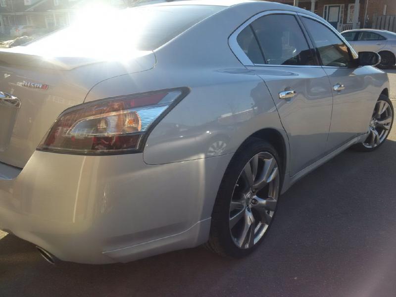

i had the same problem, small rust spot just above the chrome, had a shop repair it as the dealer would not touch it. once fixed i installed 3 small plastic washers between the chrome plate and the car, this created a small gap. hopefully this trick will eliminate the rubbing which created the rust. another option is to remove the existing small foam trim behind the chrome piece and add a thicker one to create more of gap.
Attached Thumbnails rust on trunk-img_20140331_091816.jpg   rust on trunk-img_20140331_091747.jpg
