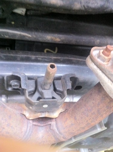

alright problem solved, the two parts where arrows are pointing are rubbing together causing said squeak, just cut a small piece of the circled area and thats it
http://www.flickr.com/photos/39224916@N08/6187215485/
http://www.flickr.com/photos/39224916@N08/6187737152/
http://www.flickr.com/photos/39224916@N08/6187737884/

Old thread --- I want to point out that the piece to cut is part of the rear exhaust hanger and not at the front by the Y pipe. I had the same issue after installing RL Y pipe.
