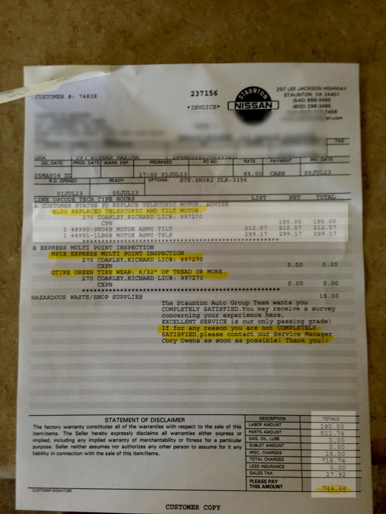

I got mine finally fixed today. $744 for anyone's FYI. If there is ever a Class-Action lawsuit on this issue, count me it.
I an provide part numbers, if anyone wants them.

FYI for others.
