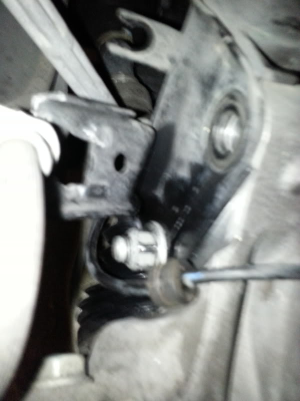

I need some help! Just to confirm . The 2 bolts that are attached to the wheel bottom of the front sturt! I can't get those off which side are you supposed to remove...this is the part I'm supposed to hold one side so it doesn't turn on me
Old Aug 3, 2013 | 03:03 PM
  #69

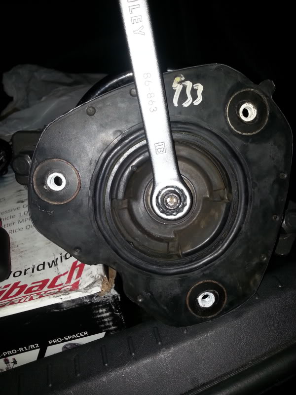

7 hours later with an impact gun I cant get this bolt off! Wtf and its not stripped...
****ty pic but I need help anyone?
Old Aug 4, 2013 | 07:06 AM
  #71
MaximaDrvr's Avatar
Joined: Nov 2012
Posts: 1,269
From: Charlotte, NC
It isn't likely, but it could have been cross threaded from the factory.
Spray it with penetrating oil or PB Blaster and let it sit for 20 minutes.
You can also use a torch to heat the nut which can help.
Old Aug 4, 2013 | 07:37 AM
  #72
GNCMaxima's Avatar
Joined: May 2012
Posts: 441
From: Dallas
Thank you. Fortunately I got those two bolts off. I've been up all night trying to get this allen wrench in while I use a wrench to hold it.
This project has went from 2 hours to 18 hours..I hate having my pride but dammit I just cant pay 400 for this install lol
Damn you allen wrench! !

Can anyone save me?
Inside the nut is stripped and I can't find anything to put in there

Originally Posted by GNCMaxima
Can anyone save me?
You stripped the inside where you put the allen wrench???
Damn, yo =( That's important. You don't want to be rotating that inner shaft.
Take it to a shop see if they can torch the bolt and remove for you. If you can't do that, you're going to have to bite the bullet and maybe get some vice grips to hold the outside of that shaft bolt (whatever it's called?) to hold it in place while you try and wrench out that nut. Gonna screw up the threads... >.<
Make sure all the tension is off that head piece as well if not already. Oh, and grab a cool beer. Keep cool when doing this stuff. It's frustrating enough as it is. Good luck mang =/

On second thought, don't use vice grips. =/ Just take it to the shop.
Yeah I heard it can mess things up lol Its Sunday and everywhere is closed. Im SOL! I didnt even think I stripped it because the other strut was so easy.....Any other ideas??
I Immediately Regret this decision...

I don't see a spring compressor I that pic. You do have the spring compressed, correct?
Old Aug 4, 2013 | 07:19 PM
  #78
dr_2010SV's Avatar
Joined: Oct 2010
Posts: 1,326
From: WA
My thoughts are.....a stripped allen in the strut rod will most likely require a trip to Nissan for new strut.
The spring compressor will only assist in getting the old strut rod cut to remove the top mount.
Do take this to a shop to have that part performed...please.

The fronts are done!
Just have the back springs left and from what ive read so far its a breeze

Good to hear....how did you get past the stripped allen in the strut rod?
