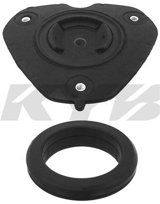

There is a rotating spacer on the top, if that has friction it could cause a problem. I cleaned mine out so it spun freely but it was a bit stiff prior. I also made sure the bottom of the spring was sitting exactly in the cup.
If there are sounds when turning it is a install issue. I have installed springs on all 4 of my prior Maximas and can tell you I had that issue once and it was because the lower part of the spring was not sitting in the cup correctly. The upper rotating spacer needs to be free from friction and spin correctly prior to install as well.

This is the strut bearing:
It needs to spin freely to prevent your springs from rotating as you turn the wheel. It sits right below the upper hat:
Then be sure the lower part of the spring is properly sitting on the lower "cup".

The springs will only rotate if the car is unloaded (on a jack). When the car is sitting on the springs they are compressed and should not move. This is the whole reason for the bearing at the top, to prevent any movement when turning. I do not have any noises on mine so you should not on yours.
Is it on both fronts or just one?
