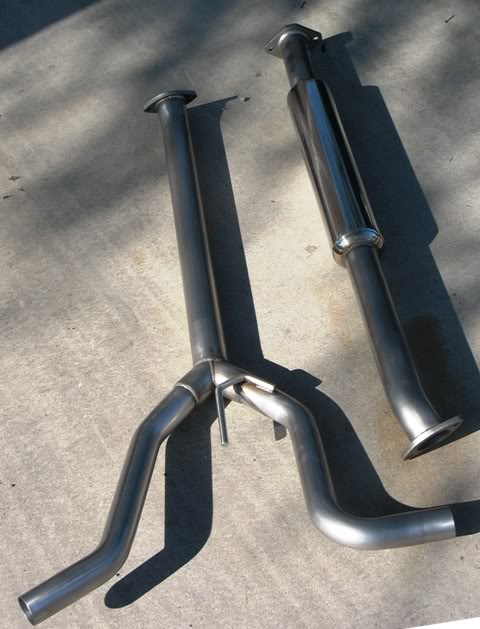

if you want down pipes this is your best bet go to cattman performance and call brian and ask him for the ALTIMA SE-R "B-pipe" its NOT EXACT fit but any muffler shop should have absolutely no issues installing it and if you want a good exhaust shop in the bronx ny area my friend CARLITO is THE BEST muffler guy ive ever been to in my life
this is his number 203-919-4637 if he doesnt pick up hes always @ the shop between 9am-7pm MONDAY-SATURDAY (CLOSED SUNDAY) the address is 1125 bronx river AVENUE bronx ny (tell him WALLY sent you)
the Altima SE-R B-pipe is a 2.5inch inlet and splits to dual 2inch pipes for your exhaust and it comes with a high flow resonator so you wont loose any low end power but only gain low/top (im doing this because i need some back pressure)
and dont tell him your putting it on the 7th gen cause he might be like "oh its not gonna work" but trust me it will with just a little bending and welding it will fit, and my friend carlito will give you the BEST PRICES trust me if your in NY area its worth the trip unless you like going to chop shop exhaust shops which is a big HIT OR MISS and you will leave with exhaust leaks.
"B-pipe features:
The Cattman Performance b-pipe for the 02-06 Altima and 04-08 Maxima (part #CBB-G6) is a high-performance exhaust part that allows the customer to choose which mufflers to install. All mufflers/rear sections (also known as axle-back exhausts) designed to properly connect to the stock b-pipe will fit the Cattman b-pipe.
This gives the customer 3 options: keep the stock mufflers for the ultimate stealth effect; use ready-to-install performance muffler/rear sections; or select a favorite universal muffler and have the rear sections custom-fabricated. The design is very similar to the b-pipe in the Mossey catback, but the Cattman version is sold without mufflers and has a large resonator that reduces volume and increases sound quality (the Mossey b-pipe has no resonator).
The Cattman b-pipe includes the following features:
- 16 gauge 439* stainless steel tubes, with two sizes for maximum performance, 2.5" going down the middle and 2.0" where it splits to the mufflers. [Using 2.5" tubing to each muffler is a design error that lowers manufacturing cost AND performance!]
- Includes our exclusive 22" all-stainless steel resonator to limit volume and enhance tone. [The soundproofing material inside is stainless steel wool, with no fiberglass, which greatly extends the lifespan and is very rare today.]
- Thick, 3/8" plate carbon steel flanges that never warp, nickel-plated to resist corrosion.
- Fabricated in the USA
* Type 439 is a ferritic stainless steel with 18-20% chromium that resists chloride stress-corrosion cracking. [T409 s/s is a lesser-grade material with a lower (12%) Chromium content.] Resistance to general and pitting corrosion is approximately equivalent to that of austenitic stainless steel
types 304 and 316. Type 439 s/s actually is more resistant to stress-corrosion cracking than T304 s/s due to its lower nickel content."
with headers, y-pipe, and b-pipe you should get some really good gains in the 30whp range (no joke) and this rear section is 40% more efficient then the OEM b-pipe
