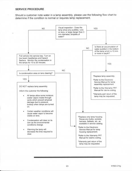

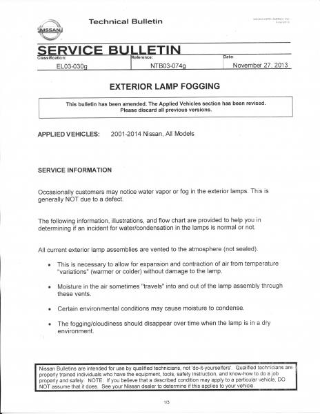

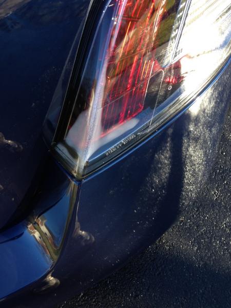

I have a new 2014 and I was reading this same thread. Here is the TSB the dealer gave me.
I see moisture in one tail light every time I wash my car. It goes away after about an hour.
Attached Thumbnails Moisture in taillight-water_in_tailight.jpg   Moisture in taillight-tsb_ntb03-074g_0001.jpg   Moisture in taillight-tsb_ntb03-074g_0002.jpg   Moisture in taillight-tsb_ntb03-074g_0003.jpg

Unfortunately your experience sounds pretty typical. The flagged thing may be a bunch of BS. I would just take it to another dealer.
The TSB seems to make sense, some fogging of the tail lamp is probably acceptable. Water droplets are not. I have noticed tail light fogging in other cars. Although in 16 years I never noticed it on my 4th Gen.
