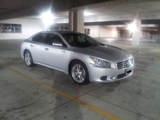

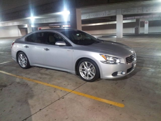

I've noticed tighter cornering, obviously less body roll turning/braking/accelerating and slightly better handling. My car is a 2010S running on stock 18s. They've been on a little over two weeks now. Here's the data I have:
Stock Measurements:
Front Right - 28.25"
Rear Right - 28.25"
Front Left - 28.25"
Rear Left - 28.37"
Day two of drop:
Front Right - 27"
Rear Right - 27.25"
Front Left - 27"
Rear Left - 27.25"
Today (SAME):
Front Right - 27"
Rear Right - 27.25"
Front Left - 27"
Rear Left - 27.25"
I'm surprised they settled so quickly (although, I did play a lot the day of and day after the swap... hehe). I'm really happy with the outcome and although have that voice in the back of my head saying "Can be moar low," I'll resist for now as I scrape every here and there on speed bumps. I am a bit worried about the stress load on the shock absorbers if anything.
====Before====
====After====

Is the S lower than the SV from the factory?
The advertised drop is 1.4'', and you only saw 1''?
I don't think so. Stock height is about the same across the board for S and SV models according to the service manual. To be fair, Eibach advertises a 1"-1.5" drop. So a 1.25" drop to the fronts, 1" to the rears? Yeah, I'm happy with that.
I'm interested to see what everyone else's final measurements were.
