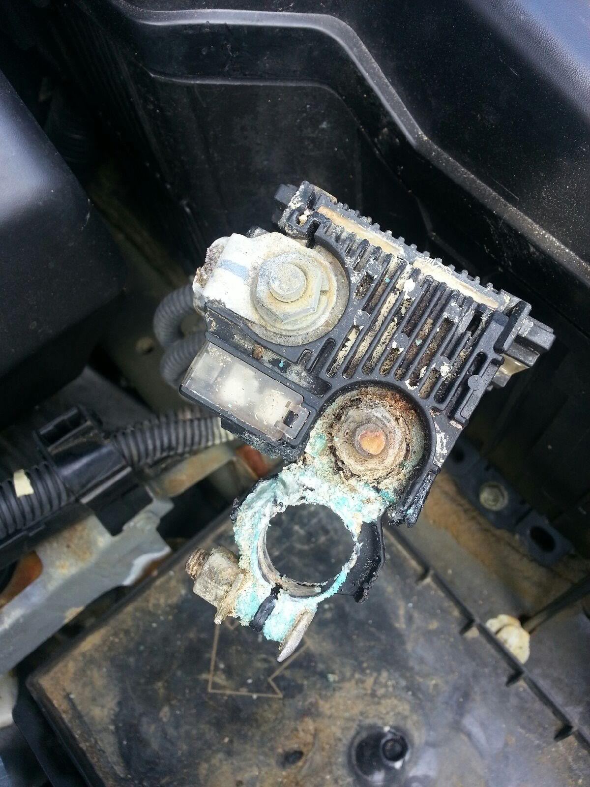

Was the battery. Would of been a lot eaiser if the piece connecting the positive cable wasn't corroded to ****. Ended up having to get a new piece from the dealer because the nut wouldn't come off.. See the pic
Old Apr 30, 2013 | 03:40 PM
Jig9798's Avatar
Joined: Nov 2012
Posts: 545
From: Mass.
Yummy!
Old Apr 30, 2013 | 03:58 PM
Lemonhawk's Avatar
Joined: Jun 2010
Posts: 184
From: Palm Harbor, FL
That's ugly! I just had the battery replaced after 24k miles on my 2010. It was not maintenance free, so I was keeping it filled, but it still was not much of a battery. The Dealer replaced it with a 2 year full replacement 4 year prorated after that battery for about $70 installed.

Old May 1, 2013 | 04:32 AM
silberma's Avatar
Joined: Aug 2012
Posts: 327
Greasing the battery terminals avoids corrosion. I do it every oil change
Old May 1, 2013 | 08:22 AM
2young2retire's Avatar
Joined: May 2009
Posts: 546
From: Hot Springs Village, AR
Red Stuff
Either grease or use the spray on terminal protector on your new battery. I still have the original battery in my '09 with 49,985 miles and the terminals still look good.
