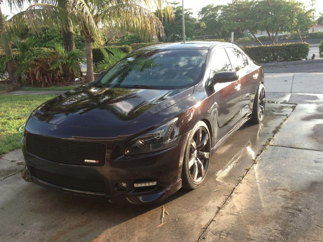

Its been done already awhile ago and yes they wheels ill poke in the rear alot better off getting al 4 front wheels from a gtr.

its not my car but thats what a GTR 20x10.5 +25 wheel looks like on a maxima,the offset sticks out alot for 10.5 you will need a 45 offset

side view of this maxima also.

Damn love those wheels just not the rear offset on the back! But 4 of the front ones would be perfect!!
