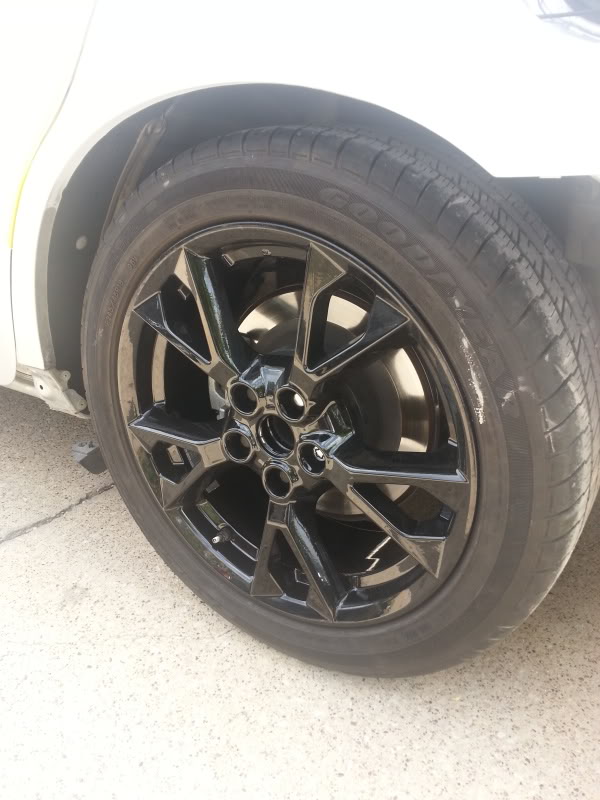

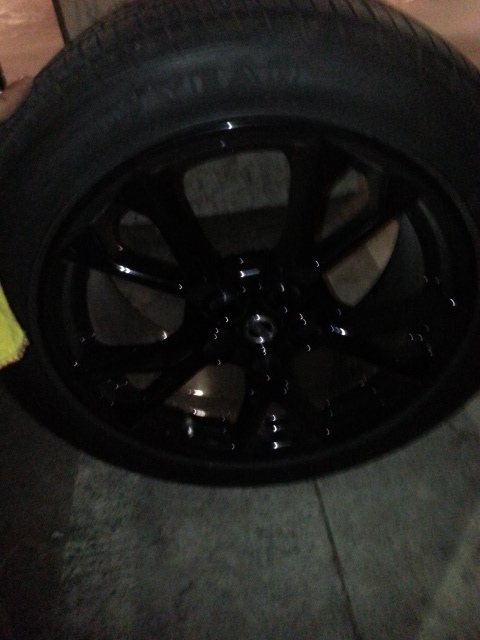

On the bright side...I got my rims powder coated

Looks like It's coming along, GNC.

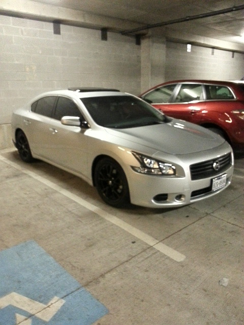

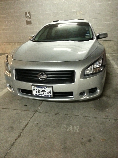

The Beast is back! Also had anyone ever try to repair our rims without having wheel balance/ alignment issues? Im having a lot of shaking over 70. I repaired 2 wheels.

Looks good, I was in a hit and run too not as severe as yours. Yeah its hard to get wheels balanced after a repair.oklahoma roads are bad worse than dallas I would say. I go to dallas all the time, what highway did it happen at?

Nice! Sounds like a good excuse for new rims? Heh.

Dallas North Tollway. They sent them off to a repair shop and look great but they suck on the highway. Btw I got 2 alignments already

Get the wheels balanced, if still an issue have the tires removed, check to make sure the rims are balanced, then put the tires back and rebalance

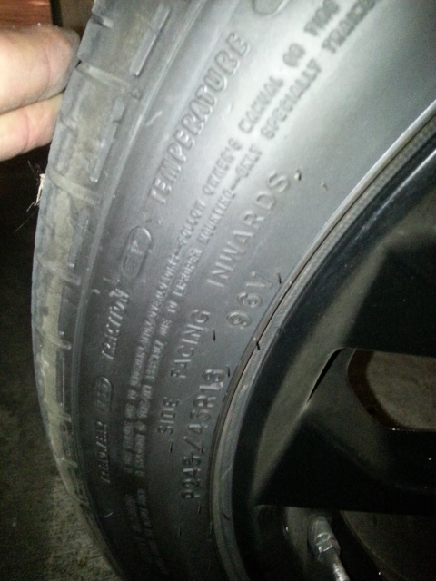

Please tell me the shop put ob my tires backwards?
Pic 1 says face tire inward
Pic 2 is the same side. Now when facing your rims the tire should say "side facing outwards" right??

Looks like it is the wrong way :S

I've had Tires Plus do that to 1 tire out of 4, 25% error rate, better than your 50%! I guess they can't read. Maybe you make them sign a statement that they have to buy a new tire if they do it wrong. Fustrating.
