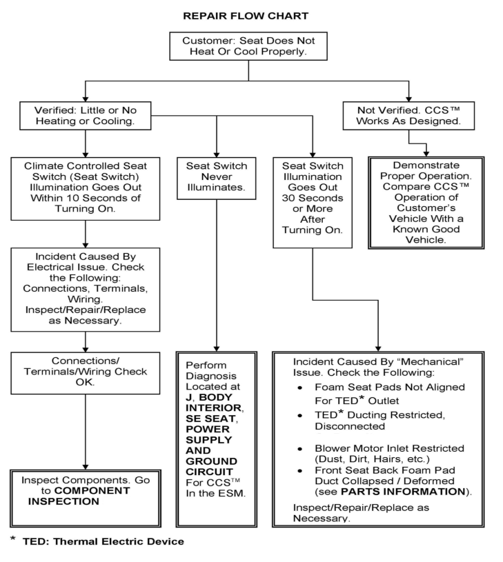

It depends on if your light is on for 10 or 30 seconds. Here is Nissan's flow chart. Where you go from here, I'm not sure. It will be a bit of diagnostic work, but the easiest thing to check is the filter under your seat. (if your light stays on for 30 sec).
There are other write ups already on it but put the seat all the way up in the air and you can barely reach the filter from the back of the seat. A slight twist counterclockwise will allow it to drop down. Then you can wash it out....or replace it with a new one. I just washed and dried mine. But I never had an issue with the light not staying on. I just did it because it was dirty.
WilSpeed - great chart. I'll look into the filter although I just cleaned it in December, but I'll check it. Thanks. At least this gives me something to talk to the dealership about so they don't give me the runaround.
