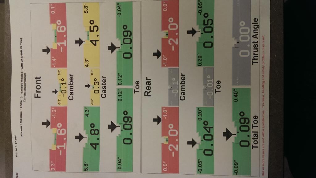

Rear camber kit installed.
Disappointed that we could only get - 2 degrees of camber without getting too much toe in. Basically the same issue I had before the kit. I'm dumbfounded. I ground out the toe adjustment holes so I can't understand why the rear didn't have more adjustment.
Even if the kit was made by someone else it would have been the same in this respect.
The toe is adjusted with the spring bucket arm. That arm is about 1/16" away from hitting the subframe so no more toe would be possible anyway.
I don't get how others are getting their rears correct.
We left it at
. 10 toe in on both sides and - 2.0 camber.

The camber isn't the issue. We could have gotten less camber but it made it toe in too far. The toe is in the green.
Does anyone have their alignment specs with a lower than Eibach drop Maxima? Wondering if anyone else has gotten their camber better than mine.

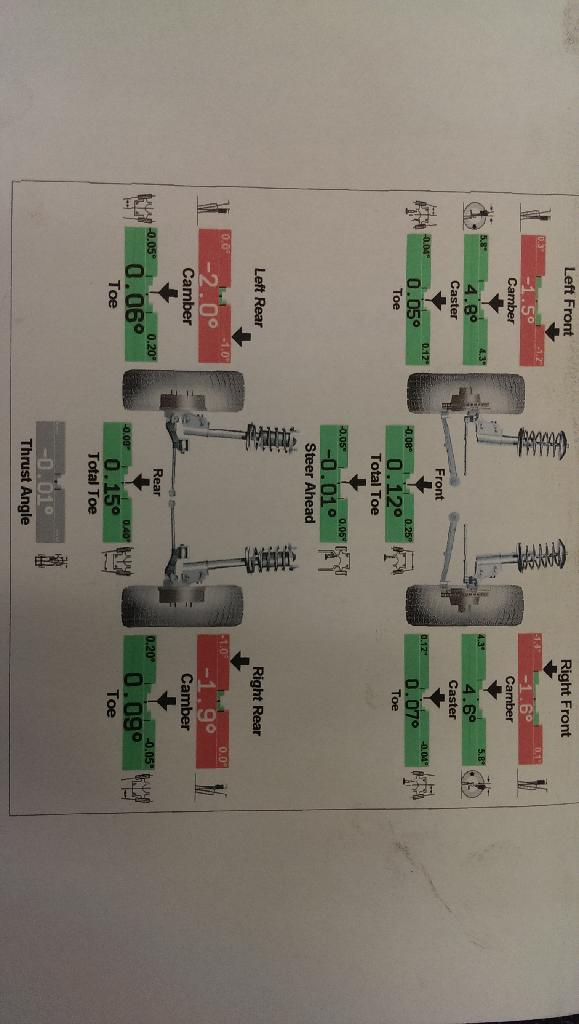

Ok figured out the rear camber/toe problem, it makes sense to me know!
The alignment rack was faulty and sticking so my previous alignment was waaaay off. It was actually toed out. Instead of being maxed out TOE IN. I knew something was wrong and it was driving me nuts. I wasnt getting the same results others on here were.
So I tried first to correct camber to around -1.0 but as others have said the arms bind. So I took the arms out and cut 1/4" off each piece (4) and then adjusted again. Thing is with my 370z rims and 265/35 tires they poke too much for my taste at normal rear camber.
So after all that work and a little money I basically set it back to the way it was BEFORE the camber/ toe kit! LOL I have to laugh or I'll cry. Lot of agrevation.... Oh well the car goes straight as an arrow and with these specs will handle good. It will wear the inside edge of my tires but toe is worse than camber so it won't be horrible.
Set the alignment with a driver to get it more acturate-
And before the camber kit-

much better to have camber than toe, if you're forced to choose. glad you figured it out.

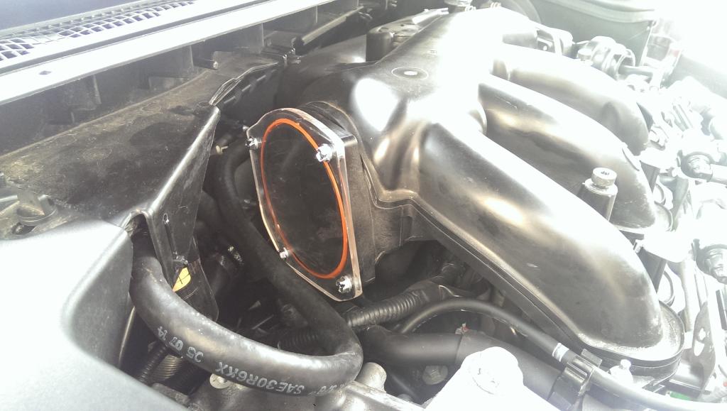

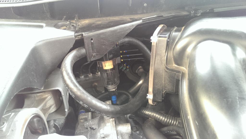

Getting tired of my Max. Can't find a reputable tuner and I'm losing interest. When I want to get reignited I usually do a mod.
So here's my latest set of mods.
Total cost = $15 or less.
BOP on passenger side only, and an oil separator. I was going to just do the BOP but after seeing and feeling all that oil in the intake after only 13k miles I figured I might as well. Very simple mods and a crap load cheaper than most spend. I never open the hood at shows so under hood is function over form.
So far I've noticed that the intake sound is amplified along with my AEM cold air kit it sounds great. Not sure about the power, it's 94 degrees today so any car feels slower than usual. I'll take it to track and see what the difference is.
And the car as it sits

Okay the passenger side bop absolutely makes the car faster on the highway. It absolutely makes it more sluggish around town to.
It pulls harder than before after 80 mph. You don't notice the drop off as much. Which leads me to believe that the BOP must close after 80. It still feels like it drops off after 80 but not as much at all, barely noticeable. I haven't confirmed if the throttle still closes 1/2 way or not cause I didn't have my scanner. I assume it does.
So since I'm not having any luck on the Uprev qualified CVT tuner I'm gonna get a throttle booster thing to help with the lag that the car has at low speeds /rpm.
Very happy I did this mod. It helped on my Altima SE-R and it definitely helped top end on this car.
After seeing the dyno run that NWP did of a 7th gen motor in an older car with a stick that it lost power till 5k rpm or so then gained. I knew that it would be worth it on the CVT cause if you floor it it goes up past 5k very quickly. Just the fact that the car doesn't lay over as much after 80 makes it worth it. People drive fast around here.

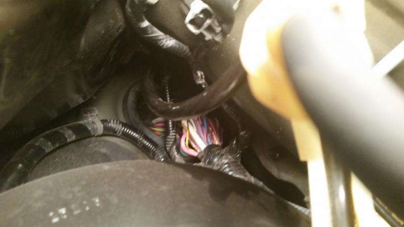

Made my own fiberglass box ran my power cable by upper harness plug no drilling anywhere
Attached Thumbnails Former SE-R and new 2014 Maxima SV Sport owner, let the mods begin-20140927_233502.jpg   Former SE-R and new 2014 Maxima SV Sport owner, let the mods begin-20140927_212645.jpg
