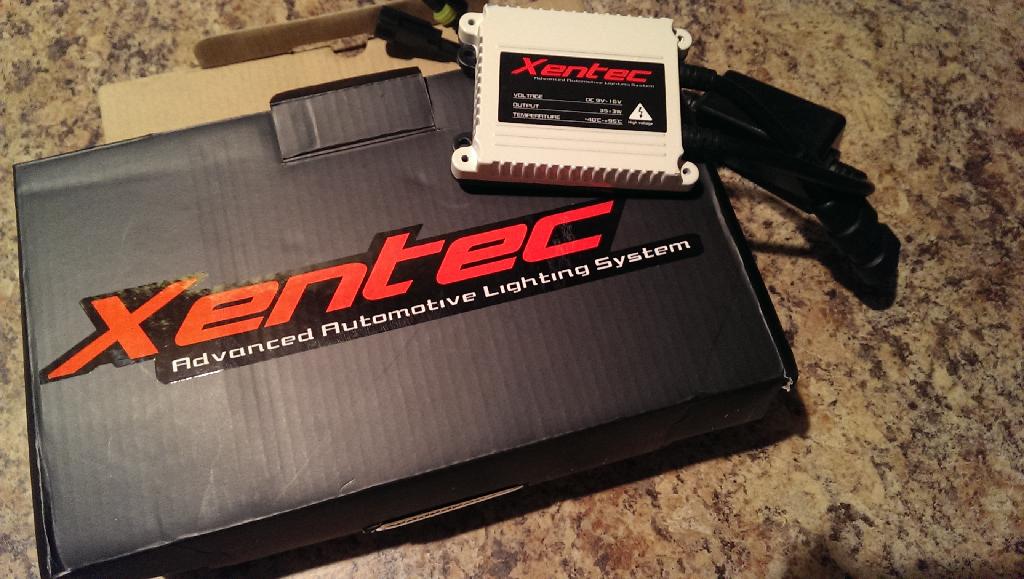

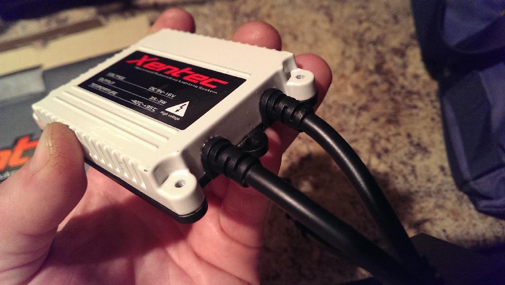

Waiting for my HID fog light kit to get here. I ordered the 5000k 35w which should match the factory HIDs.
Also I was trying to figure out what to use to get rid of the amber glow when the headlights are off. Switchback bulbs I didn't want cause imo they change the look of the headlights too much and blur out the projector. I also didn't think spending $60+ on led 3457 and 194 bulbs was a smart choice.
So I'm going to see of this works. I bought this paint that's supposed to be used on the taillights. It is rated for up to 200 degrees. I hope the bulbs don't get hotter than that.

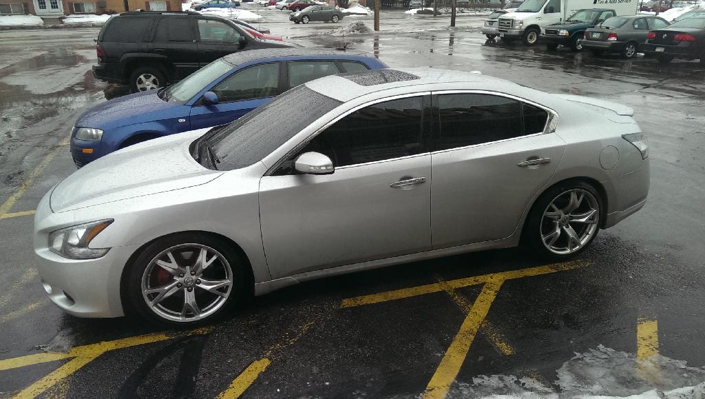

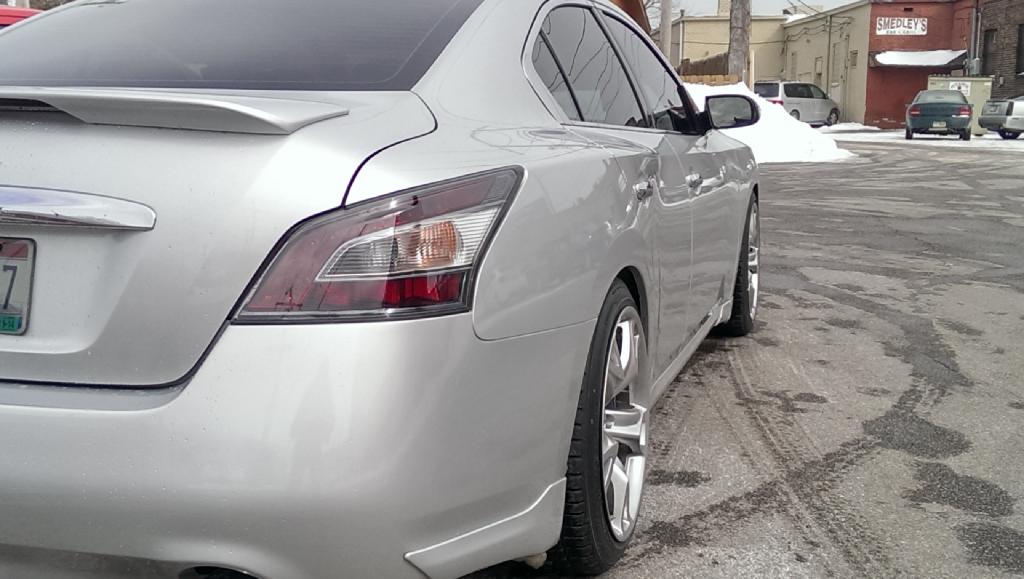

Here's a couple pics of my progress. Just waiting on the fog lights so I can do it all at once.
These came in last night so I'll be installing them in the fogs and swapping out the amber bulbs.
Also at 1000 miles I'll be switching to synthetic oil and a premium oil filter.

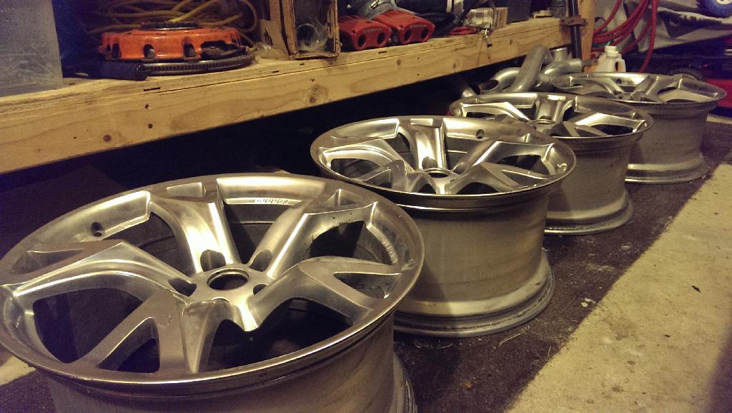

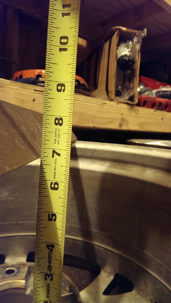

Got the rims tonight.

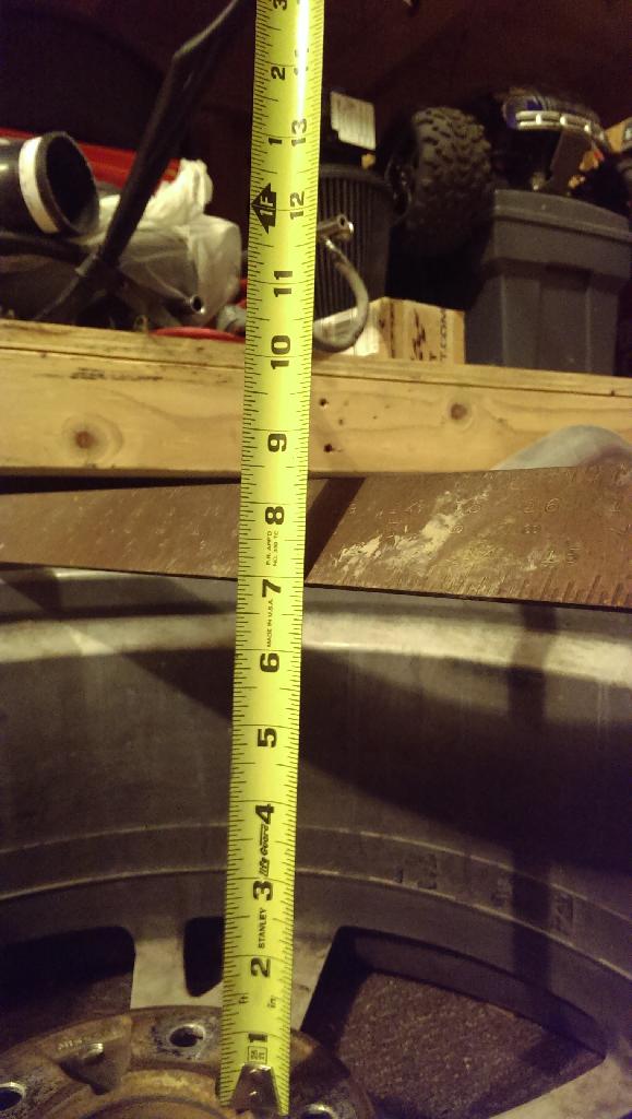

Measured and weighed the forged 370z Sport rims.
Front rim 19x9 weighed 21 lbs.
Rear rim 19x10 weighed 25 lbs.
I used a regular scale so it may be off a pound either way.

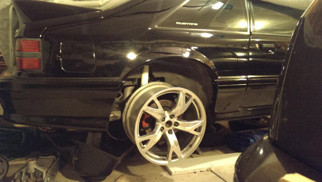

Set them on my 93 Cobra to check it out.

Nice man, love those wheels!!

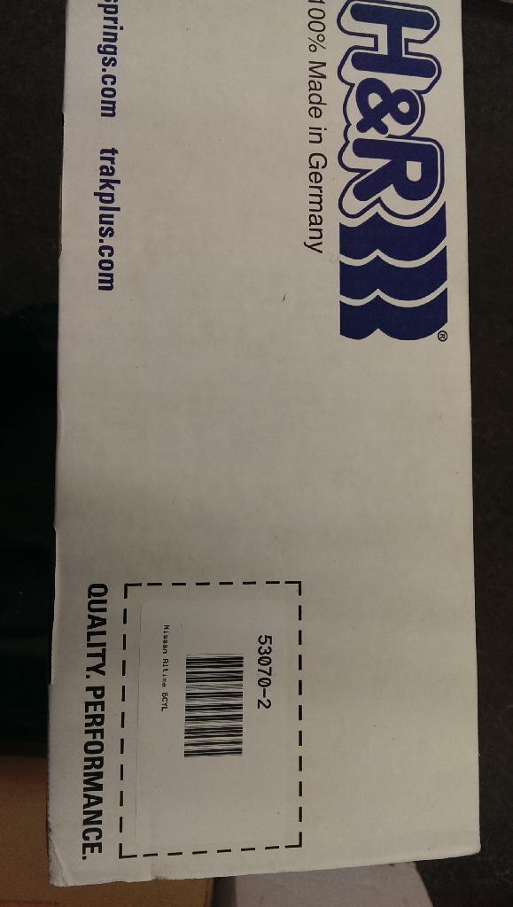

Also these showed up today. If I feel better tomorrow after work I'll be installing them. Hoping for a 2" drop after they settle. H&R says they drop the Alti 1.75" so this car is 250# heavier.

I'm curious about the springs being the same. I'm sure you've done your research, can you post pictures of the springs side by side?

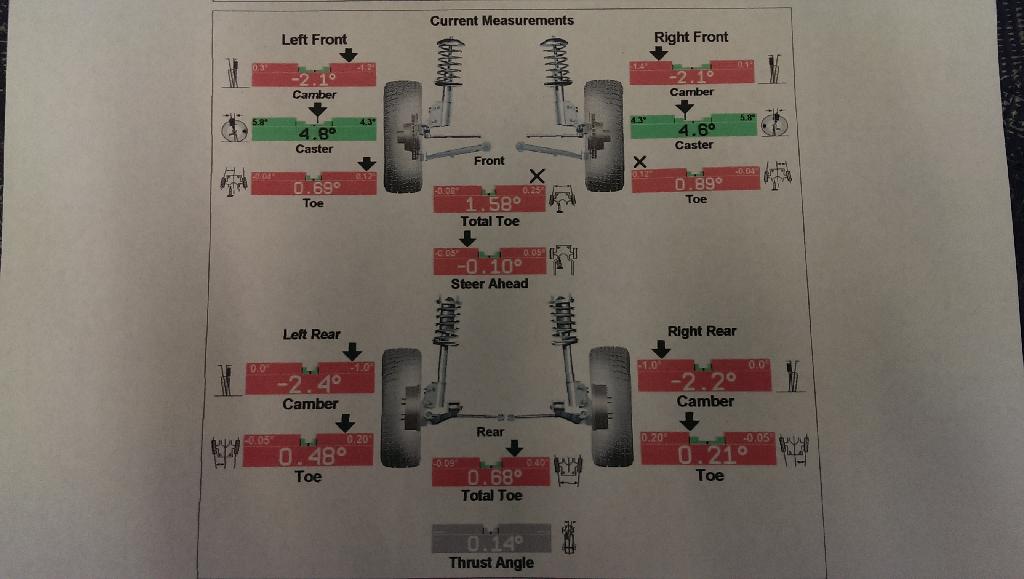

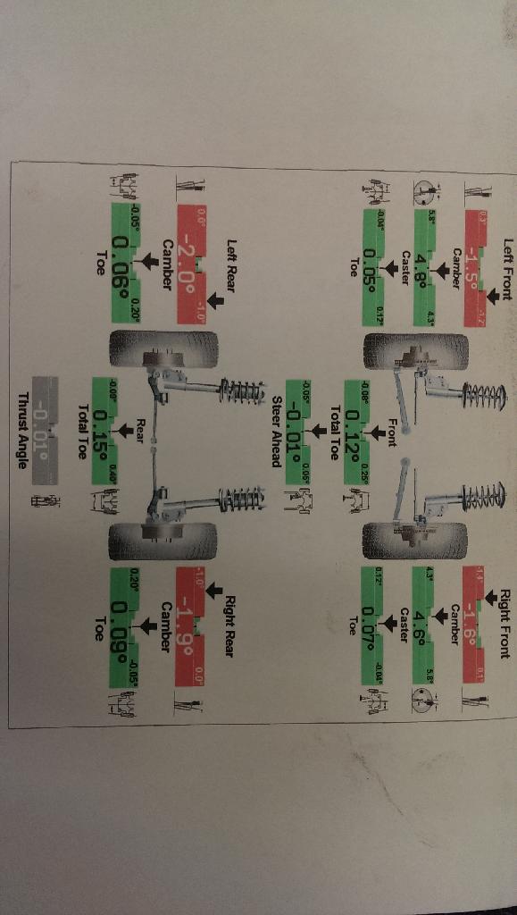

Here's my alignment specs. Before was waaaay out.
Before (after lowering)
After
It's set up perfectly IMO for handling. Had to keep the back at 2.0 camber so the rears didn't poke. Also that's all we could get on the factory adjustment.
The front I got camber bolts for.

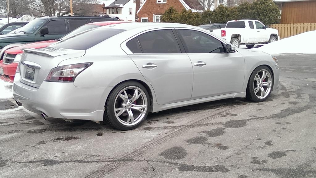

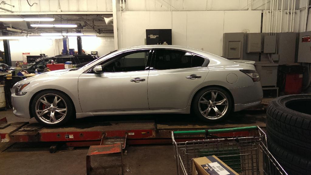

This is a quick pic I took to show the car lowered on H&R springs (Altima 4th gen)
It lowered it about 2.75" front and 2.5" rear. Rides surprisingly nice (not like a brick at all). I trimmed the front bump stops. It does not bottom out and I shouldn't have any issues with the stock struts.
Super happy I went with the Alti springs. Looks like it's on coilovers. I'll get better pics when I clean it up and it's nice outside.

really nice man, was wondering how those H&R springs fit the ride. So did you end up making any adjustments on the springs? but yeah man told you you'd love the Maxlux kit.

Yes I had to do the hose trick. Basically took a 5/8" heater hose and wrapped the upper coils. It acts as an isolator and also raised the front 1/4" and I cut 3/4 of a coil from the top rear coil. The top coils are called "dead" coils and have no effect on the spring rate.
I could have just left it but Im **** with my cars and wanted the stance perfect.
The ride is a little firmer but nothing like most lowered cars I've had.

Ordered a Racingline Y-pipe and rear sway bar today.
Wish I would have gone with a 275/35 tire in the rear and rolled the fenders.

Ordered a Racingline Y-pipe and rear sway bar today. Wish I would have gone with a 275/35 tire in the rear and rolled the fenders.
Nice, I ordered them together too back in late December. You will need the endlinks since your car is lowered because the stock ones will not be able to support the tighter bar and the drop.
Your car looks great though man! One thing I did notice about the lighter colored 7th gen maxs is that they look a lot better with the chrome blacked out. Maybe it's because the chrome doesn't stick out as much as it does on the darker ones.
That's actually the problem I'm facing with my wheels now too because I have the 2012 sport wheels in hyper silver and idk if I want to get them painted in the darker color Nissan sells them in or just get them chrome painted.
