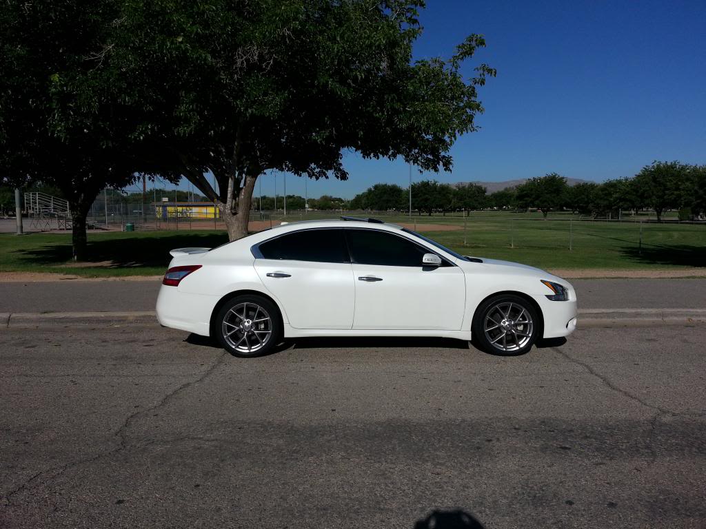

Hey guys!
So Im shopping for some new rotors and brakes for my car, any suggestions from yall? Im looking at the silver zinc ones but so many different brands!
Also has anyone done this? How difficult is it? I was just thinking of buying them and having them installed if it was a pain!?
