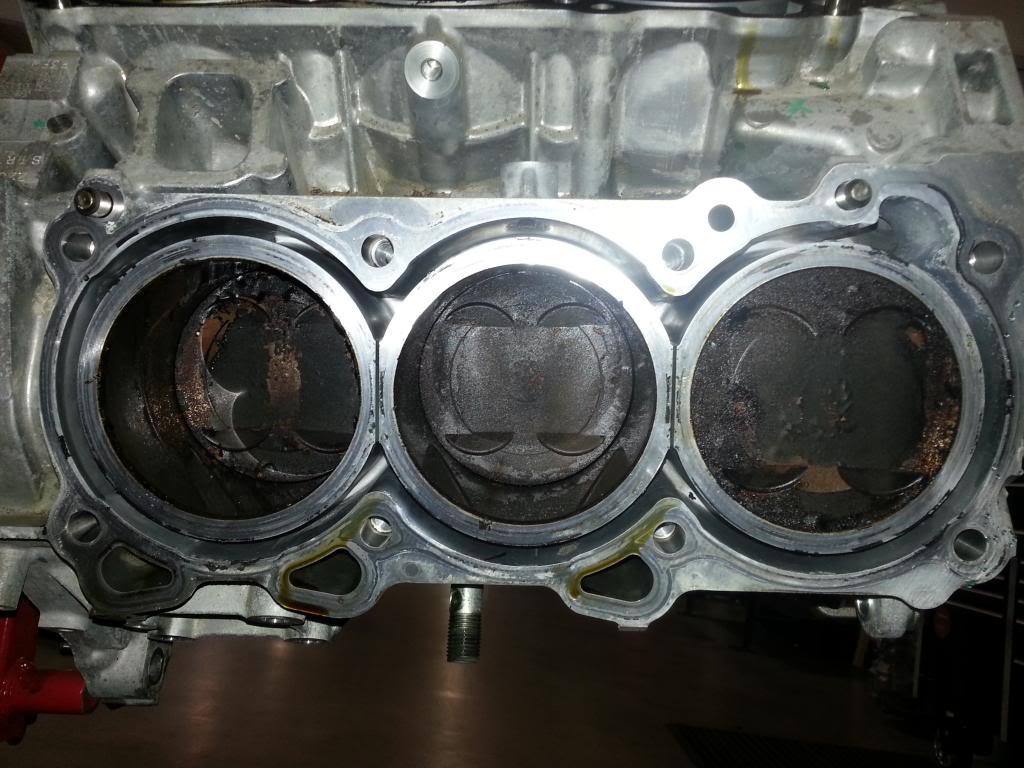

I'm trying to determine if using 93 octane while driving conservatively (mostly highway) caused this carbon buildup. My thinking is that the Maxima calls for 91 octane... my area only carries 93... and that the extra octane isn't allowing the fuel to completely burn off leading to this ^. I am very knowledgeable about engines in general, but do not have experience breaking down and evaluating many engines.
I only use Shell 93. 40k miles on the engine. No mods, fuel treatments, etc.
My thought is now that I have a new engine, I should consider switching to 89 octane for more complete combustion and less carbon buildup. Is this amount of carbon acceptable? Is is mild buildup? Moderate? Severe? Does anyone think the buildup is something else besides carbon buildup?
My goal is not to start a "which grad fuel do you use" debate. I am only considering switching to a lower grade (89 is the lowest I would go) to prevent this ^. Any comments?

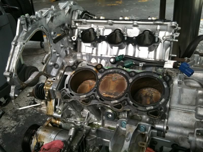

Below is what I was expecting to see... this is a 2010 Murano... same engine as our Maximas but with a lower compression ratio (87 octane requirement).

Just my opinion and I ask this as a question but wouldn't the carbon buildup be equal across all the pistons if was the gas or the octane level?

What really looks bad to me is the first picture, far right piston and second picture, middle piston... there appears to be raised portions of the carbon that actual breakup the "flatness" of the piston. That doesn't look good to me... but again, I'm no expert. Thanks for the comments.

Kawowski - you have the octane theory confused, 93 burns quicker then 92, 91, or 89. And burns at a cooler temp. as well. Your build up looks to be more oil based not full carbon, nonetheless, its pretty bad and its a call out to Nissan since VQ35s have been problem makers since their first introduction.

Thanks for the comment on the possibility of oil... I didn't think of that. Now I'm worried my heads are faulty leaking oil into the cylinders. They replaced my shortblock, but of course by definition, reused my heads. I haven't noticed obvious oil loss, but I'll keep an eye on it.
I thought the definition of higher octane was it's resistance to detonation... therefore ignition. It requires more energy to ignite (spark plug firing vs. only hot pistons). This prevents the fuel from igniting in high compression (and hotter running... think temperature vs. pressure) engines sooner than desired. I could be wrong, but that is my understanding.

You are both correct essentially. Diesels ignite from compression, and heat, not just heat. You aren't going to ignite fuel from just piston retained heat unless you are running a drag car. Higher octane resists ignition, but burns faster than lower octane.
That picture looks like oil leaking, maybe a bad valve seal. If it was gas related it would be the same across all cylinders. That looks like a head problem to me.
Thanks for the input... problem is they replaced the short block, so the same heads went back on the new block.
