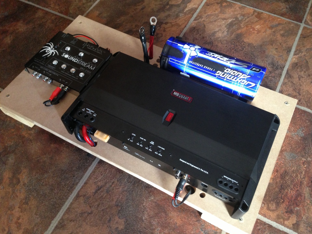

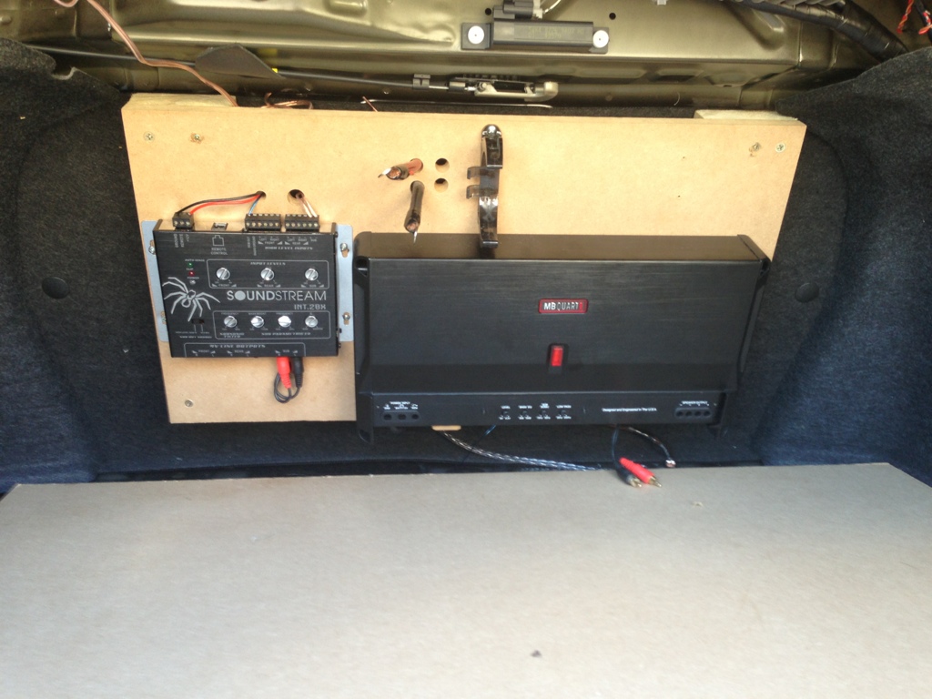

this is my setup. It sounds great with Bose system. An MB Quart 1000 watt mono amp pushing two Rockford Punch 12's. BTW, the little Soundstream box (INT-2BX) made this install a cinch with the Bose system.
Amazon.com: Soundstream INT-2BX Digital Equalizer w/ Subwoofer Output: Car Electronics
Does your car rattle much?
Inside the car, not one bit. It's a well made cabin. Outside, im sure it does, I've never cranked it and stood outside though. The license plate frame for sure rattles, you can fix that though.
