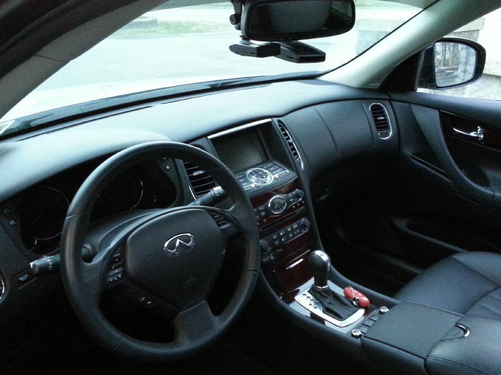

I since sold the car and installed it in my infiniti. Its great to have for that very reason. You never know whats gonna happen, and whenever something does, you will always forget small details. With it on video you have nothing to worry about when somebody causes damage to you.
As you can see in the picture, it is under my rear view mirror, right next to my radar detector. Both are hard wired, and turn on and off with the ignition on the vehicle.
As for the way it is set up, The camera has a very strong suction cup mounted to the windsheild, and normally plugs into the cigarette lighter. I ran the line along the headliner, down the drivers A-pillar and used an Add a circuit device with another 12V outlet to the cigarette lighter fuse. All connections and wires are neatly hidden behind the plastic and nothing is visible. As for the radar (in case you want to know) I have a Mikes mount and invisicord tapped into the power on the mirror.

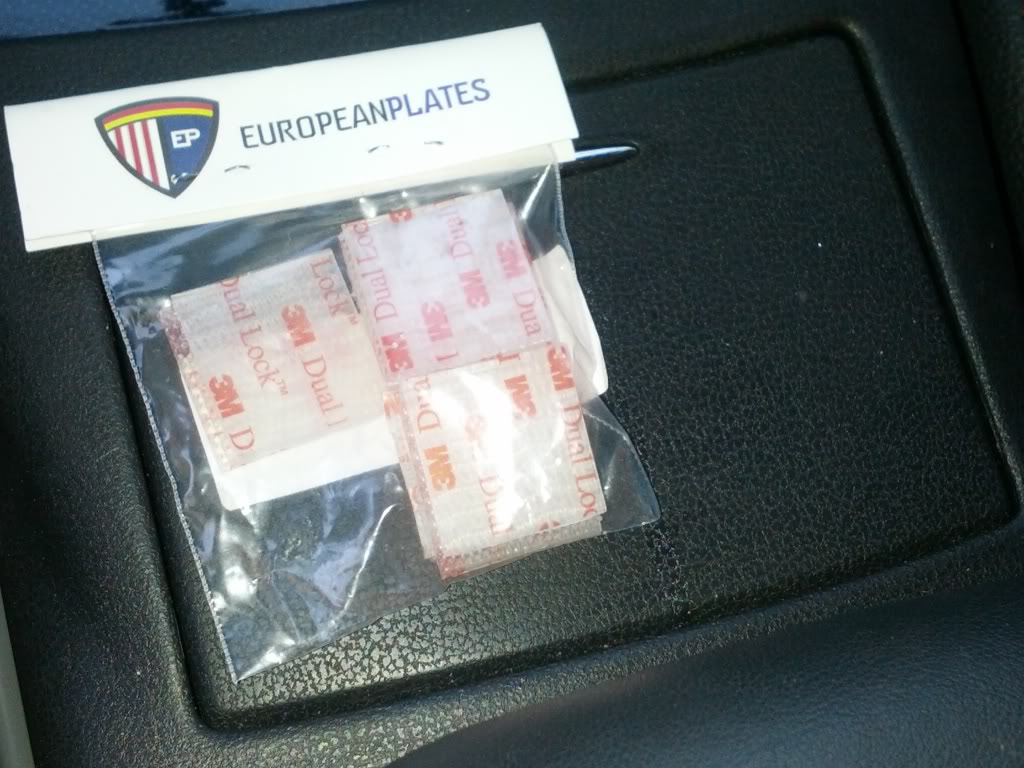

and I'm going to stick the camera to the back of the mirror with "3M Dual Lock Velcro" its on amazon and ebay. I'm sticking it to the back of the mirror vs on the windshield because I know the 100 degree Florida heat will destroy the camera. So I wont have to remove it form the mount every time.

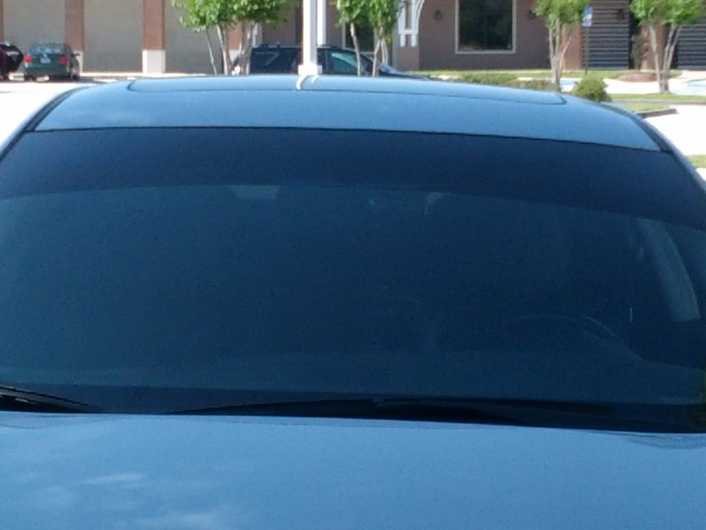

Has anyone had any experience with mounting the camera up high so it's out-of-sight behind the dark shade strip?
I was wondering about the recorded picture quality with it set-up in such a manner?
My thinking is that by being shaded it could help with the heat from direct sunlight.
I have my Escort radar detector hard-wire mounted in this manner and it's all but invisible from the outside (even through the drivers window) and it still functions great.

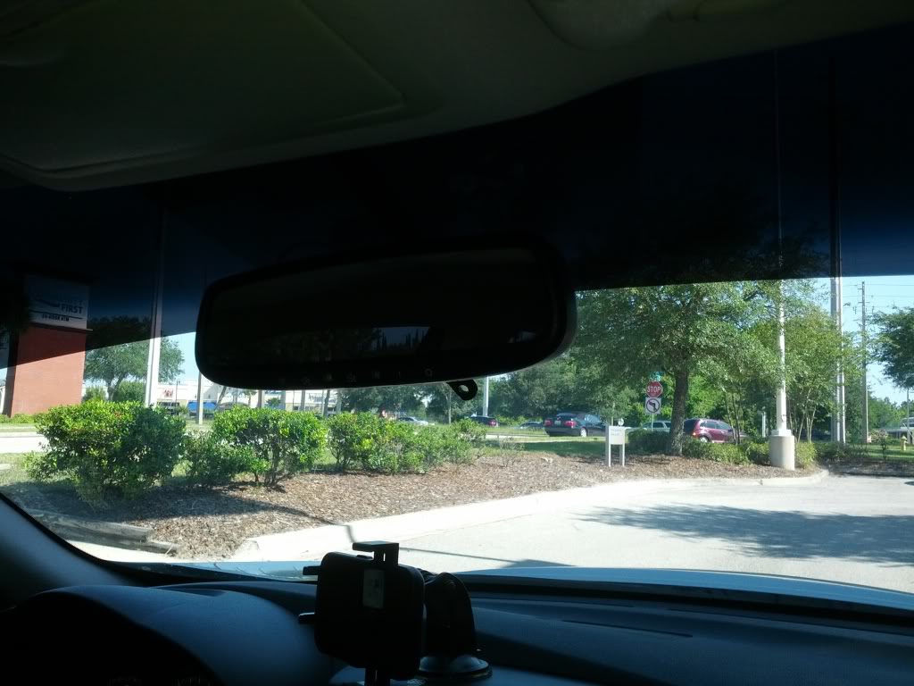

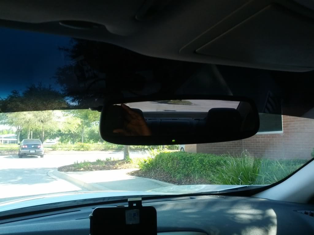

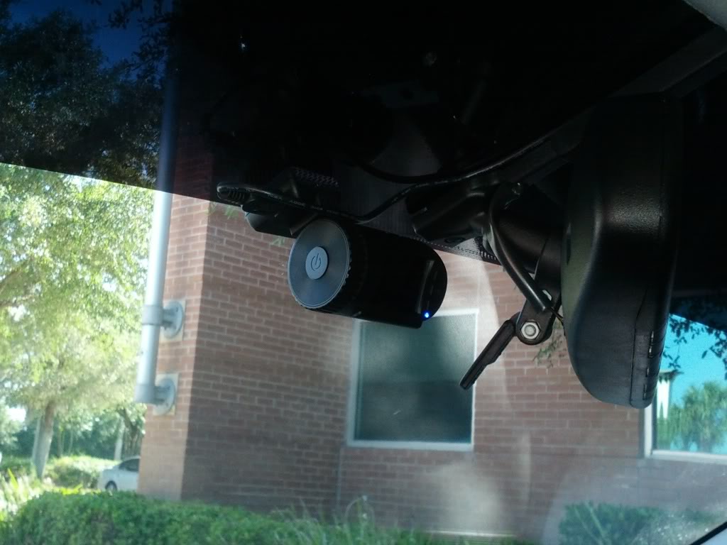

This is a good hidden set up I just have to change it in my situation of having to deal with the Florida heat.
^This is the actual camera.
You can see that I have the bicycle reflector bracket mentioned here: http://forums.maxima.org/7th-generat...t-7th-gen.html I'm going to try to use that to mount the cam away from the windshield with the 3M stuff. I have the cable routed to the fuse box just as that escort is (thx alexdi)
^Outside view camera is well hidden
^This is the view from the passenger side... The camera is completely out of view.
^This is the view from the DS the camera is hidden nicely only part of the usb cable is seen.
^3M

OK then. I had it in my feeble mind that the camera was pointing more downward like directly in front of the car. I just learned the cameras FOV is quite expansive. That must be the shade strip I can barely see in both upper corners of the video?

I dont think thats the shade strip. The field of view is important on these cameras this model is at 135 degrees. Yes I did get a ticket not sure if i should fight it or not:
