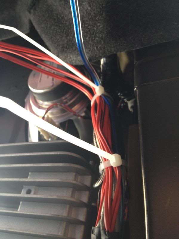

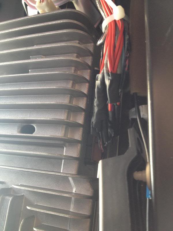

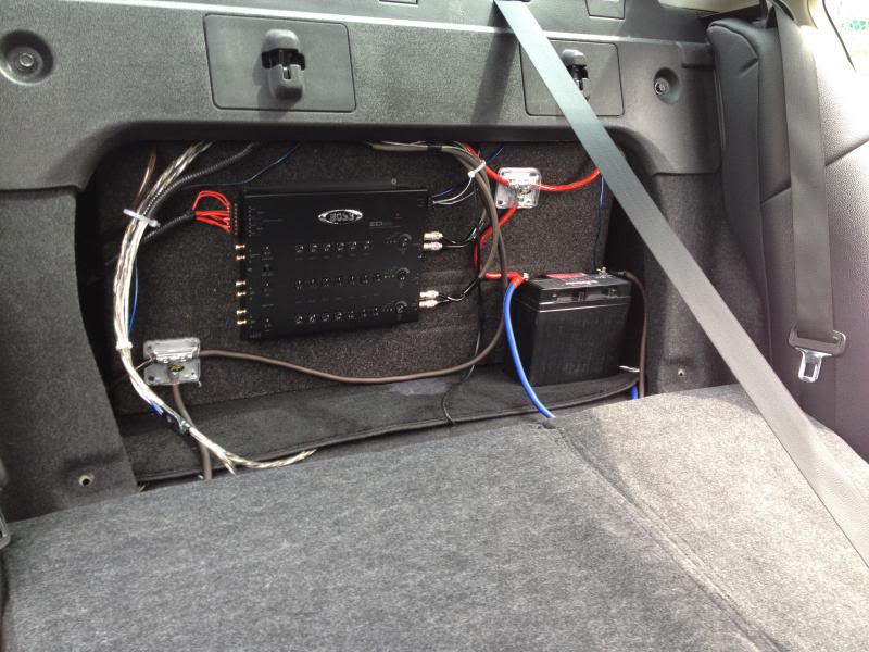

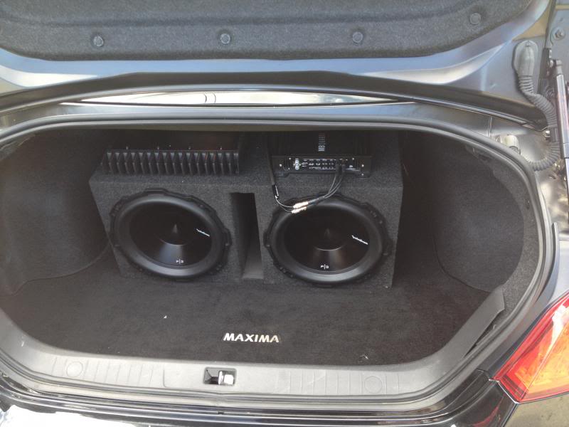

which bose radio do you have??? monochrome(orange) screen or tech pkg with backup camera?? i just did mine a few weeks ago all connections were from the amp in the trunk. tapped all four signals from the radio before the amp, also there is a remote wire, and power wire for the bose amp u can use...

the red wires are all from the radio BEFORE going into the amp, the blue n white wire, are the power n remote BEFORE the amp too...

i have a 2011 sv, with tech pkg...
