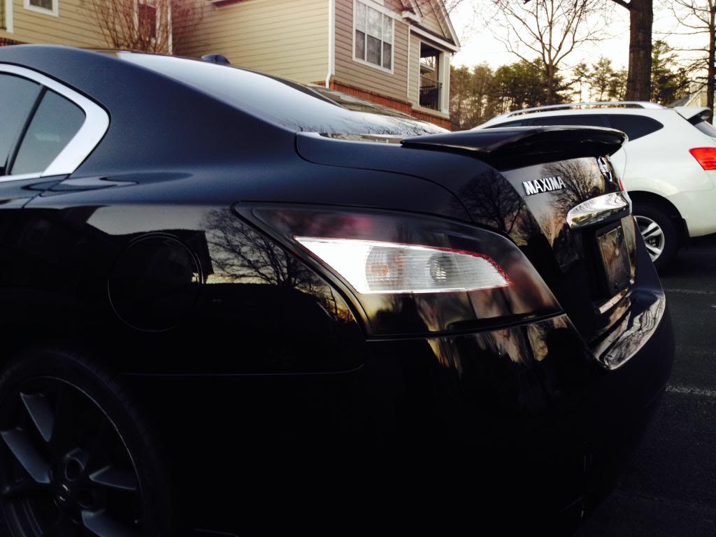

VHT makes one called Nightshades and I myself used Rustoleum Lens Tint....4 coats and plenty of clearcoat....then sanding and buffing!

I used a Rustoleum clearcoat and as for the sandpaper you'll want 1000,1500,2000,2500,3000 grit sandpaper. I hit it with all of these, then rubbing compound, then plast x.

Well my tail lights should arrive tomorrow... We'll see how they look. Definitely not as dark as your self-tinted lights, which are quite nice. My maxima is winter frost so super dark wouldn't look as nice as the stock smoked look I think
