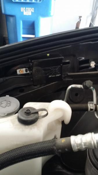

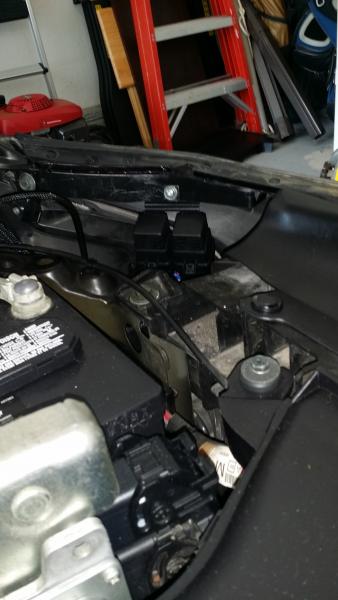

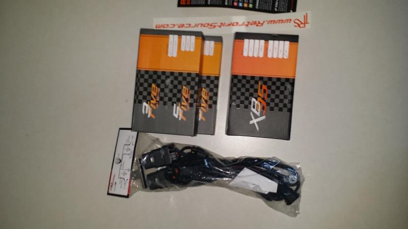

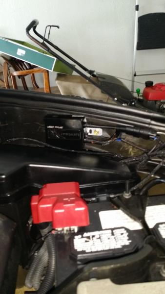

Completed the install, took about 3 hours, half of which was head scratching trying to determine where to put the ballasts and relays. The 3Five ballasts had mounting brackets, so I decided to hard mount them. Didn't take the wheels off, just removed (3) bumper screws and (4) push in connectors holding the front of the fender splash guard. My only confusion was that the Relay harness had only one signal input. A quick call to TheRetrofitSource, got a quick answer. Only requires a single input (have to use the drivers side) due to the harness setup.
Absolutely love the 6000K output! no flicker.
pics not so good, apologies.
