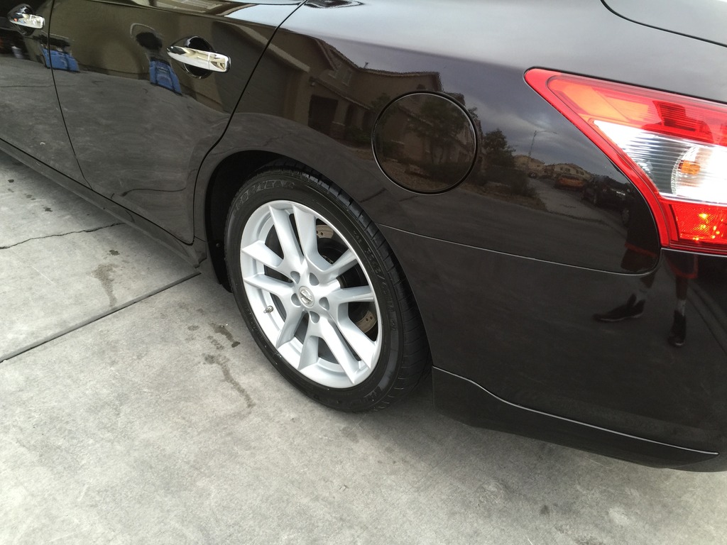

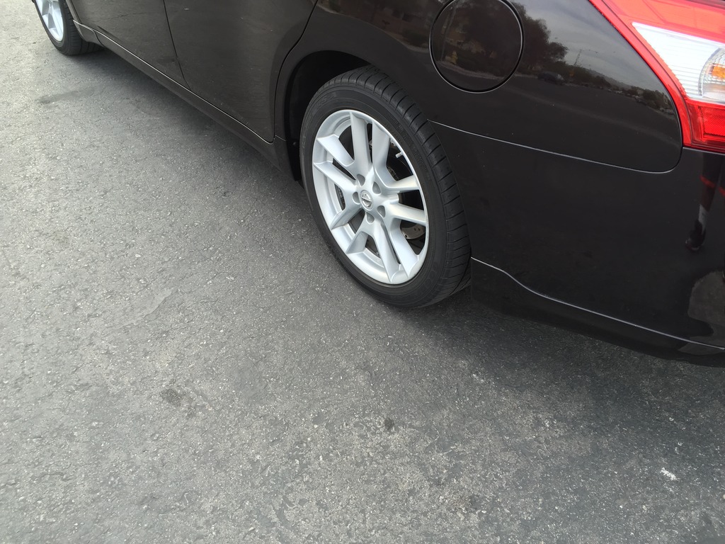

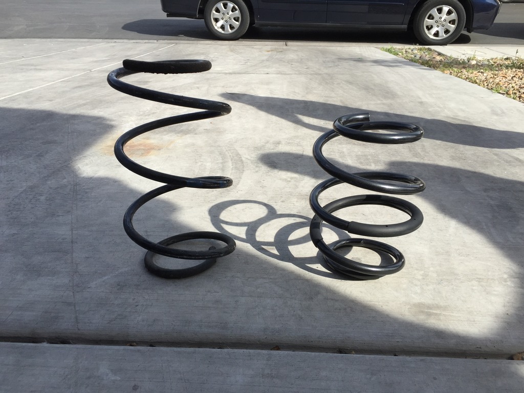

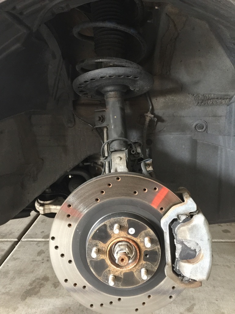

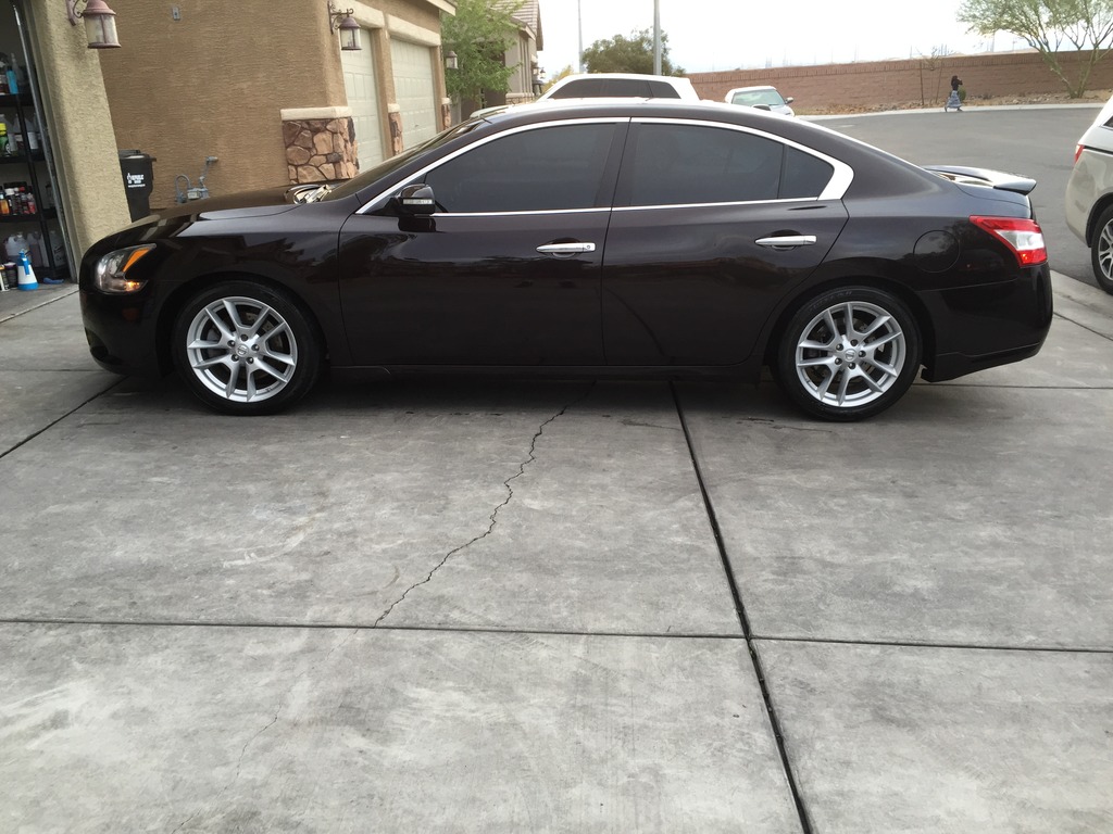

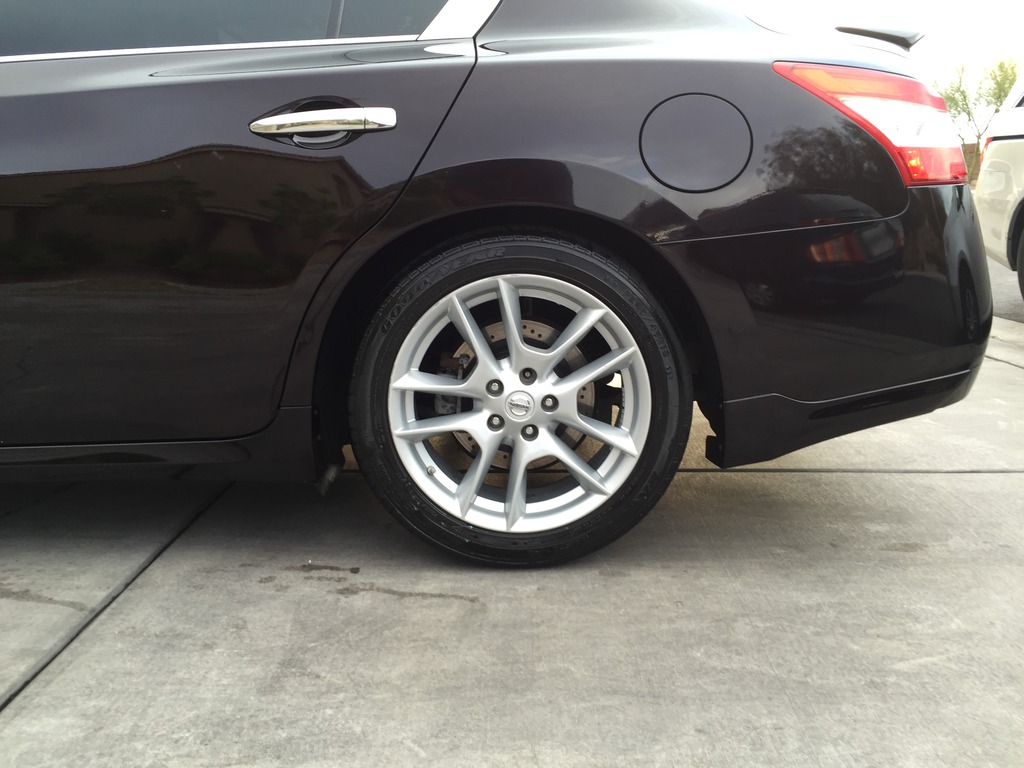

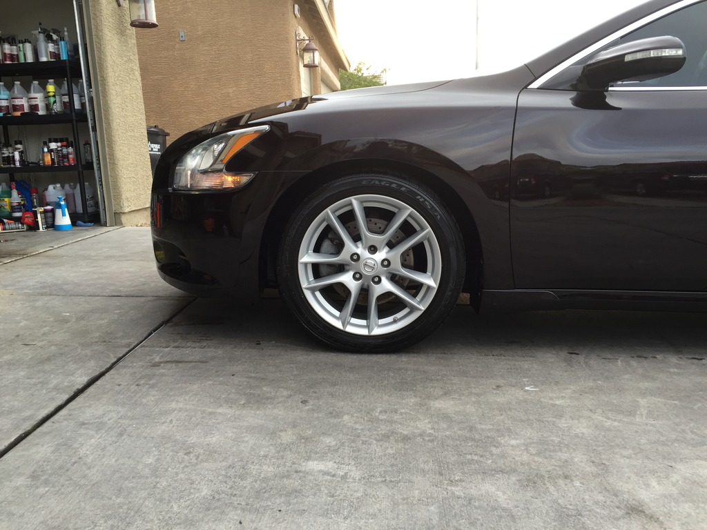

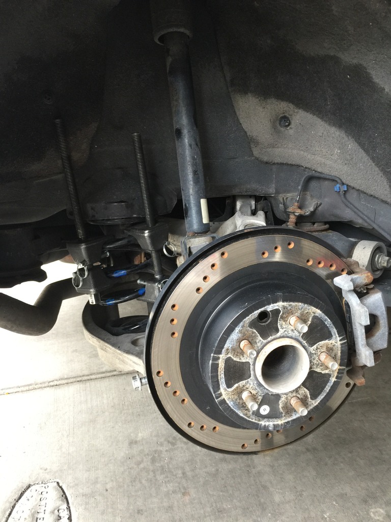

Decided to install the springs today. Went smoother than I thought. I can already feel the difference in handling and in how low it is...cannot wait for the springs to settle...thinking about adding some spacers. About to do some more research to see what size spacers to go with. Thoughts?
Before...

Looking good! Here is a very useful thread with great information regarding spacers.
https://maxima.org/forums/7th-genera...-your-max.html
Old Mar 22, 2015 | 09:11 PM
1996blackmax's Avatar
Posts: 4,532
From: San Diego, Ca
Looks a lot better! I'm liking your cross drilled rotors too.
Edit:
Many of us have installed the H&R DRM spacers....20mm up front & 25mm in the rear.
Old Mar 23, 2015 | 05:15 AM
CMax03's Avatar
Posts: 9,587
From: Houston, Tx
Nice job....Looks like a 1"-1.2" drop. Not much be still real world friendly nosteep driveway entrance issues nor speed bump issues...Nice Xdrilled rotors as well! Advance auto carries some smaller tighter coil spring compressors that are priceless. Those you have work but are too bulky on the 4th and 5th Gen rear coil springs....
Old Mar 23, 2015 | 10:16 AM
Sir Tilus's Avatar
Posts: 79
From: Las Vegas, NV
Thanks for the info on the spacers!
I'm diggin' the rotors as well. The stopping power is awesome!
Yeah, those things were kind of a pain but I rented em' from a local auto parts store lol.

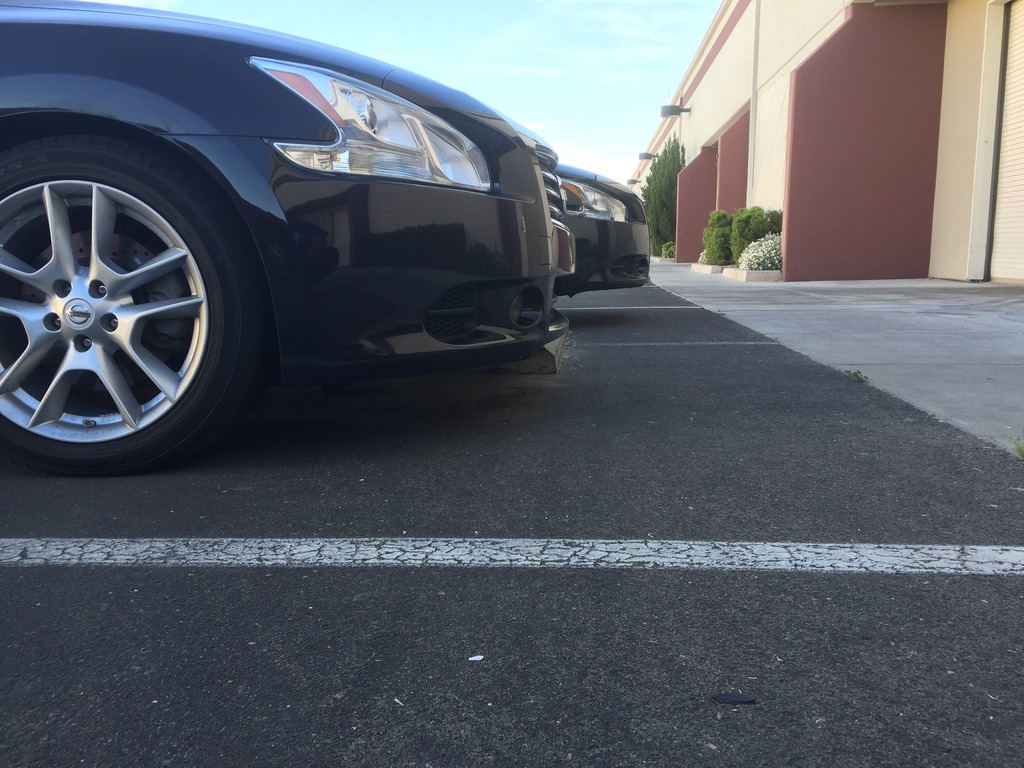

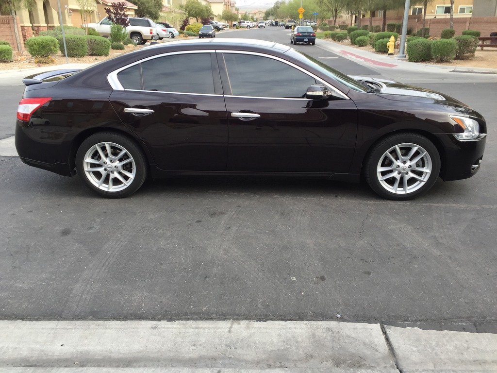

Just an updated pic after less than a week of spring install...luckily another 7th gen parked right next to me...

Old Mar 26, 2015 | 06:35 PM
fame126's Avatar
Joined: Nov 2014
Posts: 121
what's the drop on the eibach? 1.4 front and 1.8 rear?
Old Mar 26, 2015 | 06:45 PM
Sir Tilus's Avatar
Posts: 79
From: Las Vegas, NV
1.3" in the front and 1.4" in the rear...
Old Mar 26, 2015 | 06:58 PM
fame126's Avatar
Joined: Nov 2014
Posts: 121
u happy with it? I just ordered the rs-r springs for my ride their 1.4 all around
Old Mar 26, 2015 | 08:37 PM
Sir Tilus's Avatar
Posts: 79
From: Las Vegas, NV
I'm happy with it. The ride is still smooth and comfortable. I'm consistently monitoring the car's performance to see if anything else is affected or changes but that will only be for a few more days....I saw the RS springs and was tempted to try them but didn't know too much about them so I went with I was confident in. Let me know how they are when you get em...

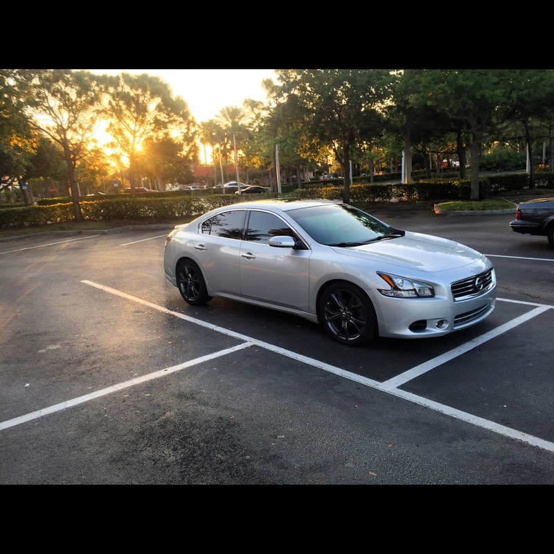

Here is mine with eibachs h&r spacers and camber kit

The h&r DRM trak+ bolt on ones, they come in black also, so you can't even tell. I got the camber arms to fix the alignment in the back. 20/25 is perfect
