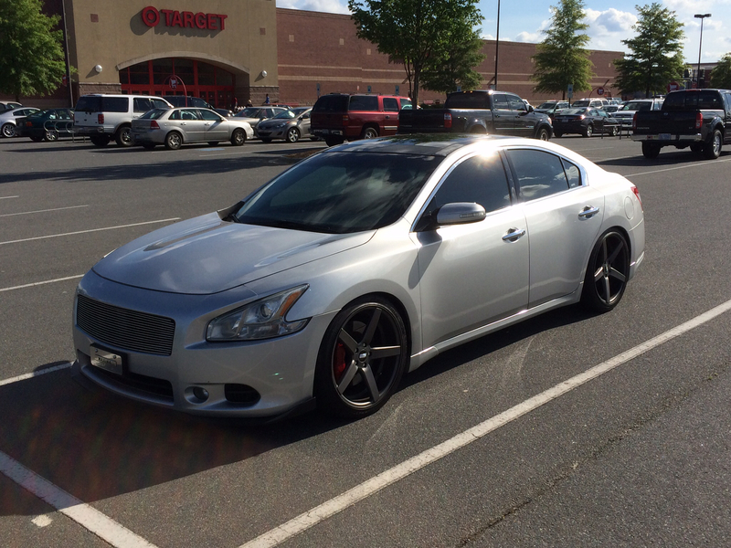

Lowered 3+" on BC coils, for about 25k miles now.
Absolutely no problems to date.
What exactly is going wrong with your end links? Just noise?
