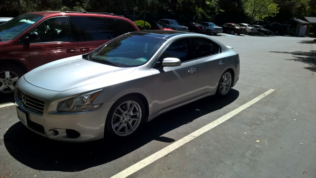

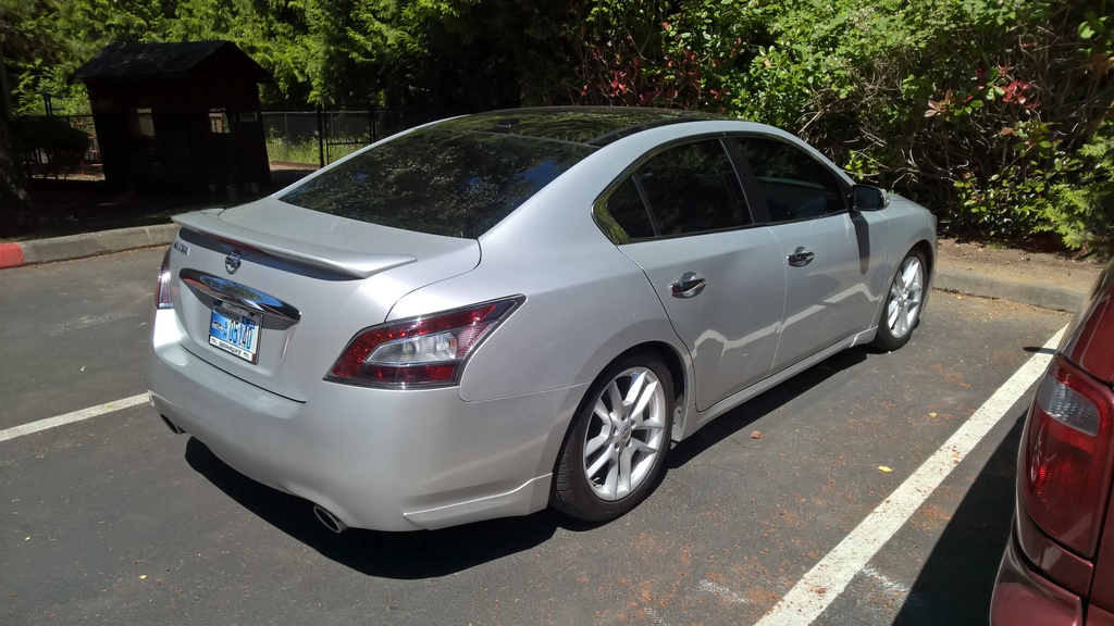

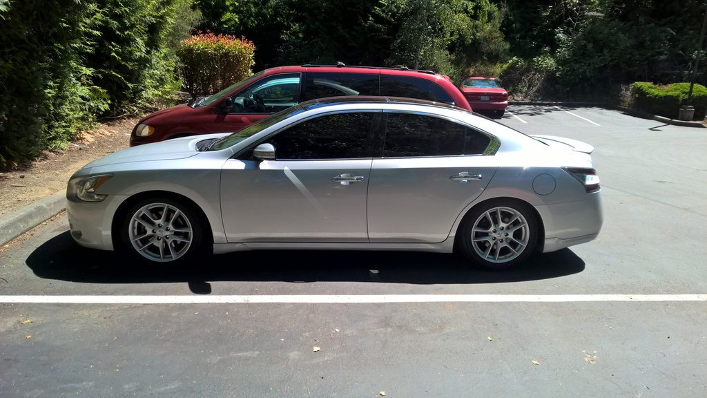

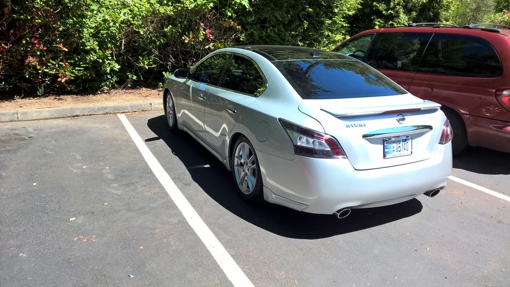

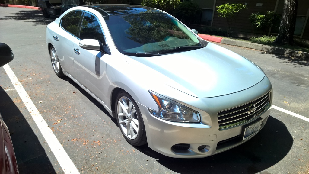

I finally got around to installing my set of BC Coilovers that I bought from BBMaxi. The car is in getting an alignment now. One thing I noticed is you can feel everything in the road now. The car is considerably more firm compared to the stock SV-Premium suspension. Right now I have the fronts set to 18 clicks from full soft, and 15 clicks from full soft on the rear. There is roughly a 1 finger gap all around.

Is it just me or can I see the difference from your front to back in height?
Why the difference in clicks for the coils? And why not have the front sit lower instead?

The rear wheel arch I think is a little lower than the front. However the car has settled and the rear is too low for my liking. I plan to raise it some this weekend. I might raise the front slightly too.

So this afternoon I did some tweaking. I raised the rear about a good 1/2", and the front about 1/4". I have roughly a 1 finger gap all the way around now.
