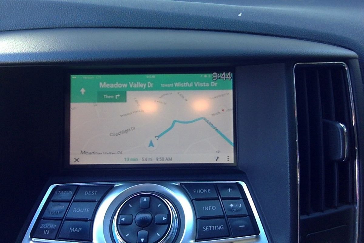

Alright, So I'm not a huge fan of the built in GPS in our car. I think it's out-dated and lacks a lot of the information and ease of use of the maps apps on my iPhone. So I set out to find a way to mirror my phone screen to the maxima screen.
I have the Tech package, so technically I already have GPS, but this should work for any Maxima with the color screen and RCA inputs in the center console.
To use this for maps while your car is in motion, you will have to perform the GPS bypass. Do this at your own risk. I'm not responsible for any damage to your car as a result of performing the procedure, or any damages/fines that result from your use of the features it enables.
That said, here's the link.
I'm pretty happy with how it turned out. You can use this set-up to play music, even if you aren't mirroring your screen. I generally just use it to play music, and leave the native GPS screen up, but it's super easy to throw my google maps app up on the screen when I need it. Mirroring the screen will work with any app that supports the feature, all you have to do is hit the AUX button, and flip the bypass switch.
Additionally, I have a 2009 maxima. This year car doesn't have a USB port, but only has a 30pin apple plug that goes to this big funky connection. I tried a number of different adapters to try to make it work with my iPhone 5 (and later 6) and never had any luck. With this set up, I can listen to music from my phone again.
Here are all of the cables I used to make this work. From top to bottom:
Here's all the cables laid out on my table:
and again all plugged together:
Here's what google maps looks like pulled up on the screen. (tried it with apple maps too, and it works, but I consider google maps far more accurate and easy to use).
Works for Music videos and such too, but I would only use this feature when the car is stopped.

I like how it doesn't clip the sides because of overscan on yours, iphone6 must have a different aspect ratio/resolution.

I just adjusted the tint and contrast in my car's settings and it looks amazing now. Looks even better than the map from the built in gps.
After the adjustments, I'm 100% pumped about this. Wish I would have done it years ago.

Just got all the parts for this and tried it out on my 2010 sv sport which has the colour screen but not the nav. I used the iPhone 6 and found the it didn't fill up the whole screen. I noticed when I did connect it, it said 720p 60hz. Could that be the issue?

Try streching the screen funnyman. It's in the options on the actual screen (maxima). I know the ipods had the feature as well don't have an iPhone so I can give exact instructions on where that might be

Actually funny u mention that. I was trying to go to the settings in the car and when I pressed settings and began scrolling down the options, the screen filled up fully like I wanted it.
But once I exited the settings area it went back to bars on the left and right.
I will try and see where the setting for stretch is..
Old Aug 14, 2015 | 05:35 AM
mikekay's Avatar
Joined: Apr 2015
Posts: 250
you actually have to hit okay after doing that and then wait it takes a second to flip over.

To get it to fill up the whole screen, all you have to do is touch the screen while your iPhone mirror is showing up (I have tech pac, are all of the screens touch screen?) and then a little "settings" bar will pop up. Set it to "wide" and then press "OK"
