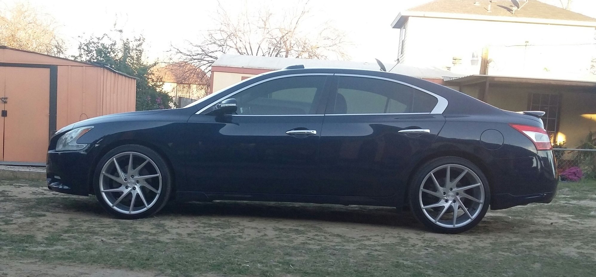

Just bought sum Niche rims Invert M162 I just wanted to ask what is the best way of getting them mounted the right way with no rub tire size and do I need spacers?

These are the rims ijust got

They are 20x9 +25 offset

Should be OK with a 245/35 tire. No spacer.

A 255 has a larger overall diameter and width than the stock size which will increase your chances of rubbing both on the fender edge and the inner fender liners when turning. Putting a 245 on a 9" rim already widens the tire plus you are running a 25mm offset which puts it further out.
Find a tire shop that will sell you the proper tire size, not the size they have and are trying to get you to buy.

Before!
After!
