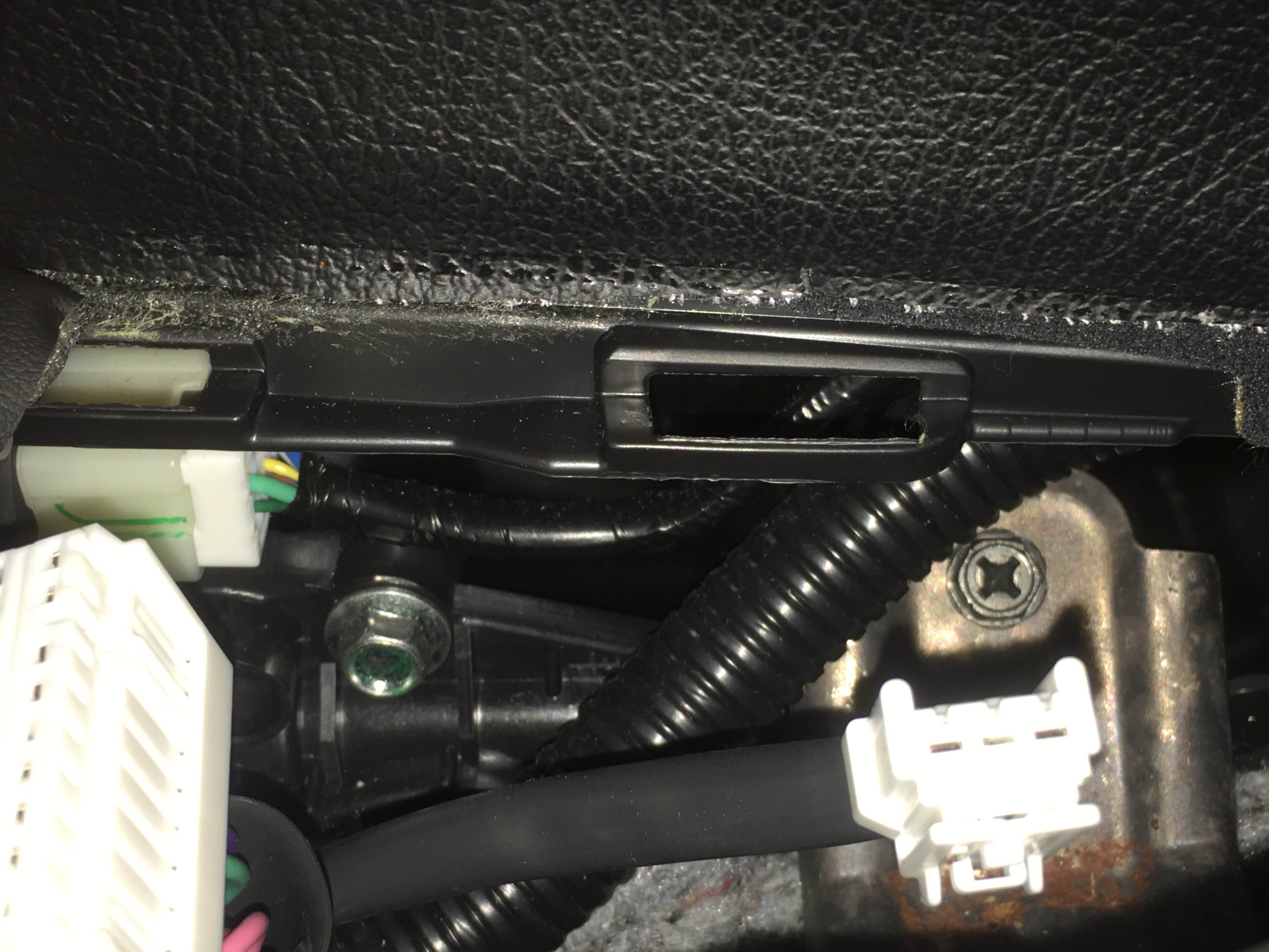

A) The first thing is to put off the plastic cover behind the door handle.
B) Pull up on the arm rest to remove it, and then disconnect the window control from the harness.
C)There are two more bolts (I've worn the nuts part out by now) and then you can pull on the side of the door panel near the door hinge. There's actually a place near there were the panel is offset from the door for ease of pulling the panel. I would use your hand here and not a flat head screwdriver.
