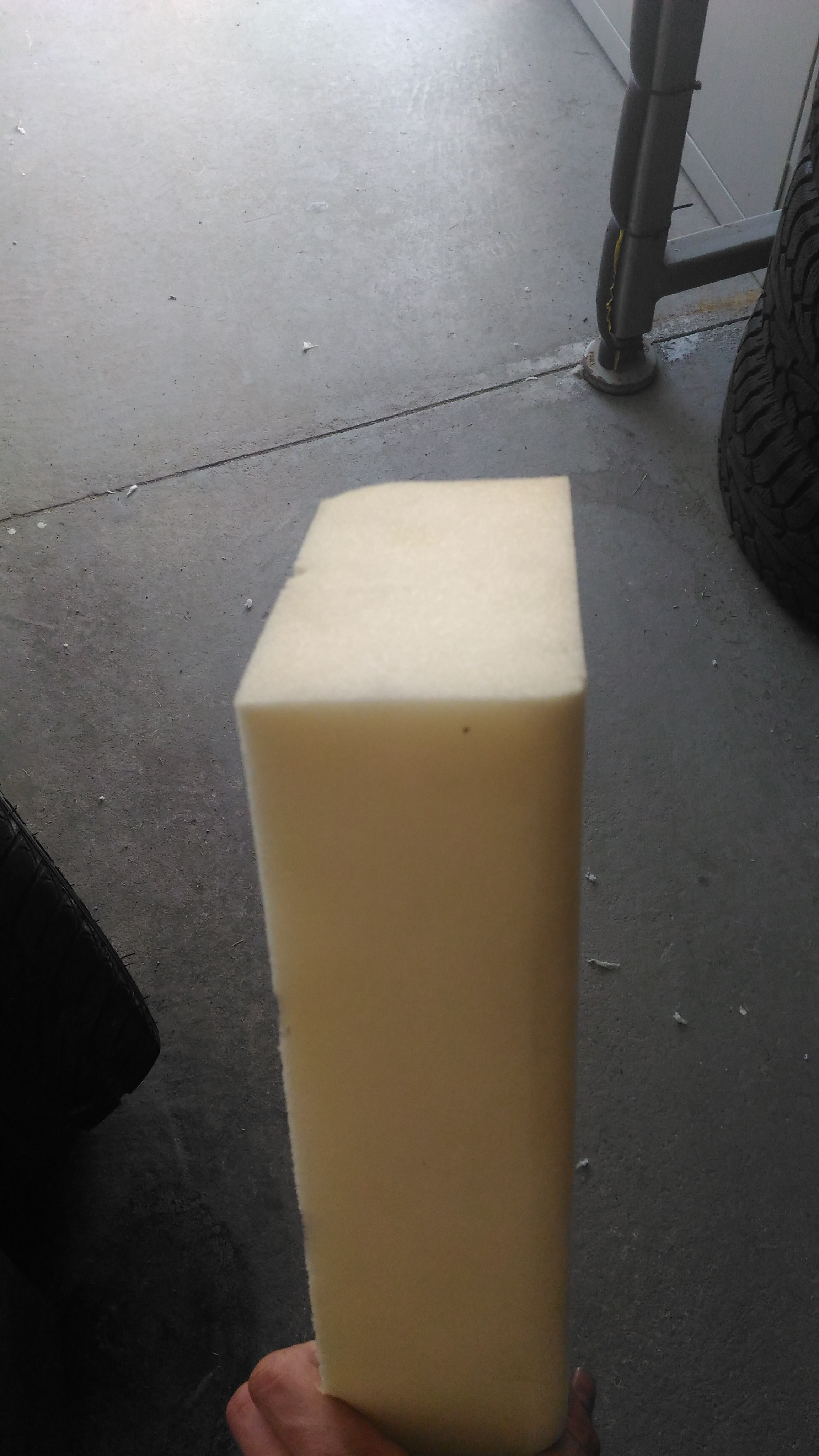

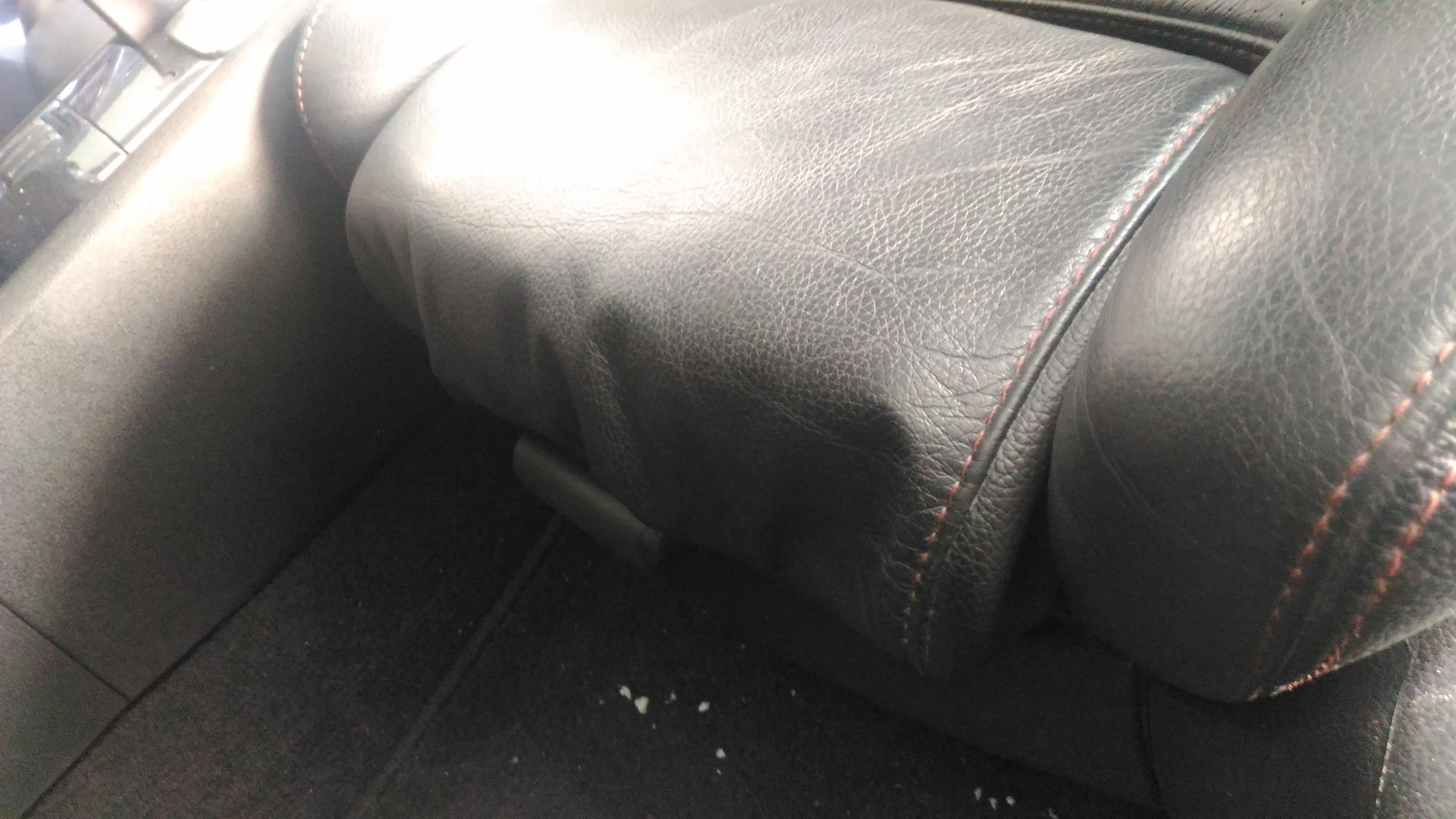

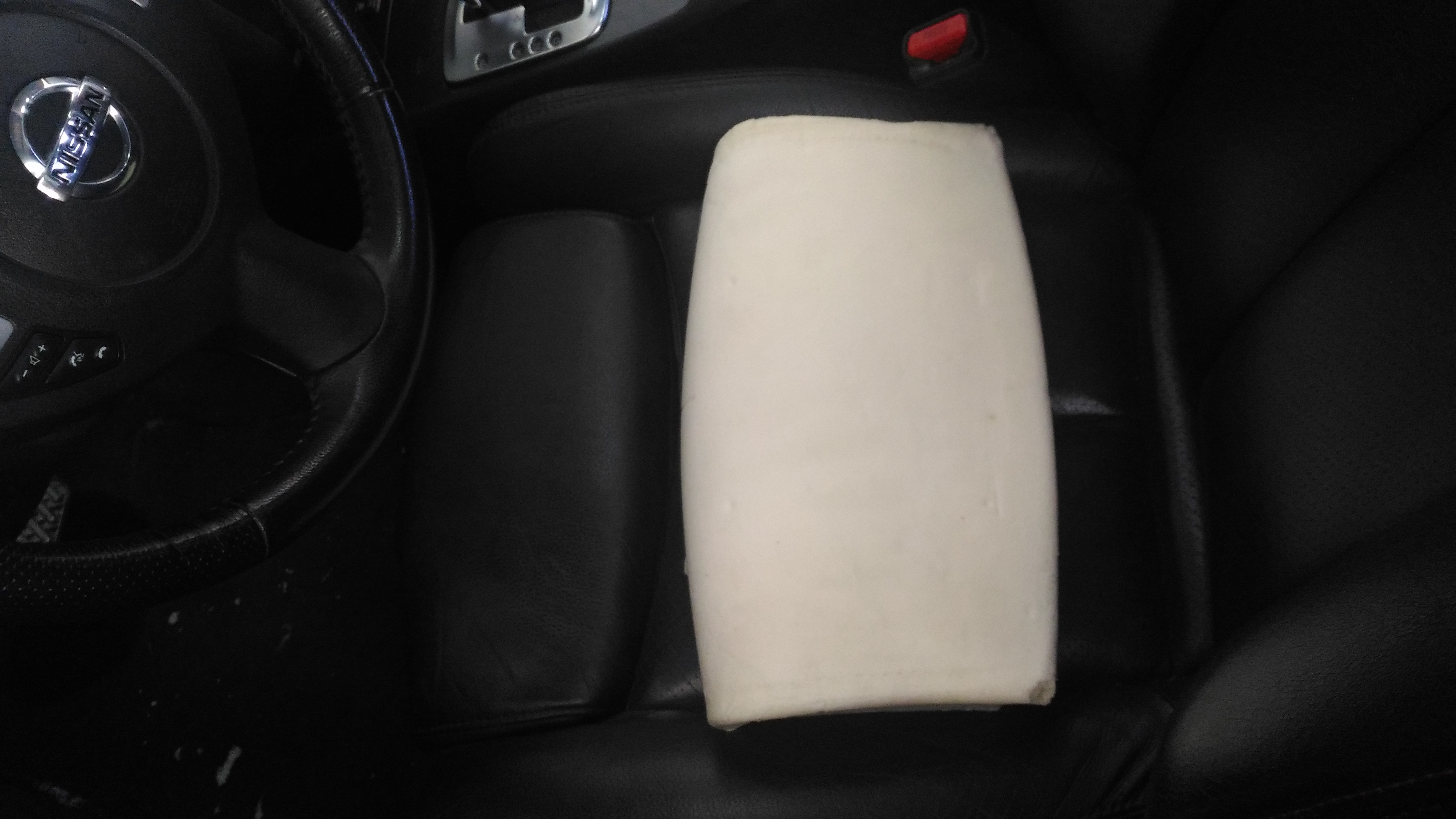

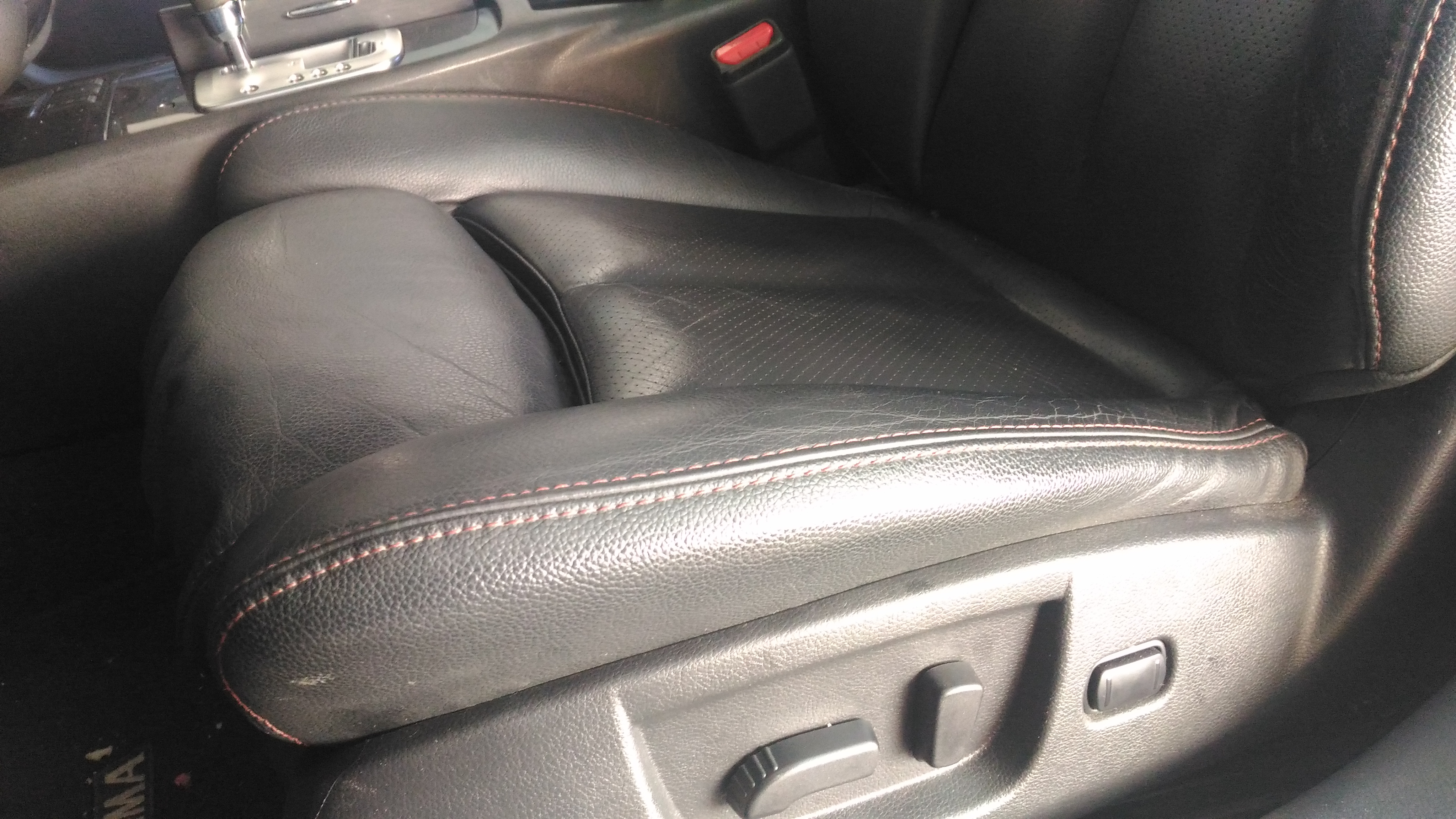

The first part might be more relevant on the rogue forums as they only have a 6 way seat recliner and the bloody pillow is way too puffy as mention above but I will post it here. Basically what I did was create a DIY upholstering edit removed the stuff and put in something lower. I then squeezed in all the left over material into the top... you could glue gun if needed - as when you put it back in to sell the car you can peel everything off, and none of it is on the outside. I haven't done that yet because I wanted to see if the edit even worked. and to be honest I finally feel like I am not making love to my steering wheel because of how close I have to be to get my knee to clear the pillow. I am 5'7" but I guess I have shorter legs then most?! Also since my legs were a little shorter I kept hitting the edge of the pillow (like my calf against the pull out handle side). Anyway here are the pics I know its a little sloppy but im comfortable now so I couldn't care less.
And also the video for the 90 degree bracket I wedged on each side and where I put it depending on your seat height you may need try a few before you get the right wedge, do it on both sides to equalize and boom you are done.
