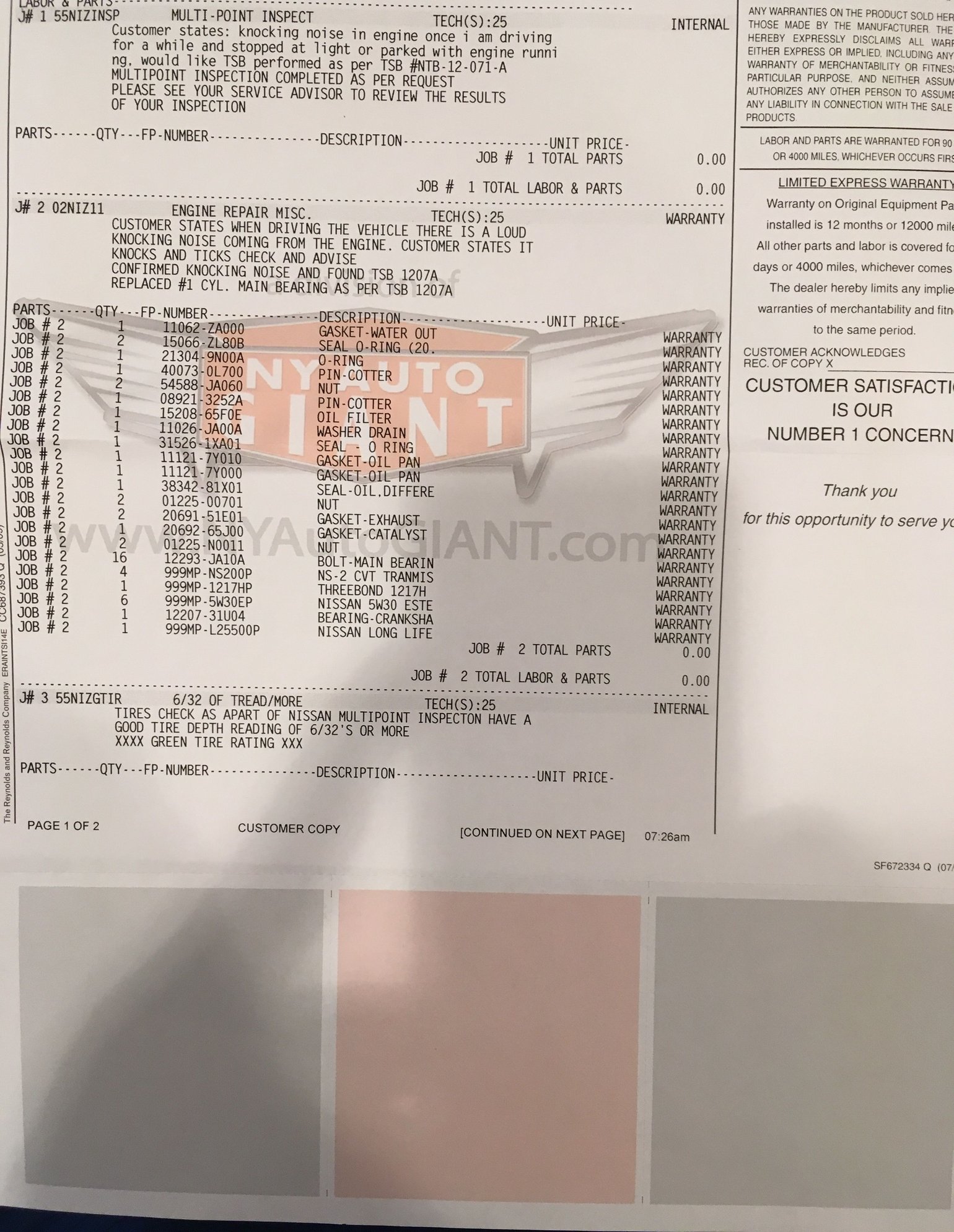

I just had **** replaced for this reason, they gave me a loaner, car had 56k miles on it. So far it sounds normal after all the work, they had it for a few days
heres the work order from the job.
It seems the hotter the engine the louder the knocking sound. Do you remember how long it took them to complete it. Can you feel a difference in the engine performance and was it a break in period?
Thanks for the invoice again, they are doing the same thing and I should have it back Monday. I inquired why wasn't anything sent out pertaining to the knocking? "They only fix once the complaint come in", and they gave me a rental and the additional 12,000 mile warranty. Thanks again
