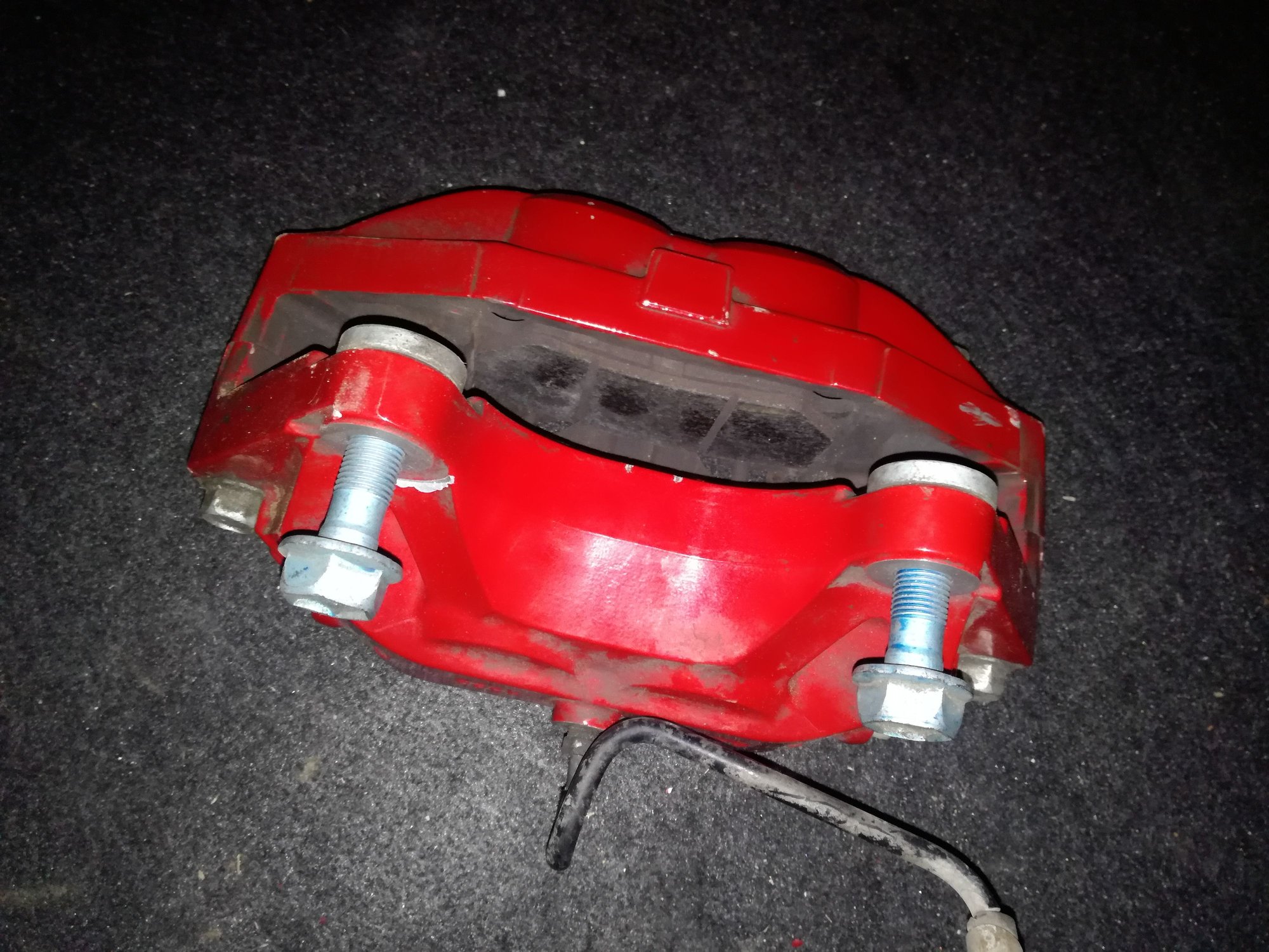

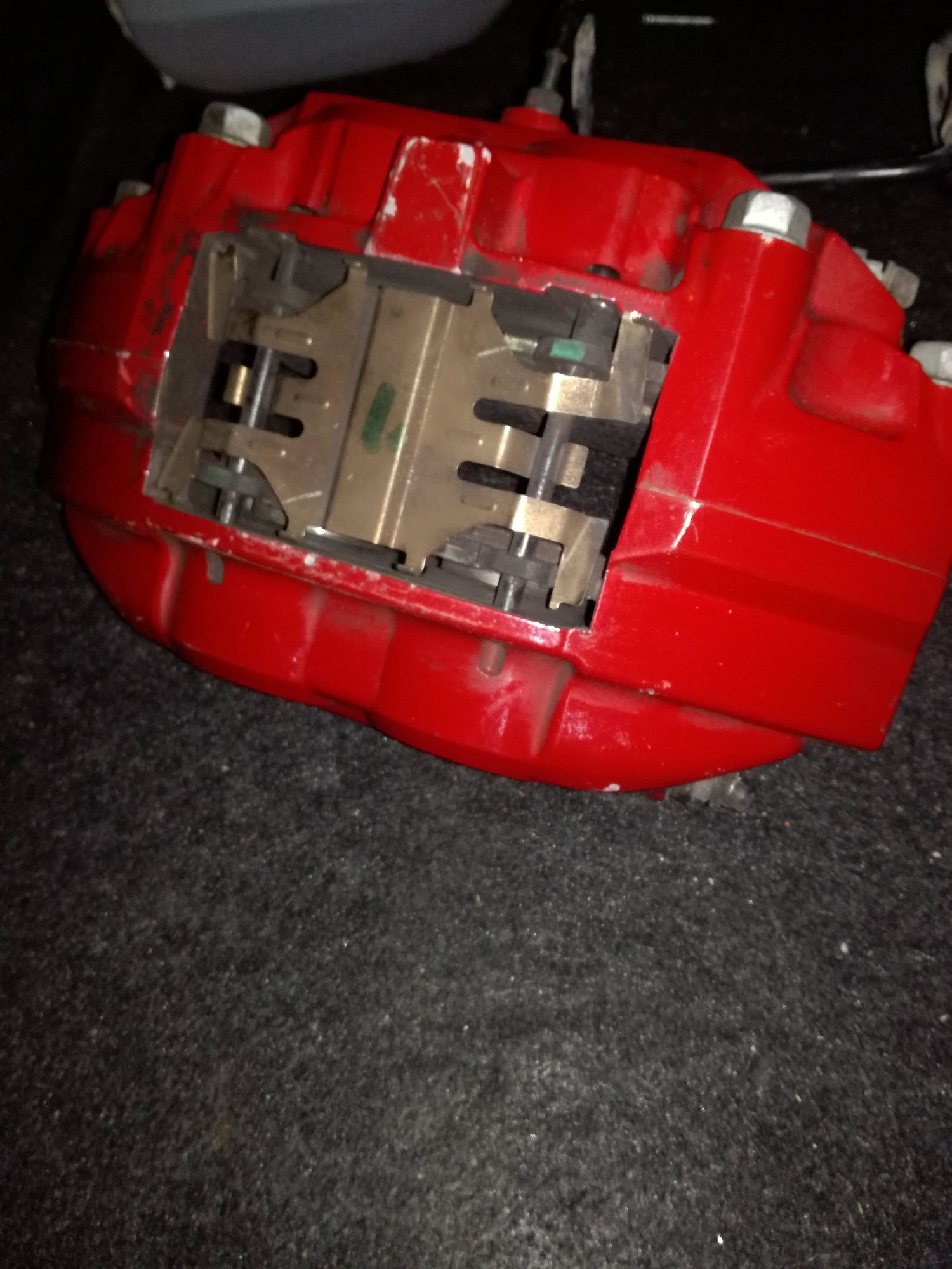

Hi guys
I got the brakes from 370z 2014. run about 55 miles.
Please look at the picture if it needs to be rebuilt or something.
sorry if the photos are not clear
Here is what I am going to do next:
Buy these rotors:
Z1 (Sport) Performance Brake Rotors - Akebono slotted
https://www.z1motorsports.com/z1-pro...no-p-4517.html
Pads:
Centric Posi Quiet Brake Pads (Sport) Akebono
https://www.z1motorsports.com/brakes...ds-p-3975.html
4 Brake Line Banjo Bolt
https://www.z1motorsports.com/brakes...lt-p-8488.html
That is all.
Do I need to buy special brake fluid? I would be stuck with the factory fluid if I can. DOT3
Painting:
I really like the factory color ( gray) its code is K51 but need your advice how to paint it which product is the best.
Thank you guys for your usual support.
