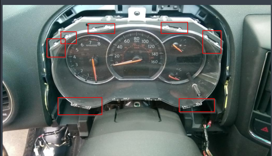

There are little clips all around the plastic. Can probably just take it apart and clean it really well:

It does look like it's just a really crappy tint job on it.. why someone did that in the first place is beyond me. But like others said just buy the lens and swap that instead of wasting money on an entire cluster.

Thanks alot for your advice guys, So today i went out and bought a de greaser and sprayed the lens. All of a sudden when the plastic was wet/soaked all the marks disappeared and it was as if it never existed. But the moment it dried all the spots came back. So now i know that the crap is actually on the outside instead of on the backside but now im even more confused. Why do the marks go away when it is wet and come back when the surface is dry?

This seems like a clear indication of chemical etching. Whoever was the previous owner must have used a caustic chemical to clean the dash and it melted/etched the clear plastic lens in the process. Why it melted just the clear lens and not the surrounding area.....beats me. It disappears when wet in the same way the headlights will turn really clear during the wetsanding process of restoration. I'm not a chemist but the water is basically filling in the imperfections and causes them to look clear. You could try a microfiber towel and some plastix X and see if you can buff out the spots.
