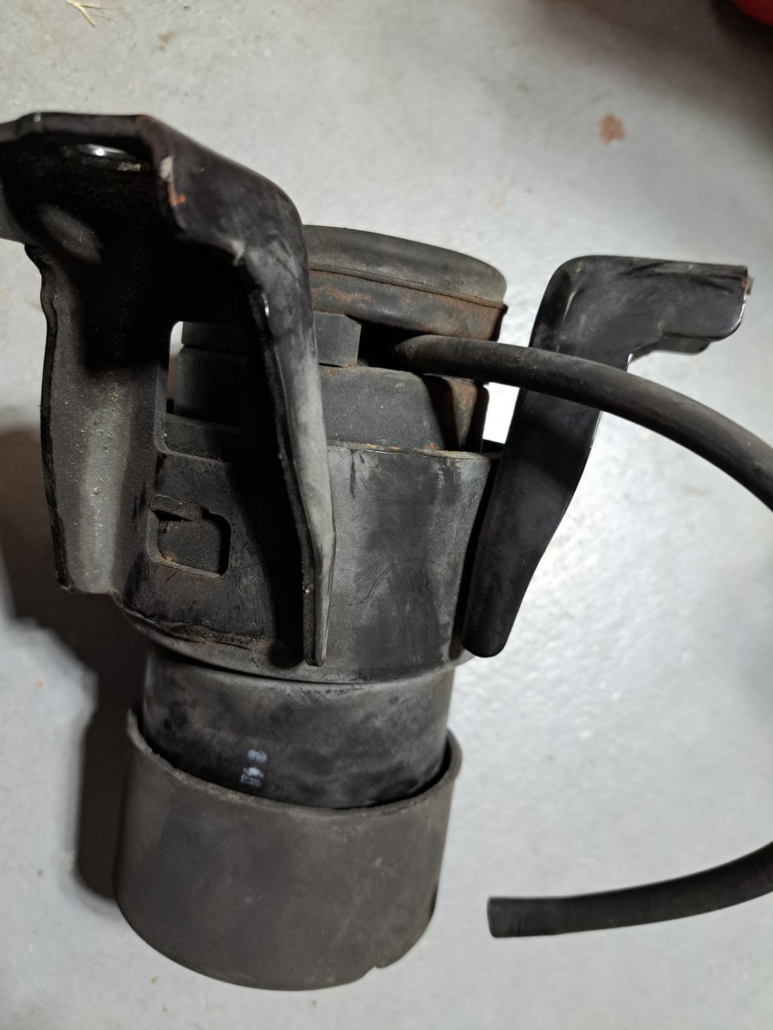

Old Feb 28, 2023 | 06:51 AM
LtLeary's Avatar
Posts: 1,847
From: Central Florida
Here is my old front mount. The hose disappears inside and I couldnt feel a nipple
Old Feb 28, 2023 | 12:35 PM
Matt2090's Avatar
Joined: Feb 2023
Posts: 8
Well today was awesome weather and I was able to inspect. My rear passenger torque mount wasn’t terrible but I went ahead and replaced it since I had it ordered. I checked the vacuum lines and all seemed okay. No major wear apparent. However I had my girl get in and put car in drive and reverse and noticed a good 3/4”-1” movement coming from the upper passenger engine mount by the coolant tank. Mount is ordered and will be swapping it out. I decided to go forth with getting parts from store for warranty purposes rather than ordering online. Also when I placed the jack underneath the car prior to removing the torque mount, I went ahead and gave it a few pumps and there is definitely excessive movement from the mount I am about to replace. Amazing what a bad motor mount will do to a car. When all is done, I’ll post an update. Thanks everyone for the tips and pictures. I also hope that for those who experience similar issues, this forum helps.
