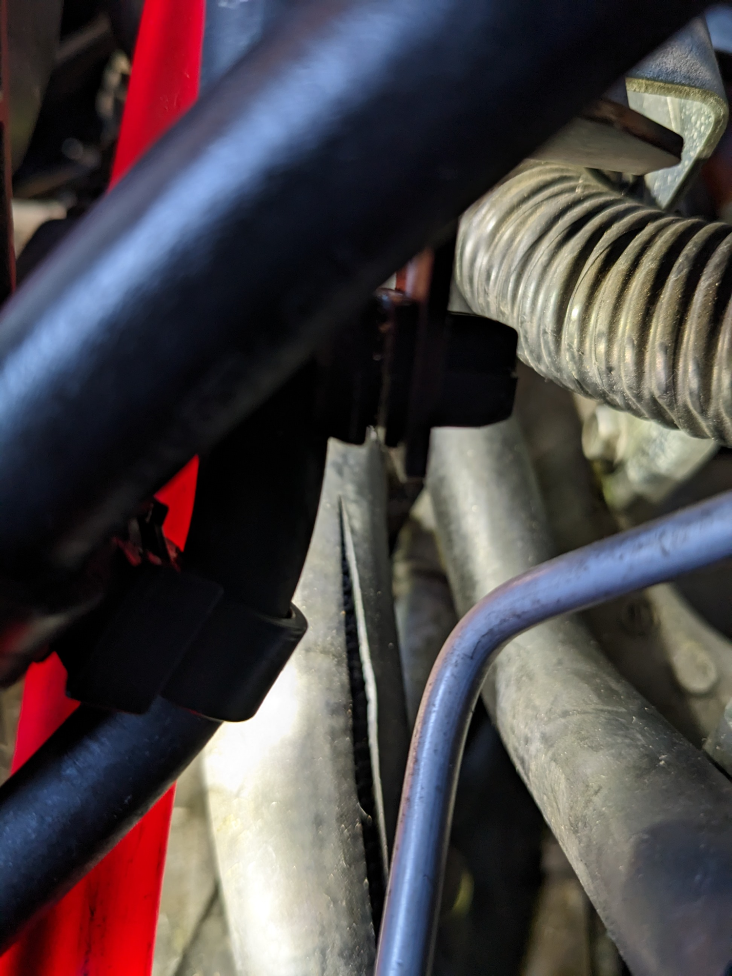

After further inspection it wasn't either of the hoses that you replaced (I looked at your post to see if there were pictures, and of course there were). But lo and behold, right next to those was this big sucker with a big fat gash in it. If this isn't the one that's leaking, I give up. It's apparently one of the ones that goes into the heater core. I'm going to order one tonight and I'll post back with the result.

Well, i am with you on that hose! I can say I have ever seen a hose split like that. Hopefully, the extra over-engineered VQ and management systems Nissan deployed on our Maximas limited the damage to inconvience only.
