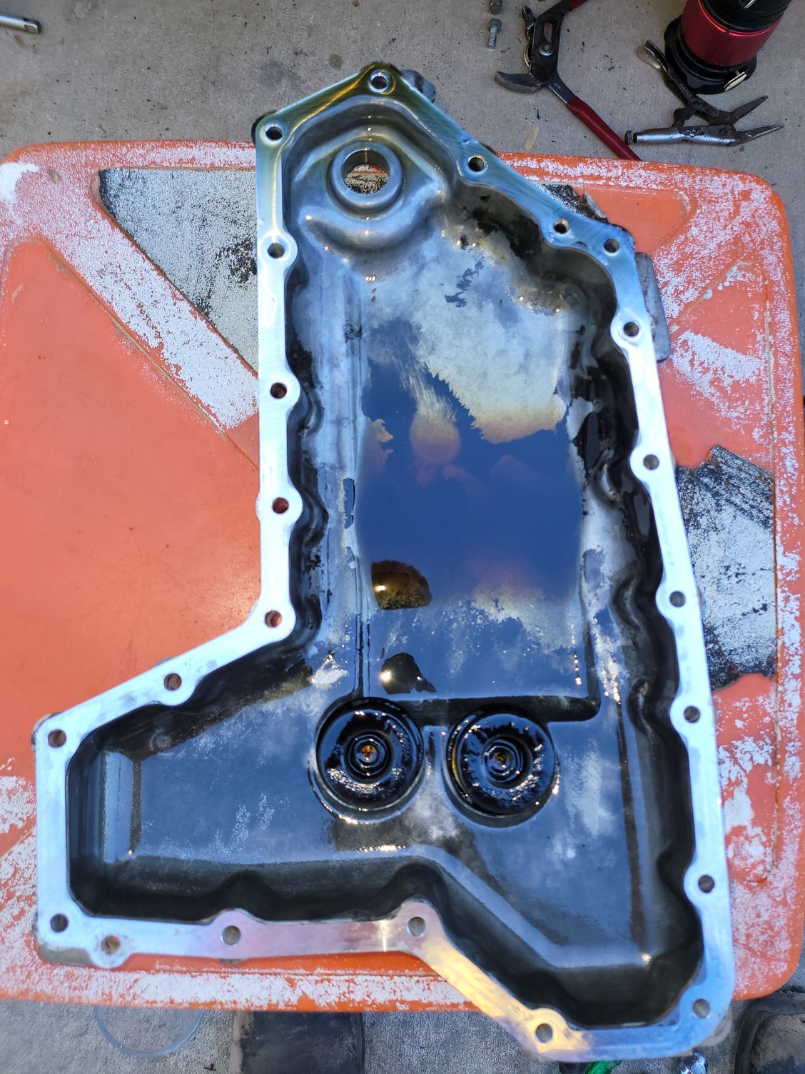

Close up of black sludge around pan magnets. Fitted new external filter and have cleaned pan out. Also removed and cleaned valve body strainer and refitted. I will remove once again when pan gasket turns up. Will also put my 3rd 4 litre tin of NS-3 tranny fluid through it after changing gasket. Original gasket looks good for multiple pan removals so $60 new gasket will only be used at final clean and replacement. Anyone know the torque settings for valve body strainer bolts and pan?
Pics for those interested. Black sludge in pan after pan removal.

The pan is 8.1nm or 72 inch lbs. Not seeing the strainer torque specs.
