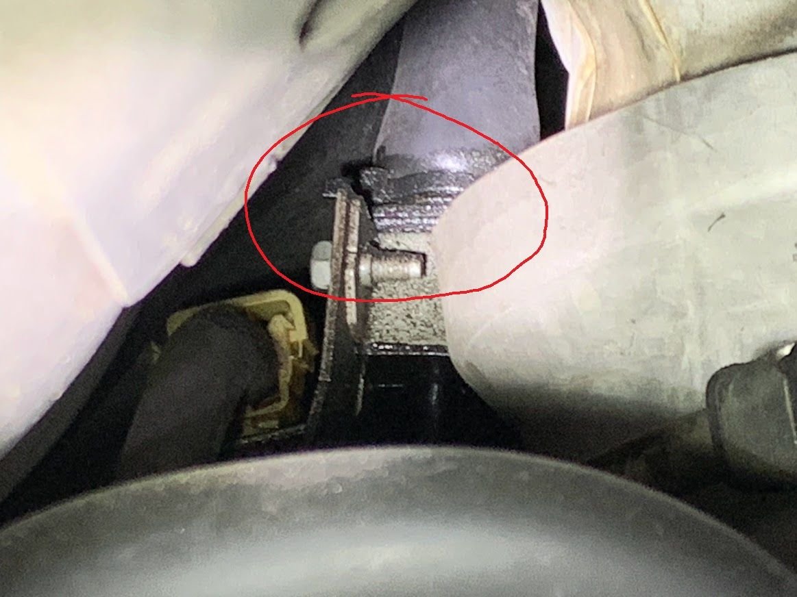

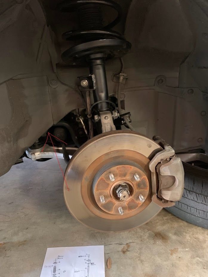

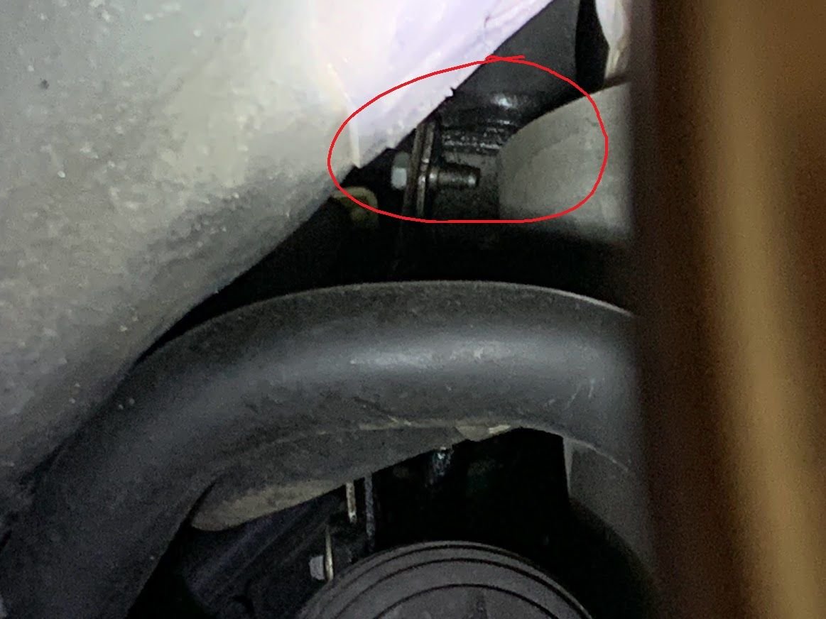

I replaced front struct and rear shock today and found a hose connector is leaking. Can anybody help me identify what it is? engine oil hose? Any comments will be appreciated.

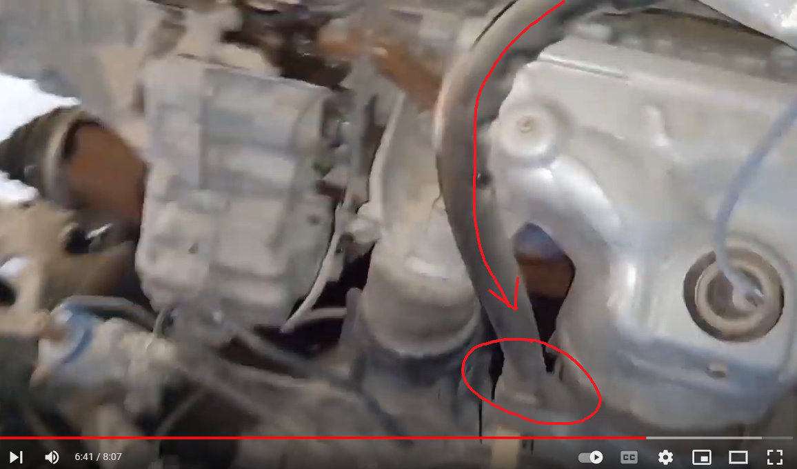

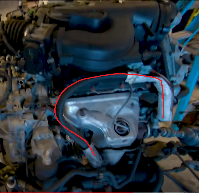

I compared it to youtube videos, and here is that hose. what is that?

I know absolutely nothing about the 7th generation but based on the fittings and shielding shown in those still shots, I’m saying that’s a power steering line.
On your car, wipe the wet area with a clean white paper towel.
What color is the residue?

Thanks. color is black, I guess it makes sense now. It was leaking slowly.
