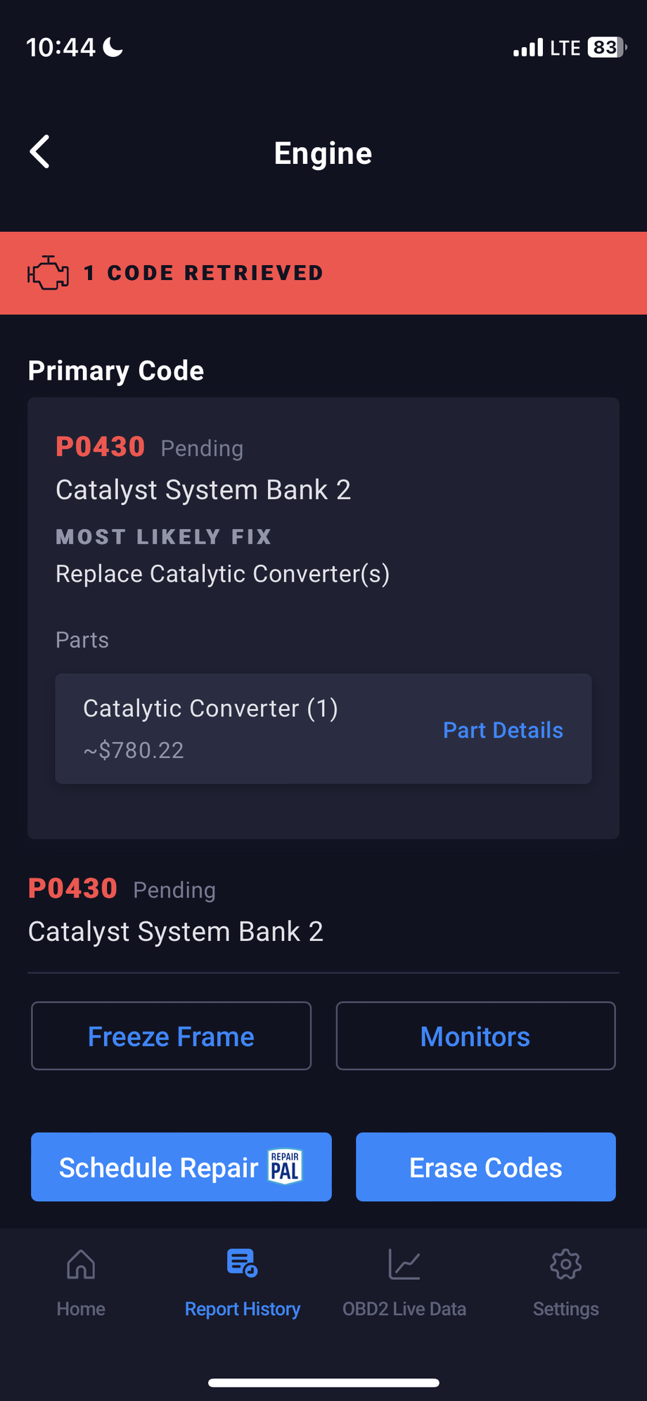

Keep driving it. Try to do loads like hills and hold when it's misfiring. About 99% you are going to get a cly misfire code, check engine. Likely coil and/or plugs. It takes like 50 - 100+ miles for these to finally code. Hold the misfire during, load may speed up the code for you to know which.
The O2 sensor would be the easiest to replace 1st. Before I replaced I would try a can of Lacquer thinner to a Tank of gas take for a long 30mins to 1 hour drive, and run it out. ppl will say this, and that about it but if it is a light that just coded and the Cat are just starting it may work. After the thinner if the code does not go away I would replace the O2 sensors next. If thinner nor Sensors, work it's the Cats.
