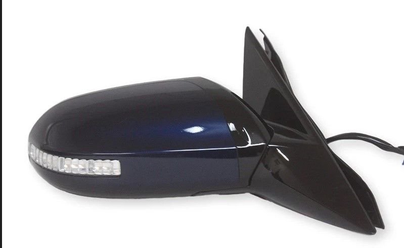

Need to replace both but can't find the part numbers anywhere. Web search has been fruitless, RockAuto doesn't list them, and my local dealership's service department isn't very reliable.
Need your help for the correct part numbers and any good supply sources. Not looking to spend a bunch of money on these because there be bigger fish to fry (think: driver's seat climate control is kaput; could be a filter or the TED).

If you just want the led strips the ones from altimas work on our 7th gens.
NISSAN 26442ZX50A - Passenger side
NISSAN 26443ZX50A - Drivers side
there are a few posts on how to replace them on this forum.
