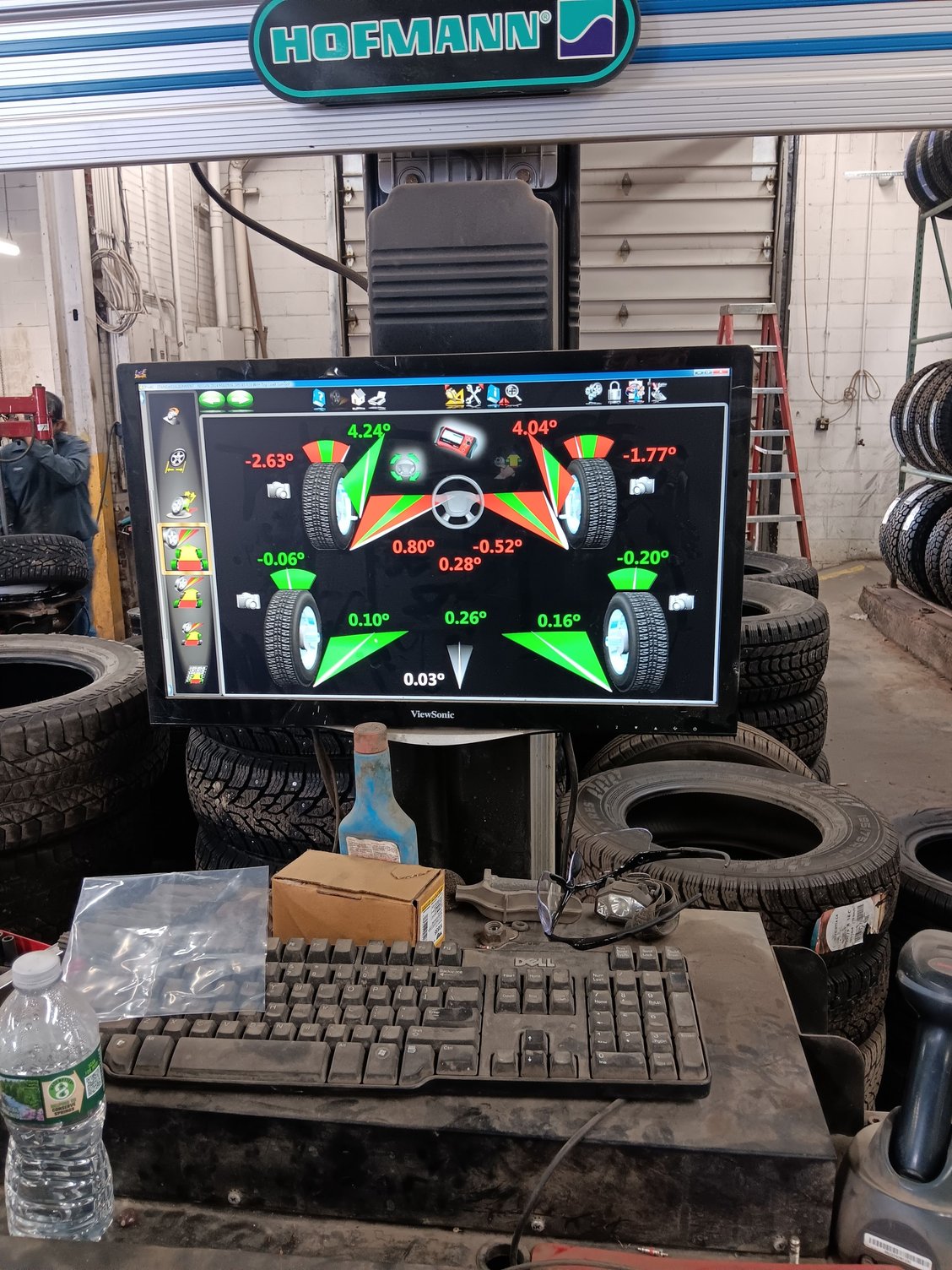

2014 Maxima SV with 89k miles. Replaced the front struts from 1A Auto. took to alignment shop and they are unable to adjust the front
Could I have installed them on the opposite side? Shop thinks they need to be "slotted" to adjust the camber but the new ones are not.. The brake line brackets connected right up so I never gave it a thought that they could be on opposite side. I didn't even think that was possible. 1A says they are the correct per P/N of course and I already tossed the old ones. Pic is attached
Any help would be great.
Larry

More than strut itself, your strut spring is worn.

I should have included that I replaced the strut and spring as an assembly

Does they adjusted angle on top strut mount?

No Clue. I did notice as soon as he started to jack the front up while on the bed, all the numbers came in nicely. Maybe the springs on the struts from 1A Auto are weak or not correct. there are zero tire wear issues. I had a bad shock on rear left that cupped a tire so I figured I would change every thing here I am with alignment issue nd front vibration.. ERRR. new camber bolts were also installed by alignment shop

Check and or replace the Lower control arms…

thanks for the advice. weird is that when the new tires were installed 1.5 yrs ago we had an alignment and all was good. and now with 7k miles on tires there are zero signs of abnormal tire wear on the front. and both side cambers are negative on the camber. I will be replacing the front stutts with a replacement pair and will be looking closely comparing the newly installed ones with the replacement ones coming this week and I will look at the control arms and bushings good.
