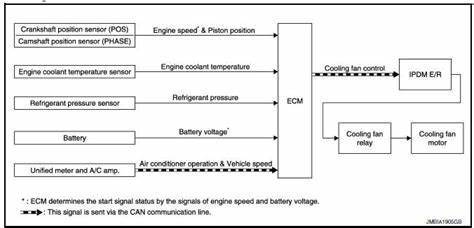

Isn't there a fan control module somewhere on my 2014 Maxima?
Question is. Where is it located on my car ?

As you can see, the ECM actually controls the FAN via the relays. If you have doubts, use a power probe and apply voltage directly to the fan motor. You can Test, don't just shoot parts although I can say I have had two fan replacements on my 09 in the almost 500k I owned it which is what leads me to believe it is bad fans.
