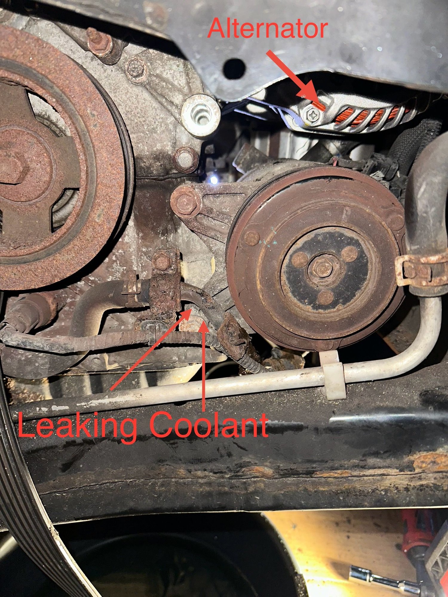

Hello we replaced the alternator on my son’s 2013 Maxima. While replacing and moving things around. We noticed this metal connector to be badly rusted and now leaking. Looks like coolant, does anyone know what this connector is called?
Picture from Passenger side wheel well.

Super common, it's a coolant line for the oil cooler.
https://www.nissanpartsdeal.com/part...053-ja13a.html
