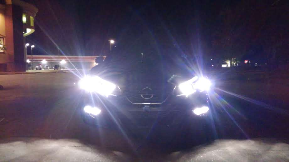

Originally Posted by ChiefsKnicksWVU
Ok so the results are in.... and not good.
Condensation in the fog lights on both sides. ...
LED lamps have an advantage over HID or Incandescent - an advantage that in a fog lamp of an 8th Generation Maxima turns out to be a huge disadvantage - Heat Output.
The Fog Lamp assembly on the 8th Generation Maxima is equipped with a vent at the rear of the light. When equipped with the HID lamps, heat from the lamps vaporize the condensation inside the lamp assembly and heat expansion expels the heated, and now vaporized, condensation through the vent. Every time the fog lamps are turned on, this cycle repeats, and the fog lamp assemblies remain clear due to this process.
When the Fog Lamp Assemblies are equipped with cool (temp-wise) LED lamps, this process fails, and the humid air remains inside the fog lamp assembly to appear on your lenses as condensation, and cause the owner grief. So many times I used a hair dryer after removing my LED lamps to dry the assembles, replaced the LED lamps' gasket with the gasket from the original HID Lamps, tried various other ways to seal the gaskets against the Lamp assembly, all to no avail.
So, I changed tactics -
At this time, my Maxima is equipped with H16 12V 19W HID lamps, same as the original manufacturer's equipment, with one slight difference: light color is 5000K (Bright White). The day I replaced the lamps, condensation appeared on the lenses, but only till I turned my lights on and drove for a while. When I shut off the car, I placed my hand on the lenses and they were hot to the touch. I could see the condensation actually shrink in area till about a couple of hours later it had totally cleared up. The light assemblies have since remained absolutely clear. No doubt, now I have white light to match my LED Headlights, but absolutely no issues with condensation. I am totally satisfied and pleased with the results.
Here is a link to the fog lamps I used:
https://www.ebay.com/itm/Halogen-H16....c100677.m4598
Hope this sheds some light (apologies for the pun) and helps all of you out there in your quest to prevent condensation, while improving the color, of your 8th Generation Maxima's Fog Lamps...

I decided to take my Max back to the 90's Japan style fog lights
Here I have my 17' SL .....with the now 6k LED headlights and 3k yellow fog lights. I love the look and I even turn them on during the day. I ordered the "Eye of Megatron" kit off Amazon and two Alla yellow kits for the fog lamps. Instead of removing my bumper I chose and maximized entry through the wheel wells and took only 25 minutes for all six bulbs.
