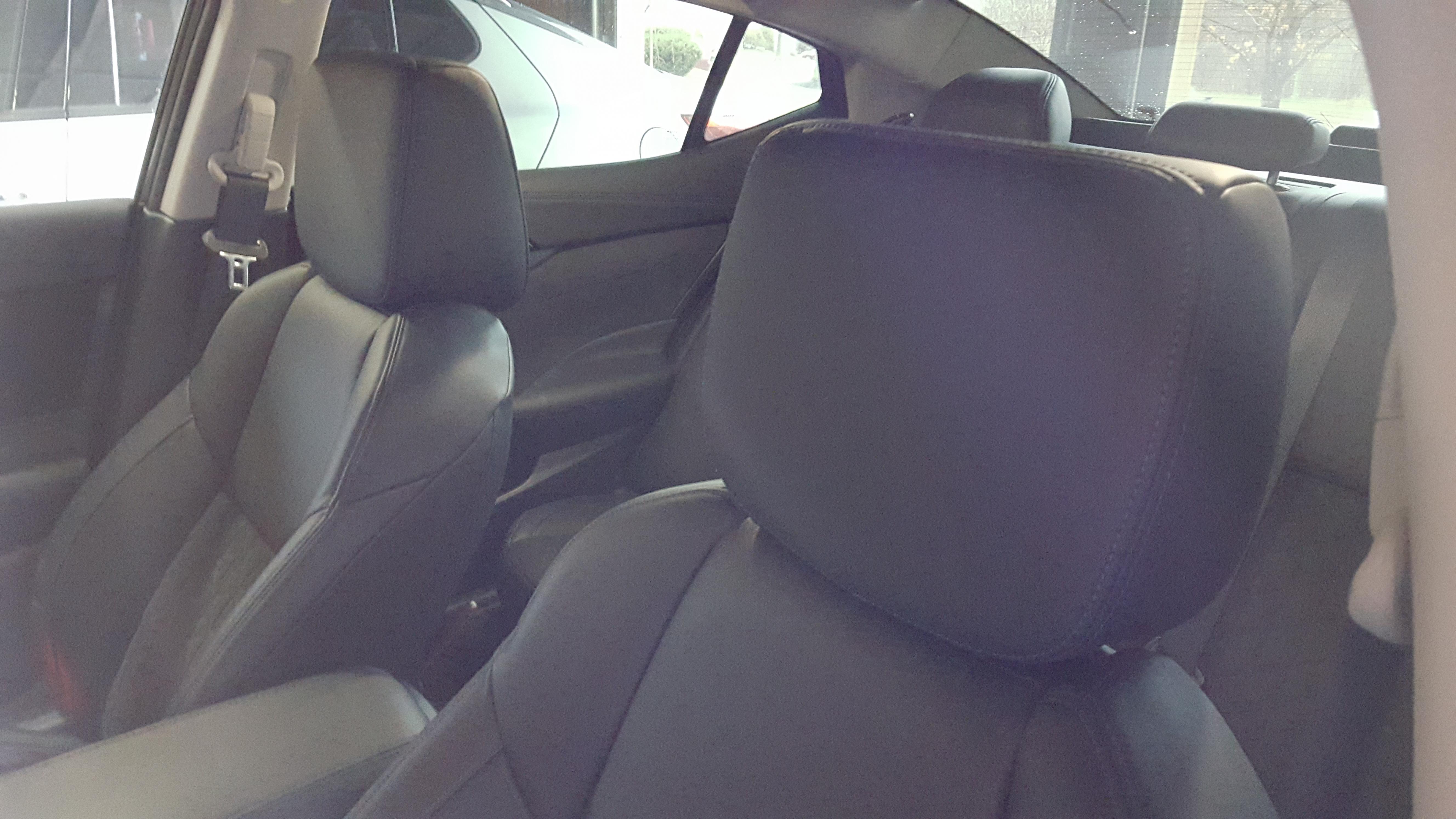

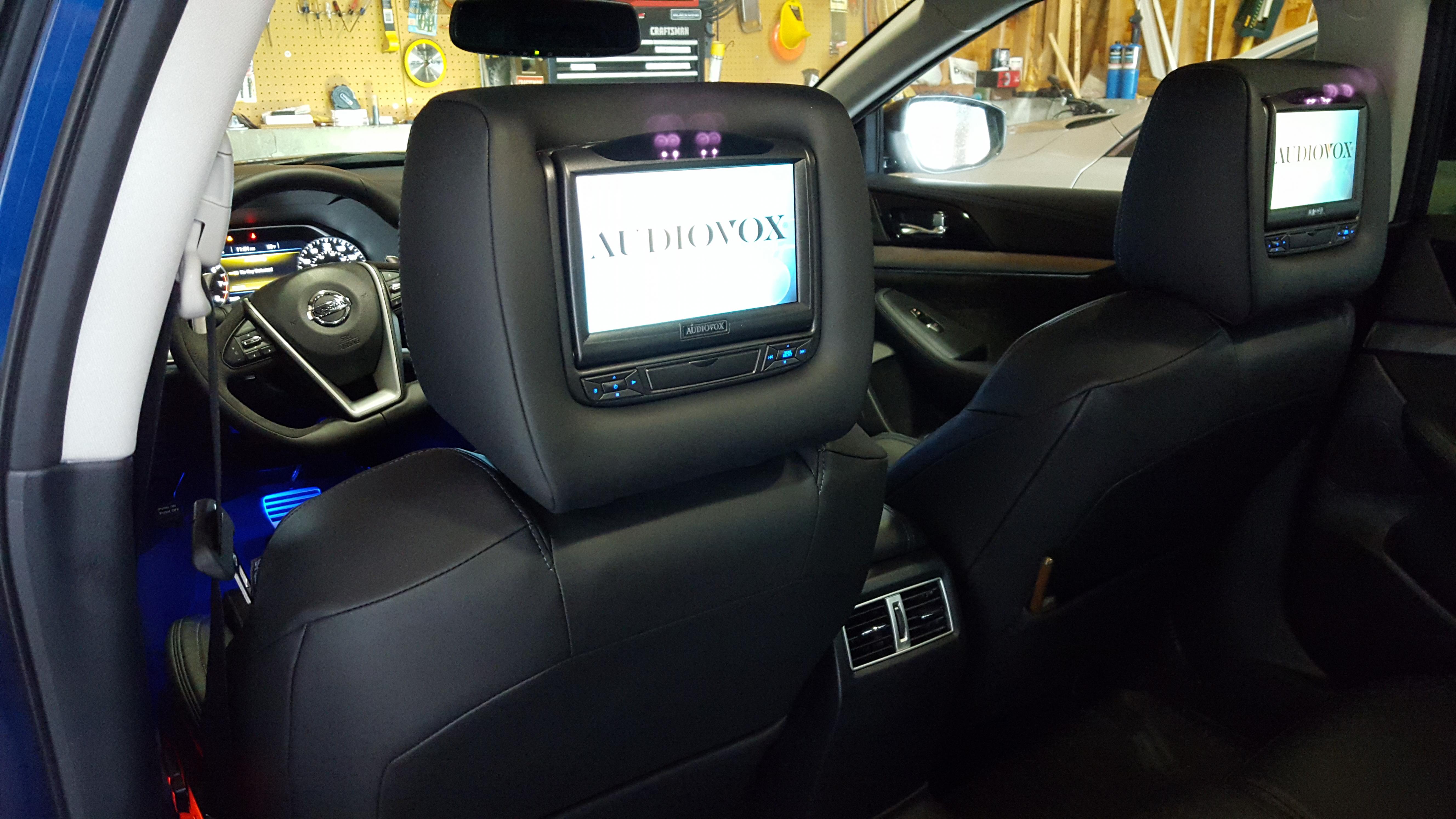

Audiovox HR7012 DVD matches the interior nicely, has the blue stitching of the SR.

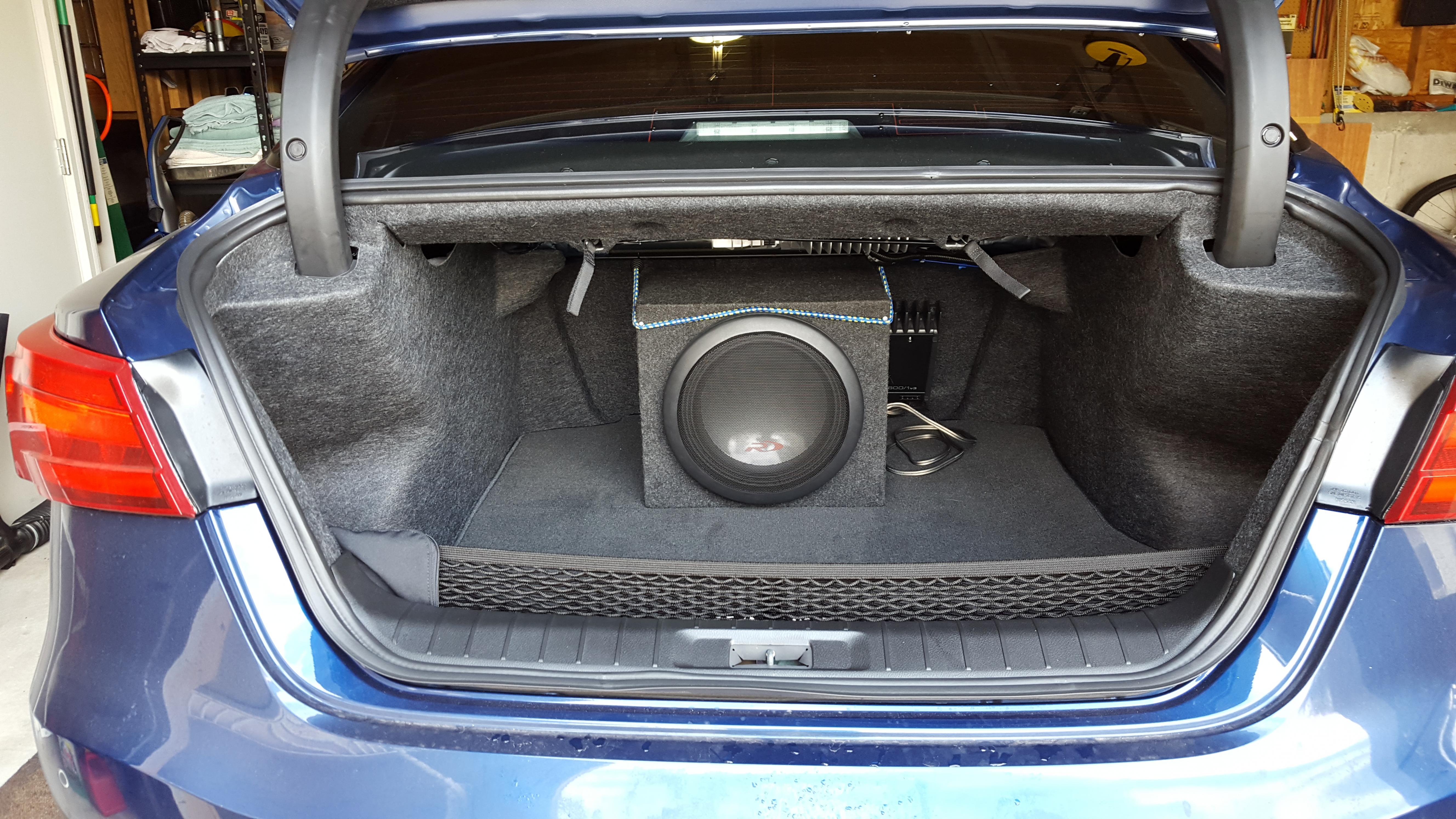

JL sub sounds awesome (JL 600/1 with a 12" Alpine Type R).
My installer (Imagine Audio - Cherry Hill, NJ) had figured out the solution for the Active Noise Cancellation. They were able to access the mic wires in the driver side A Pillar. Disconnecting one of the wires shut the ANC system off.
Kept the sub, to a simple box that can be unhooked and removed if needed within 2 minutes.
Rollin', Rollin', Rollin'.....
Attached Thumbnails DVD Headrest and Amp/Sub-20160110_105947.jpg   DVD Headrest and Amp/Sub-20160110_110125.jpg   DVD Headrest and Amp/Sub-20160110_110014.jpg   DVD Headrest and Amp/Sub-20160110_121704.jpg

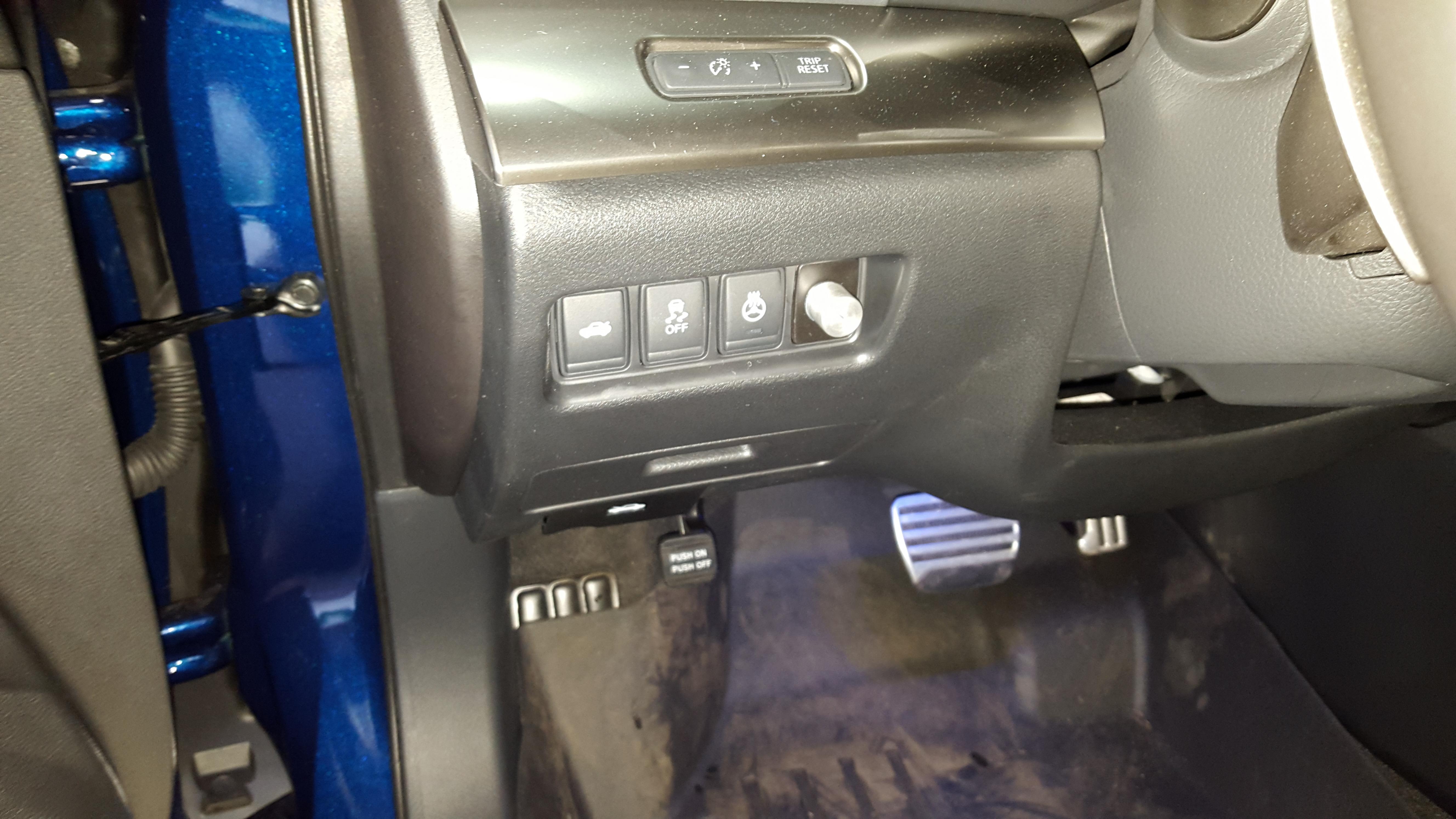

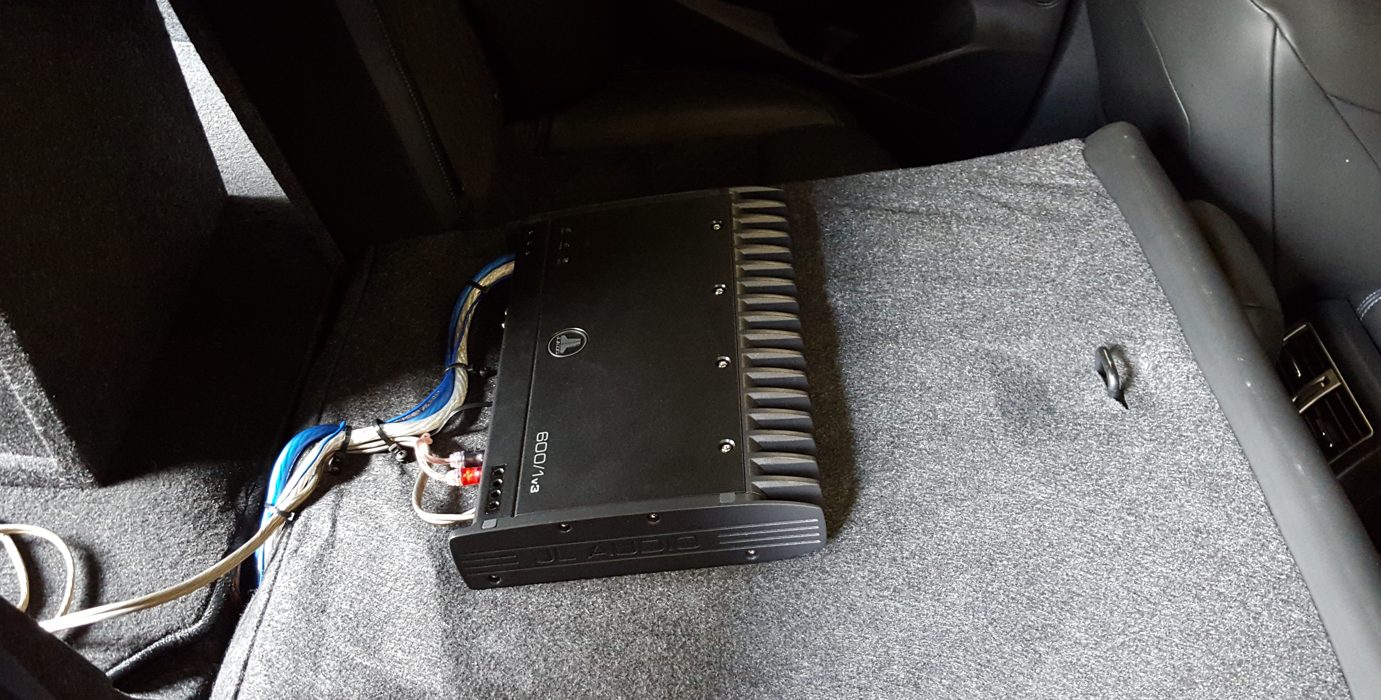

Couple more pics.
The amp is just on the passenger side seat, and the bass control **** was installed to the blank space next to the heated steering wheel button.
Attached Thumbnails DVD Headrest and Amp/Sub-20160110_121541.jpg   DVD Headrest and Amp/Sub-20160110_124112.jpg

Nice! Are the headrests independent or do they route to a control box? Did the installer have to order them custom from Audiovox?

The Headrests route to a control box, each unit can play its own disc and be listened to via wireless headphone. I have it set up where the movie can be played thru the AUX input in the center console cubby (next to the USB slots). They were custom ordered. These are 7" screens. They have 8" but not for the Maxima, yet.
The ANC tries to use the sub to cancel out unwanted noise. With after market subs, you end up getting a tremendous amount of feedback, so disabling the mics removes that problem.

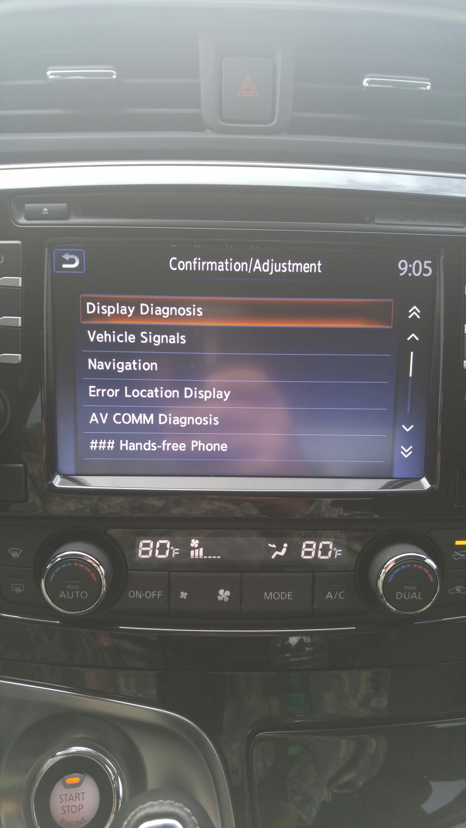

I hear you can turn of the ANC by
1) turning off audio system,
2) hold down the menu button and turn the volume button.
This brings up the secret menu where you can disable it. Don't mess with settings you don't understand though.

Screenshot of ANC options in hidden menu
Originally Posted by 16sjmax
I heard this great joke.....
A 2013 Maxima owner heard something that might be, an tells everyone NOT to mess with a setting you don't know about.
Do you even own an 8th gen?
Why are you even on here?
Turn audio off<br/>Hold menu button while turning volume **** quickly. Choose second option<br/>Scroll down to the highlighted option
kaulana, I apologize for snapping. We had a death in the family that was unexpected, and I was trying to keep some sanity by surfing the forum. Obviously I wasn't handling it well enough. I eventually reconnected my cut wire and followed your suggestion. It does work perfectly.
Thank you.
I wish I hadn't spent so much time finding an alternative solution.
