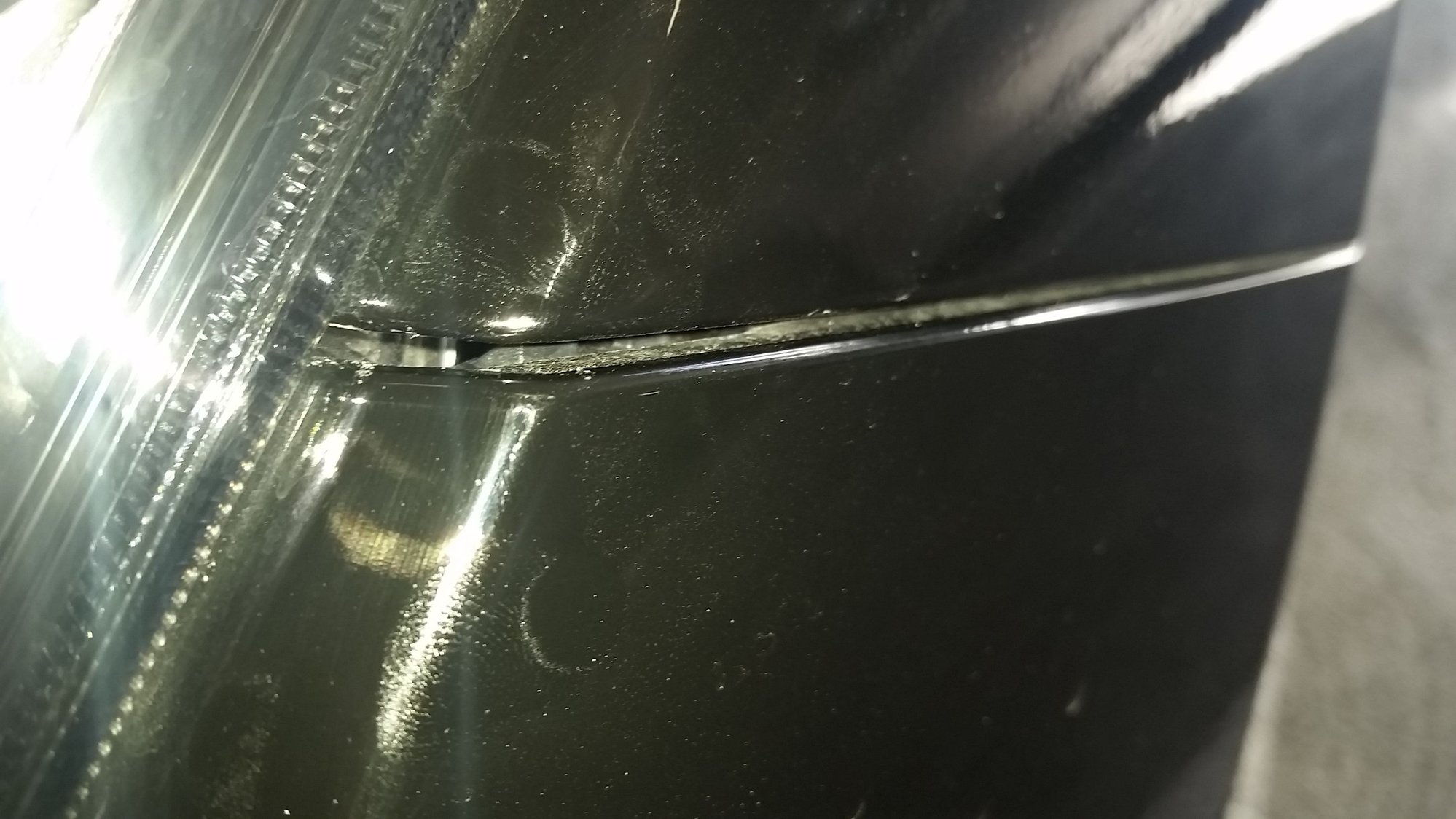

So i brought a 2016 Nissan Maxima a few months ago. I noticed there's a gap on the driver's side of the vehicle that looked weird and has been driving me crazy. It sticks out like a sore thumb. I brought the car to the dealership to take a look at it but they said there was nothing they could do about it becuase it was already aligned. I made a case with Nissan's claim division and they said the exact thing! Is it me or are they ok with this being normal?! For a $36k car, this is not quality work! Anyways, i was wondering if anyone had the same issue or if anyone had a quick solution to fixing this problem.

It looks like one of the bolts that connects the bumper to the fender underneath is either loose or missing. I just walked through the row of Maximas at my local dealership while waiting for an oil change for the Murano...and none of them had this gap.

Yes, It does look like a parking whack to me. Pulling the bumper is what I would do.

I'm not sure it's a parking accident because there aren't any scratches or dents marks from another car. Unfortunately, when i brought the car it was dark out side so i did see it. I didn't look down at the bumper until i was ready to wash my car for the first time. I never thought i needed to look down at the bumpers because the car is brand new! Anyways, When i push it in it looks ok, but after driving it (especially over uneven pavement) that part of the bumper pops out again.

Since you say it looks good after u push it in and then will pop out after driving tells me
That the bumper clips that hold it in place may be broken. See if the dealer is willing to pull the bumper cover off to see if all the clips are in good order. If not try ring it to a Body shop. Something is definitely not right with that side of the cover.
Randy

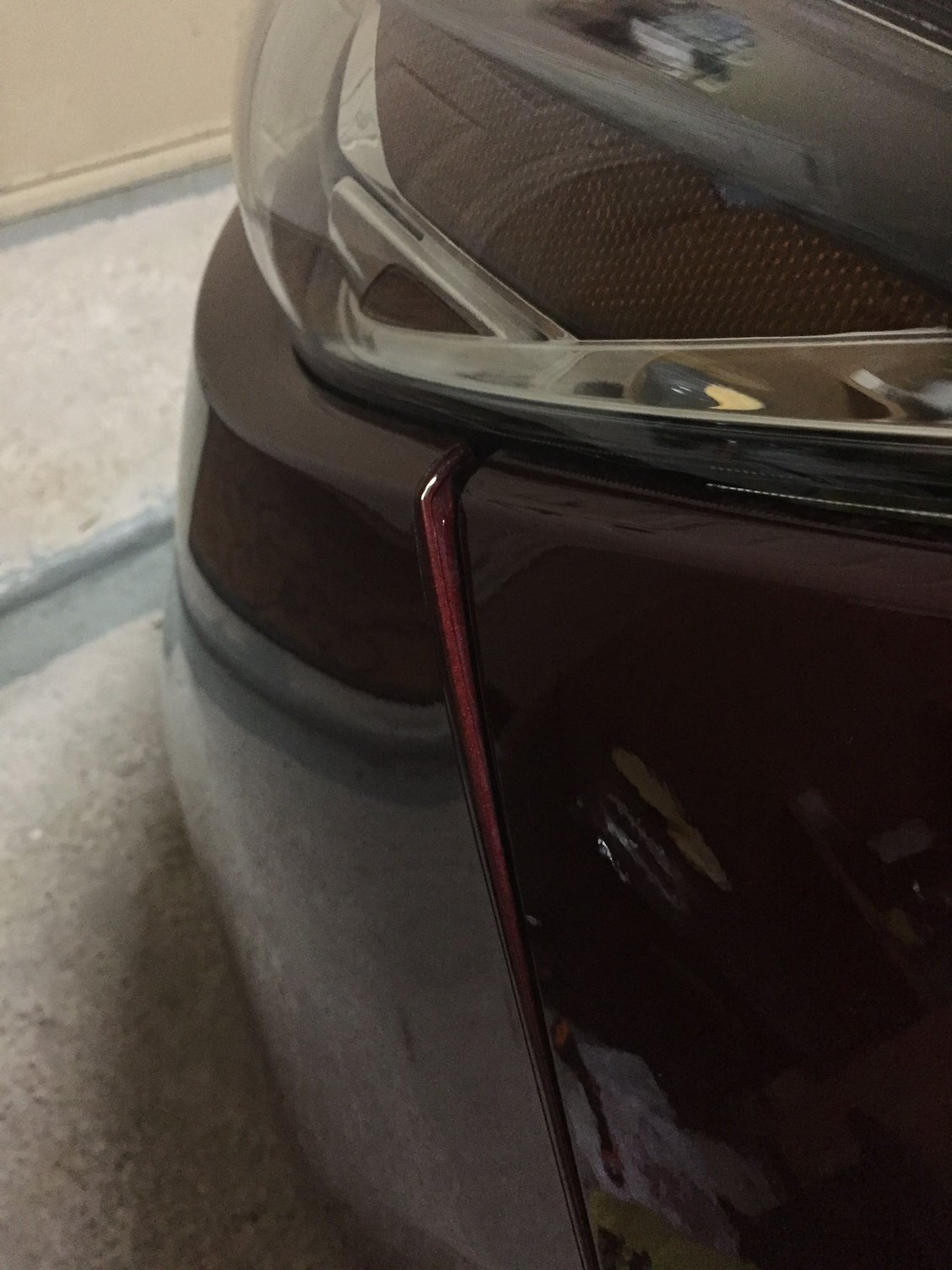

Drivers side. Had a body shop install a brand new clip and this is the day after they installed it. Faulty clips in my opinion.

Is this a before or after cuz it looks like a BEFORE shot to me.

The new tab was installed last night and this was today. The body shop said they have seen this on several of our cars (and there are not very many driving around my city). They push it in and smack the bumper to simulate driving and bumps etc. and it just pops back out.

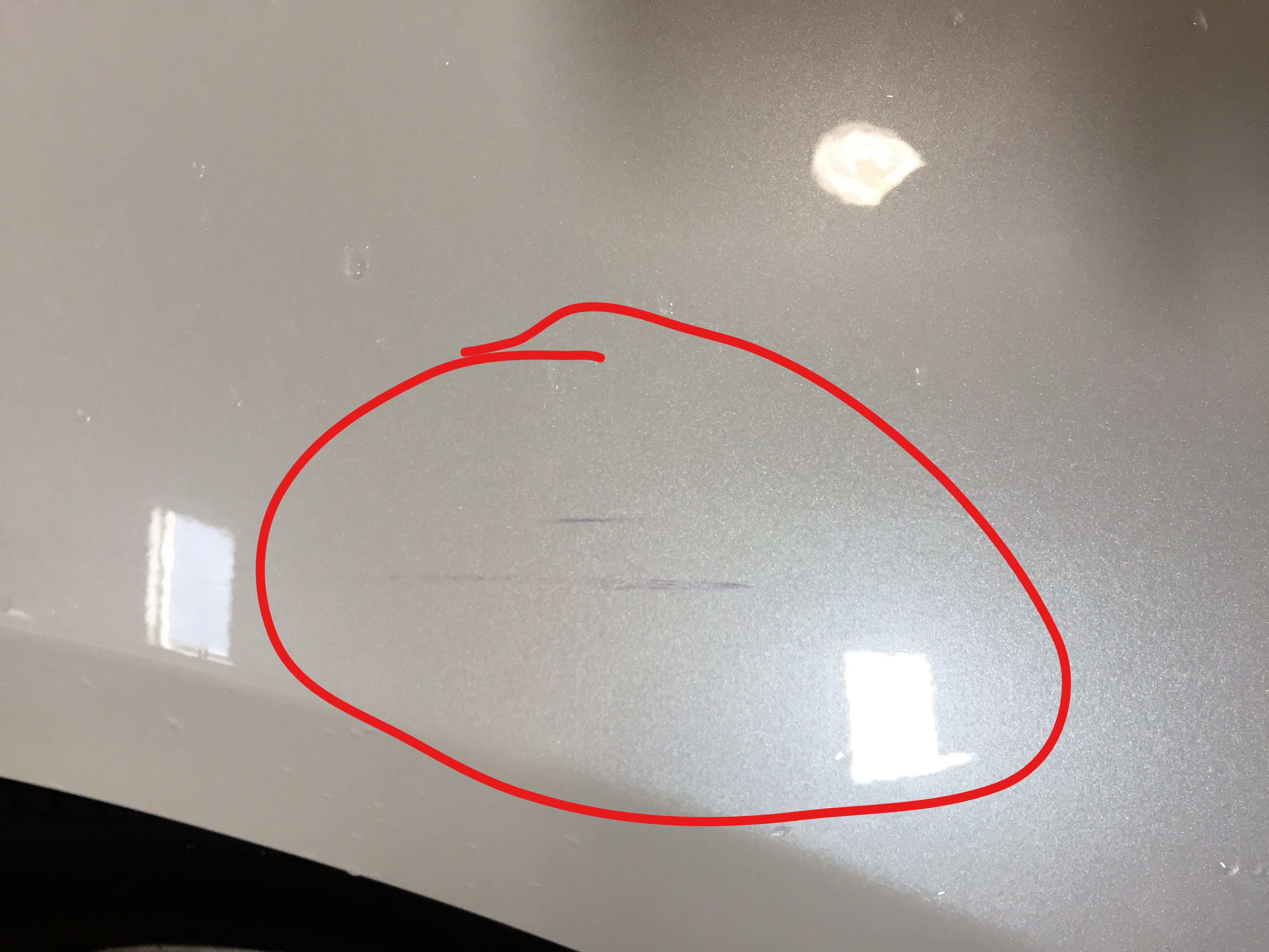

Mine pops too, on the passenger side. I took it in to the dealer, but they refused to fix it under warranty. They said it's due to impact to the fender and showed me a little purple transfer paint on the top of the fender. There's no way any other car could've hit it up there and not damage the lip of the wheel arch.... maybe my wife bumped it with a heavy purse... IDK...

Any kids with bicycles in the family?

There is a purple bike in the garage, but nobody rode that in ages.... And even if someone did, I still can't see how could the frame of the bike hit that high on the car fender...
