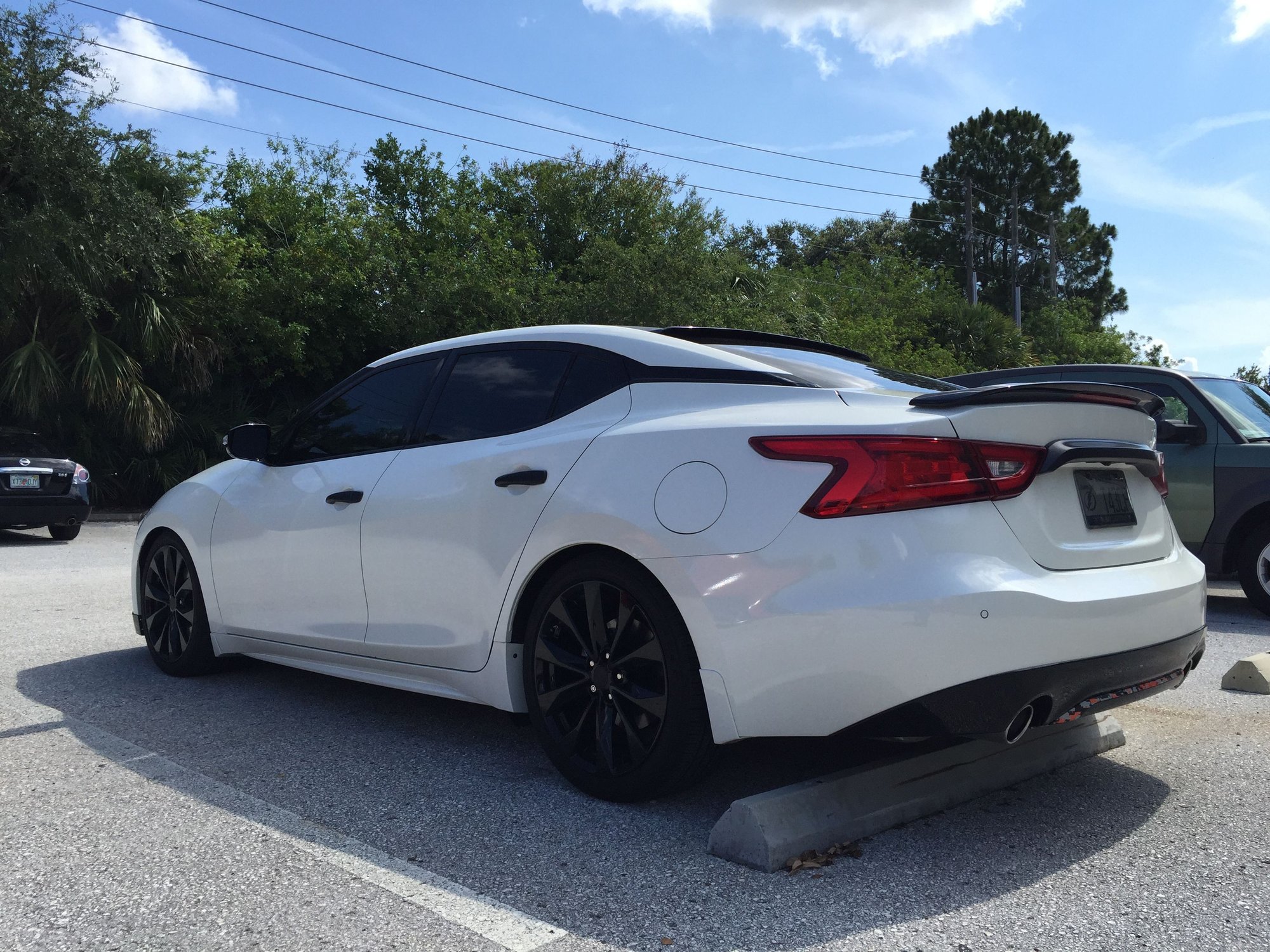

Old Apr 7, 2016 | 05:11 PM
A36-SR's Avatar
Joined: Oct 2015
Posts: 476
From: Arizona
