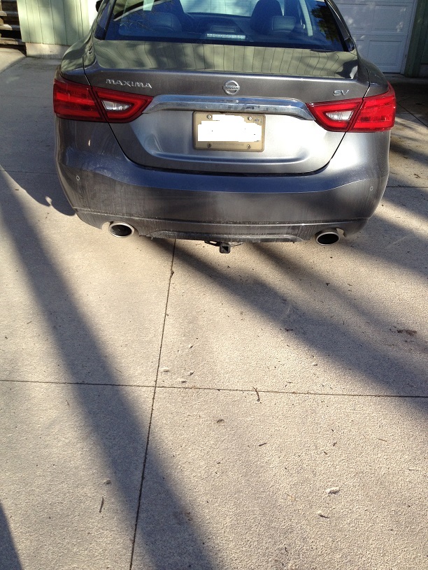

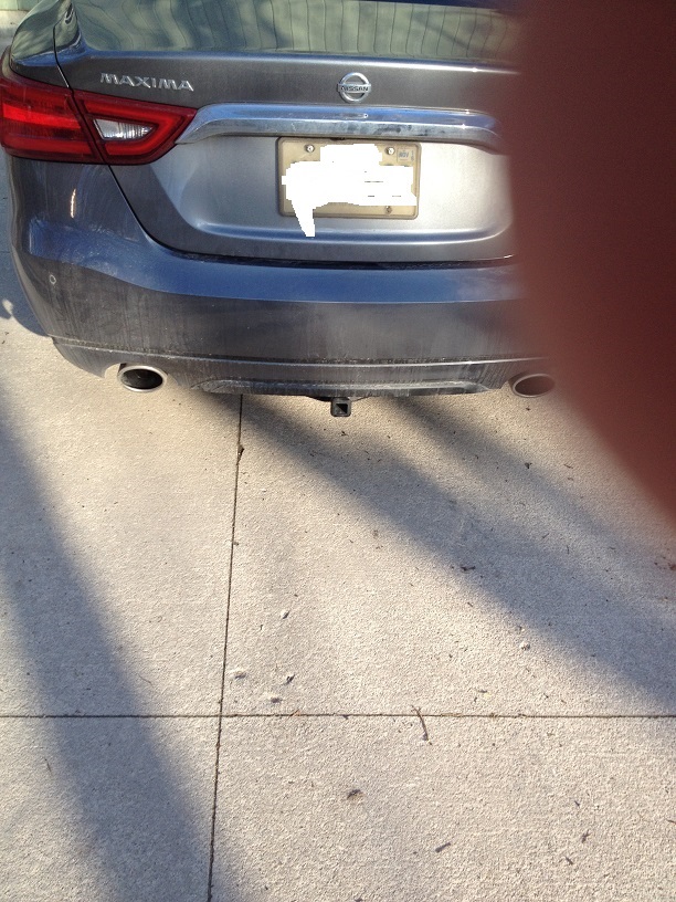

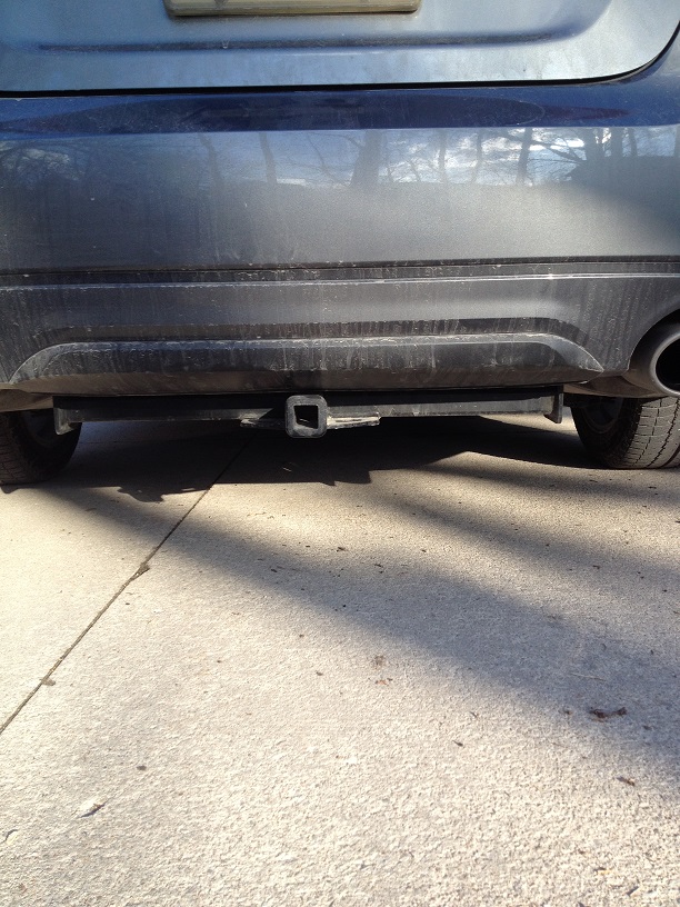

Too late to help, but for others I installed a Curt (Class 2 ... I believe) and no clearance issues

The plastic pan under the trunk needs to removed. Easy. The heat shields are history.
