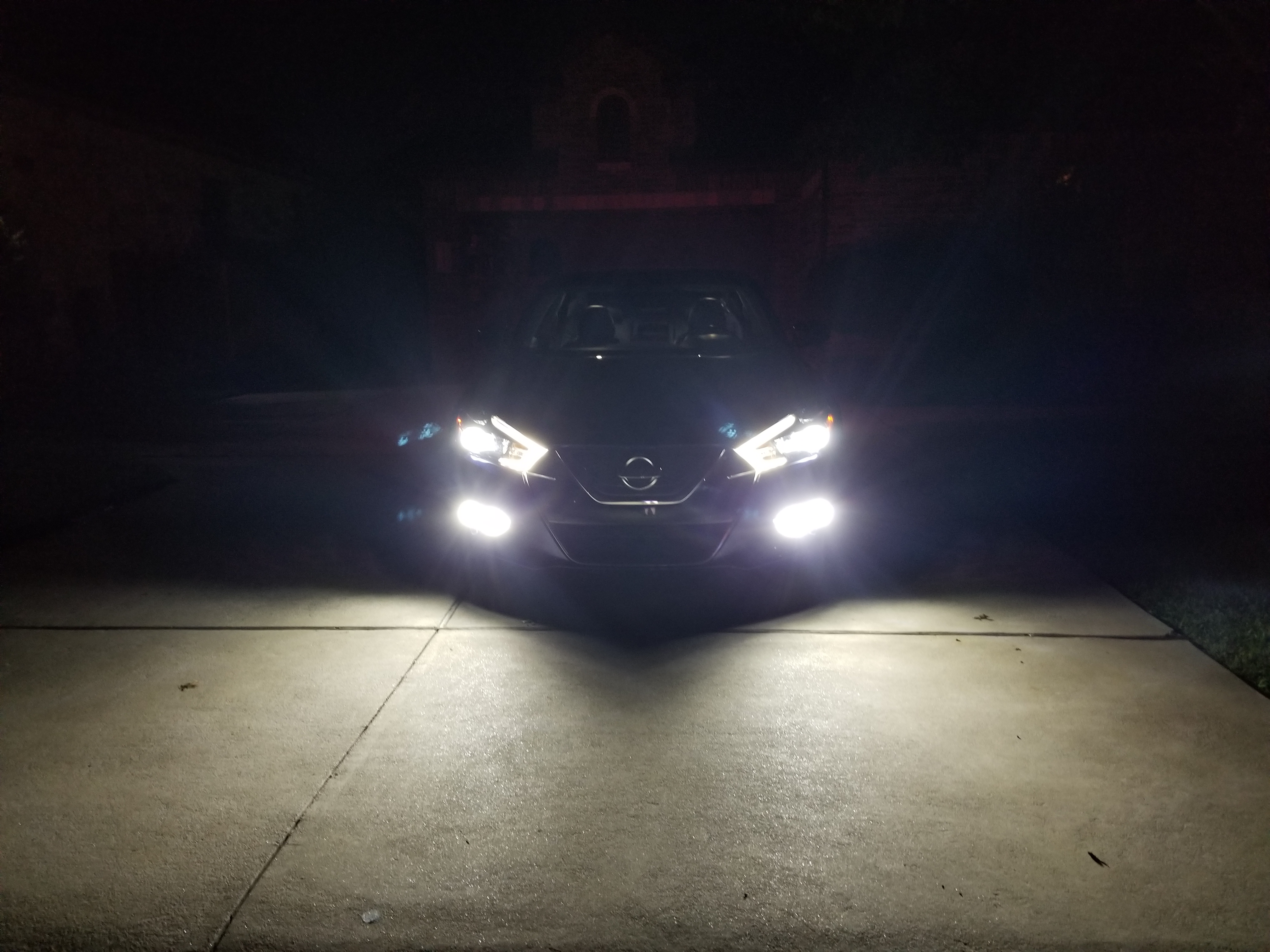

Well after finally getting my headlights replaced by the dealer, due to condensation in the assembly. I was able to install my Miramoto LED headlights low beam. I did get the replacement from XenonLEDs.com, but after such a hassle trying to get them replaced I don't want that product anymore. Here's a picture of what they look like after my buddy Quintin help me install them tonight. Below is a link to where you can get them. I feel the match my LED fog lights very well but I driving my drls look a little yellow compared to them. Still I'm very happy with them and the throw and the light pattern is excellent, very bright.
Ian B
Ian B
