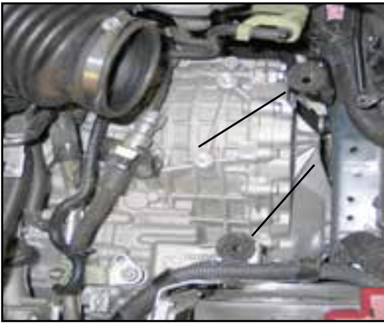

I installed the typhoon 69-70002TTK intake and at the end of the install there was a hose that isn't attached to anything. It's a small hose and it looks like it goes to the transmission. I contacted K&N and they told me to contact my dealership or a certified mechanic since they cannot suggest or diagnose what it should go to. It is shown on step 8 as a disconnect hose. It's the smaller hose in the pictures and it's squiggly. I've attached two picture, one from their installation instructions and the end that goes into my transmission. I find it hard to believe that it's not mentioned anywhere in their instructions. I installed this on my 2009 Maxima and now on my 2017.
Any thoughts?

Pretty sure it’s just a breather or overflow for the trans. It’s fine. I wire tied mine to the hose next to it so it wasn’t just dangling there. If you do the same make sure u don’t pull the wire tie tight, just enough to hold it in place

Thanks Mikeymax17 you are correct. I am at the dealership getting an oil change and he asked a mechanic and they said it was a CVT vent hose. Mine has a plastic piece that just went in a hole that was on the shield.
