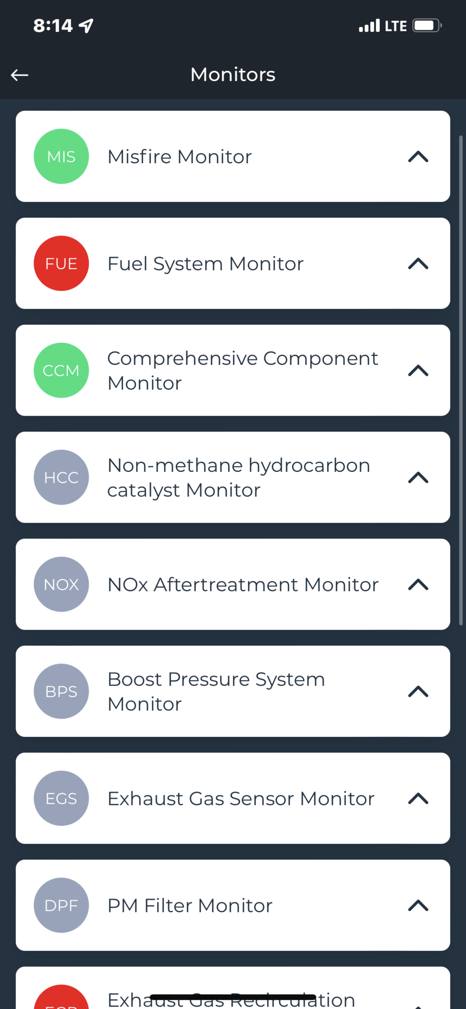

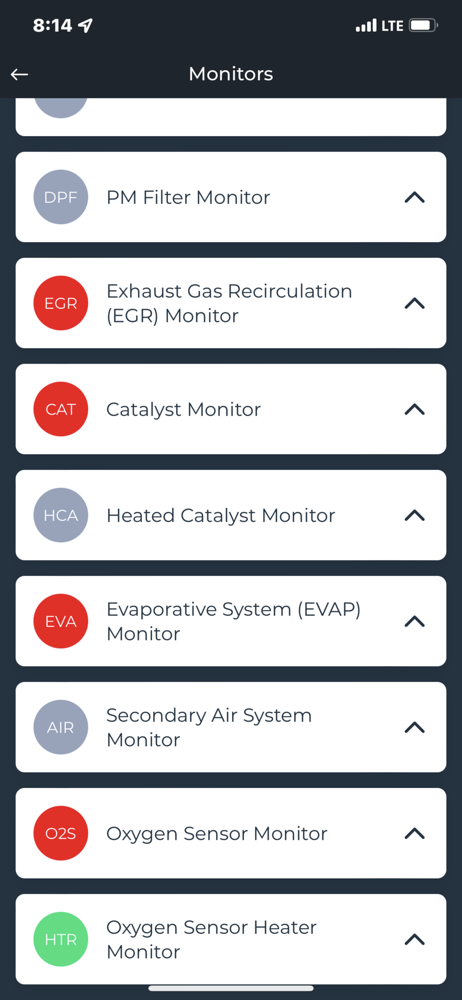

Old Mar 4, 2022 | 07:17 AM
2016_maxima_sr's Avatar
Joined: Mar 2022
Posts: 13
I’m running iOS
im running iOS and RepairSol2 with a 50 dollar scanner and have access to transmission codes and everything else actually really happy with the scanner for my screenshots I stopped mid-scan that’s why there’s so much red
Scannable systems pt 1
Scannable systems pt 2
My current trans code
Special functions feature
